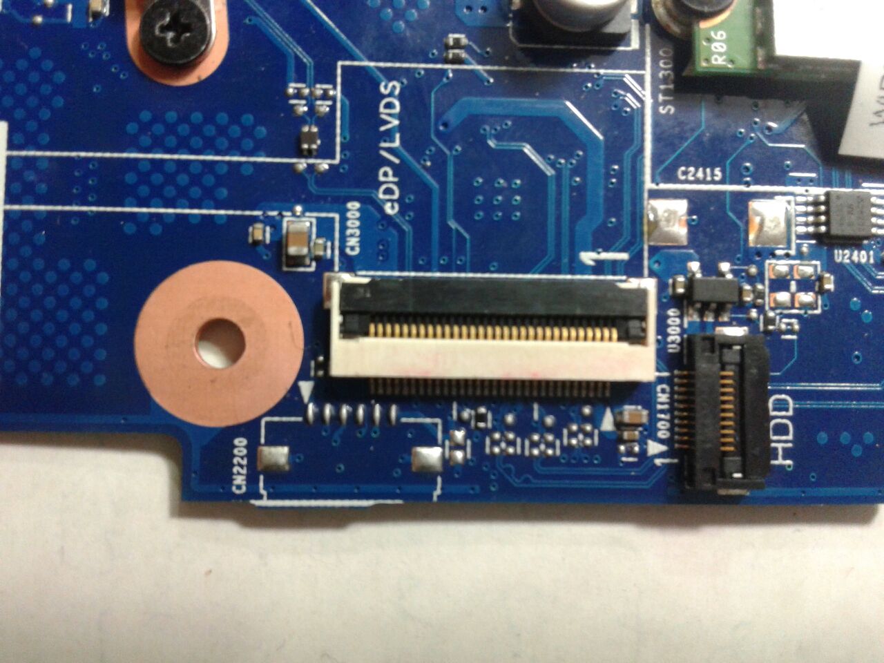

            Try to measure voltage at led connector when there is display and compare what is missing when display goes black. Sonce display is coming for only 20 seconds, you may need to measure 4-5 pins at one go.

                Trace that Pin5 in mb. Some thing is perhaps making the 3v to cut off. You can cut that pin5 cable in the lvds cable and inject 3v from lab psu on that pin and switch on the mb. Observe what happens. In no case 3v from lab psu should go into mb. Be careful. I repeat-You need to give 3v on the cutted pin5 cable of lvds cable so that it reaches screen only.
                  Re: hp 14 ac005nx no display
                  pin3 voltage is also suspicious-should be 3.3v
                    Most of the inventec mb have 19v on pin1 &2 and 3.3v On pin3/4/5. So i think you need to trace those pins first.

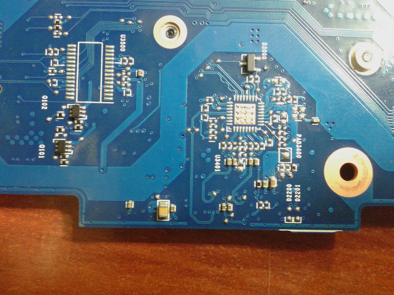

                                    Here is the picture of both side of mobo. Please help me to identify the coil.
                                      bro
                                      sorry for late
                                      see photo check the inductor
                                        In my case, inductor shows 0 Ohm that means it shorted and ok. Then what to do? Any idea?
                                        What was in your case?
