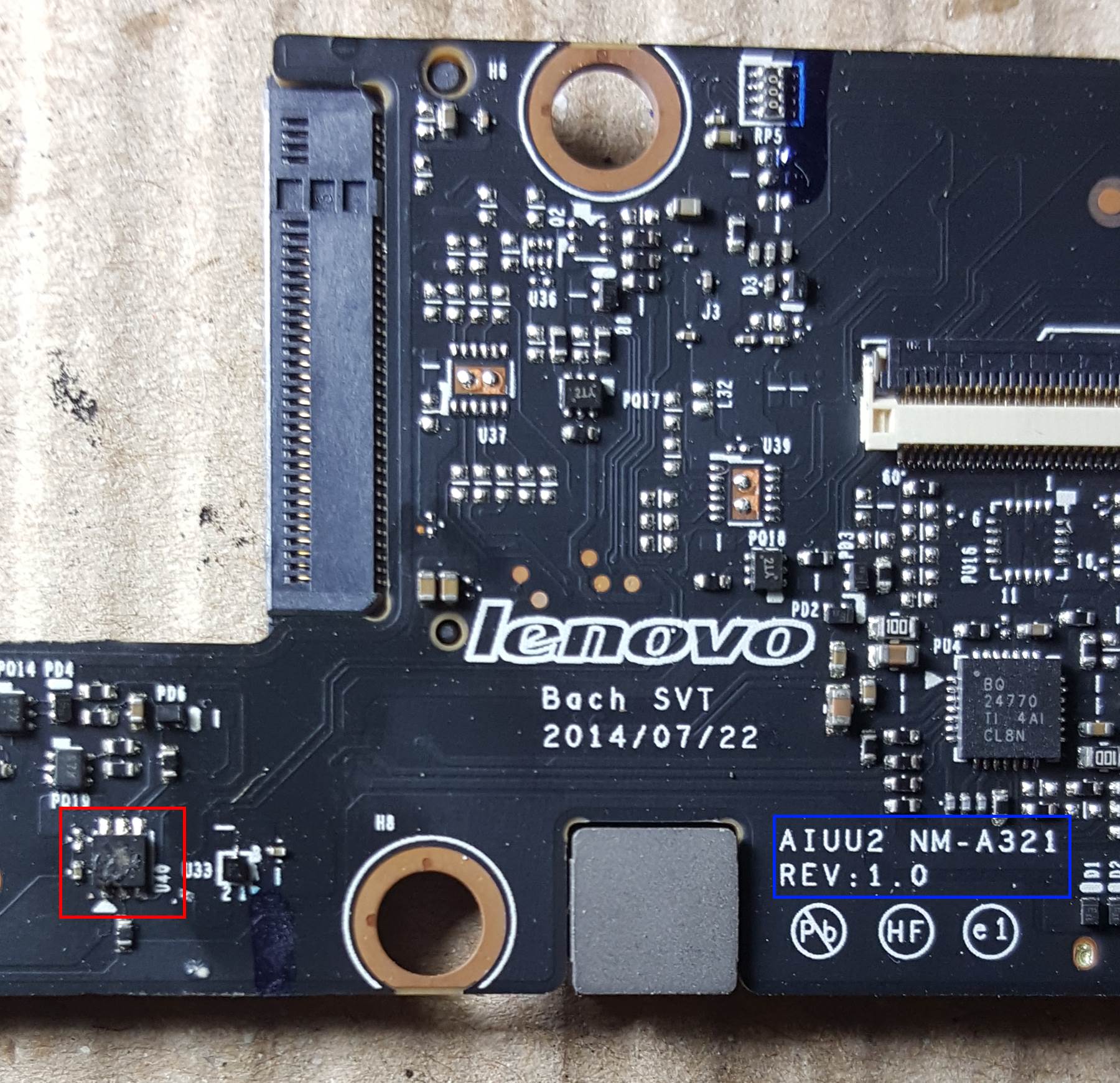

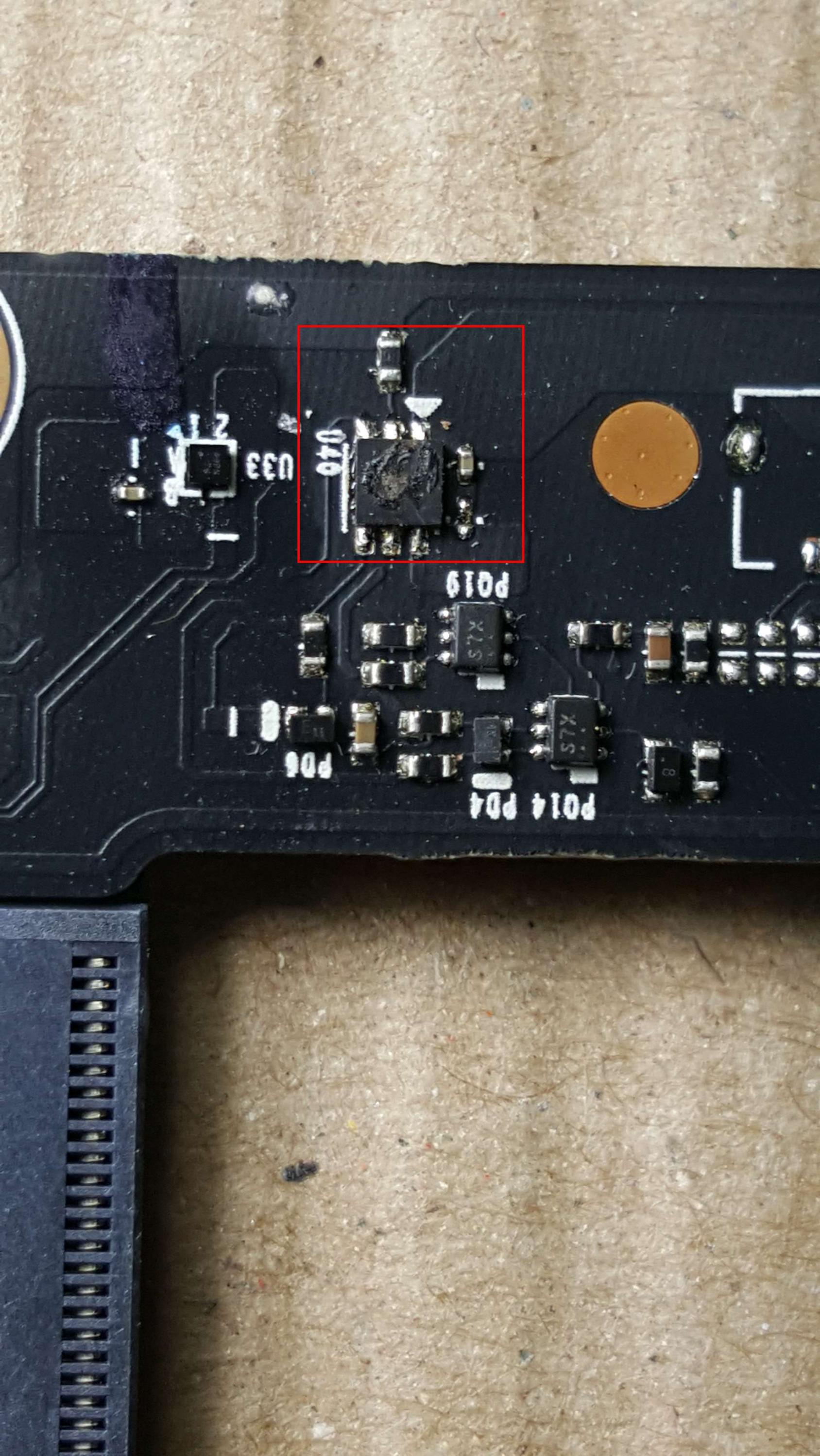

    after a short circuit , the npn mosfet has burned, after a replace now the voltage reaches the motherboard but I have identified another component that has sign of burns.
    I have the schematic but seem that the U40 is not the same.
    Someone can identify this component.
    thanks

    U40 looks like the same as in the schematics to me.

      Re: Lenovo Yoga unidentified component
      Are you sure ? , it's on Page 30/37 ..
      TPS2553DRV_SON6_2X2
        I think your confusion comes from this mosfet having 7 pins .. Notice that the seventh pin is a ground pad ..
          Ok (the gnd pad is under the component), i do not understand the function of this component.
            It's a part of the USB system , so if shorted , yes , it would prevent booting .
              Basically it's a switch that enables/disables USB power depending on the signal present on the EN pin. Additionnally, it provides protection against over-current situation on the USB port.
              Remove U40 and inject 5V on its output and check if the current is higher than it should be.
              If it's fine (less than 1.5A) then you can put a jumper from input to output for testing purpose only. You'll have to replace U40 in all cases.
                  I never fixed a motherboard of this type and If I understand well how it works:
                  for the moment I can not consider u40 because it does not receive + 5VDX_WALKPORT (right ?), coming from ISL95905
                  this is an IC Integrated Power Management (all in one, provides all the necessary voltages to major components, cpu, ram etc) and I think I should check if it works.

                    It would be difficult but not impossible , to determine the IC status . Try first to identify the health of the IC other's voltages . If things are constant and true , then the IC is fine and working .
                    In such case , you could follow the tps255XX surrounding components ..
                      No voltages out from PU3, it is powered by 8.4V .
                      Charge chip is ok, ITE is not powered but I have difficult to detect the +3v source without boardview.
                        Why dont you remove U40 from mobo and see what happens?? Its not going to harm as its only usb power,usb port will not work. Sometimes a burnt IC may prevent other voltage rails. Just think about it.
                          It's logical to assume jasko_jacker; has removed U40 by now. No reason to leave a burnt component anyway .
                          If ISL95905HIZ-T is acting strange , better replace it , it's available from manufacturer Intersil Corporation .
                                This is the USB power supply chip. Can be removed directly. Then the sub 1, 6 feet
