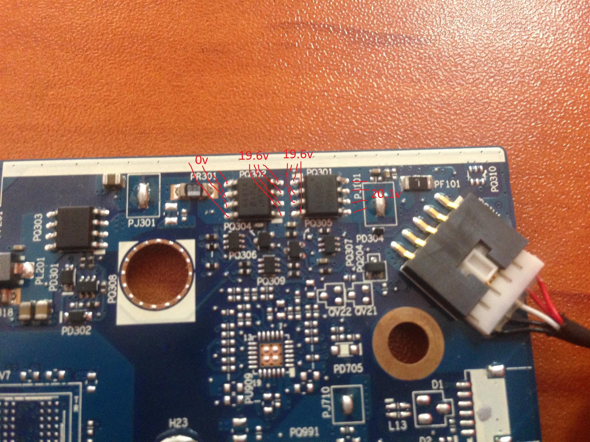

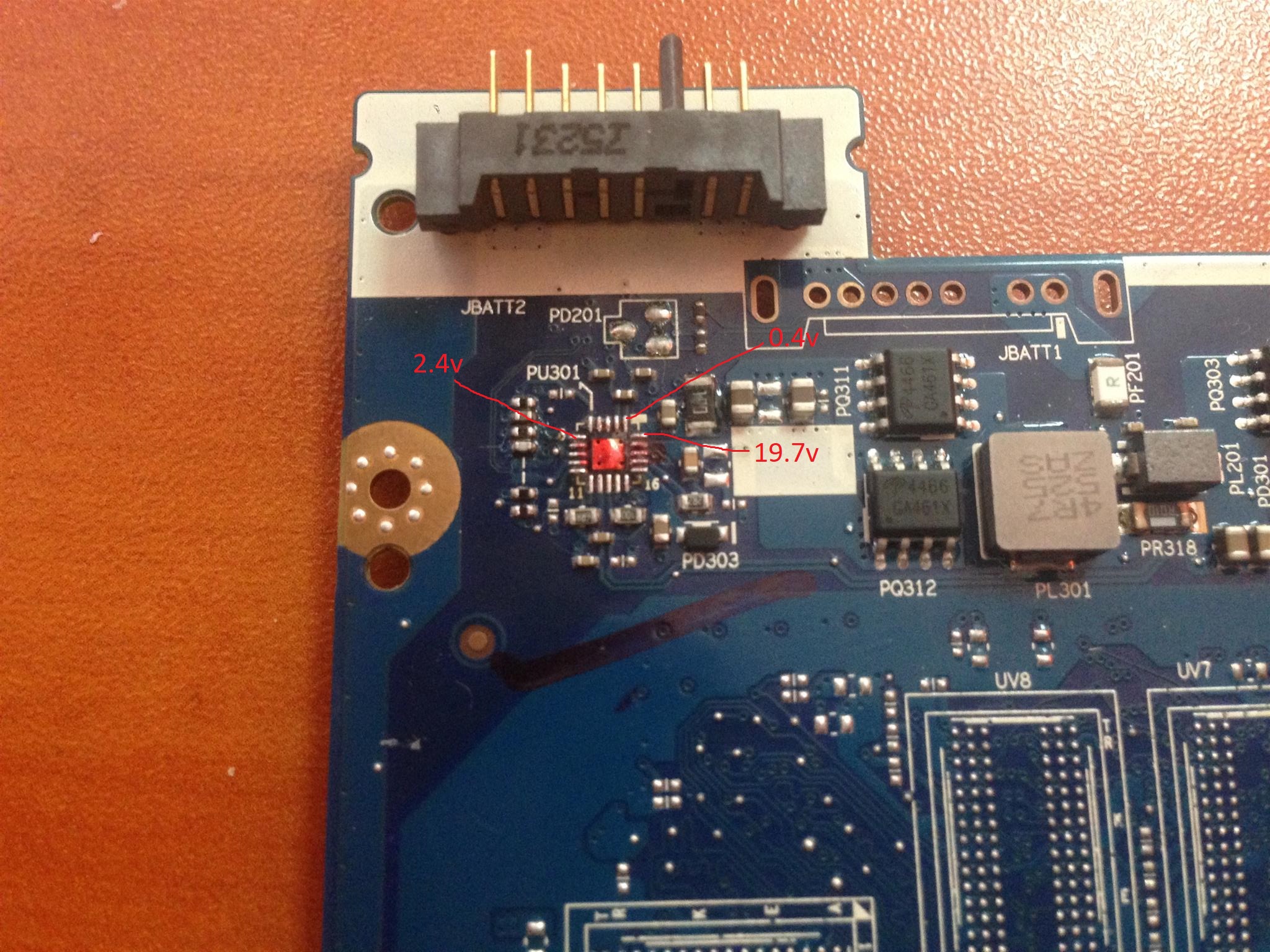

    hello , i`m working on lenovo g50-30 motherboard : ACLU9/ACLU0 NM-A311 Rev: 1.0 . I was following the suggests on this post https://www.badcaps.net/forum/showth...ghlight=g50-30
    . So far what i`ve done is to check PQ301 ,PQ302 and PU301 is where i end up.Except the pins i`ve market with RED on the picture, rest of the pins i get 0v. You can see my results from the attached pictures,schematic also attached, so my question is what should i do now ? thank you in advance

    Re: Lenovo G50-30 dead, no lights at all
    Replace charger IC PU301 and measure voltage on all its pins again.
      hi and thanks for your help. Dont need to replace anything, i just found if there is a short on the cmos battery means the CPU is burned and on this motherboard CPU is everything. I`m just sharing that to save the work for the next one who will deal with this model.
        Also for me PQ302 mofset was broken after some measurements I took and stopped the current to flow through. Replaced it and now I got a proper opening laptop!
