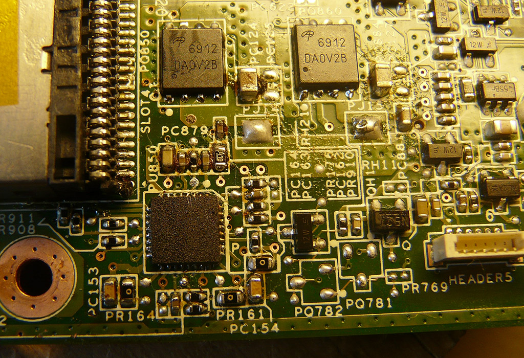

    Someone left me a G62-a13ED laptop to repair.
    Symptoms: Wont turn on.
    Some corrosion around PU850 (SN0608098RHBT)
    +V3.3AL OK
    +V5A is 0 volt.
    I've replaced PQ850 and PU850, no change.
    There is no short to ground on the +5VA rail.
    Measurements I've taken:
    PU850 pins:
    Pin 26 (DRVH2 +V3.3AL_UG_20) = 3.5V
    Pin 25 (LL2 +3_3V_AL_PHASE_20) = 3.3V
    Pin 24 (VBST2 +3_3V_AL_VBST_20) = 8.4V
    Pin 23 (DRVL2 +V3.3AL_LG_20) = 0.9V
    Pin 15 (DRVH1 DHI) = 0V
    Pin 16 (LL1 +V5A_PHASE_20) = 0V
    Pin 17 (VBST1 +5VA_VBST_20) = 4.8V
    Pin 18 (DRVL1 +V5A_LG_20) = 0V
    I've tried giving 5V to the +V5A rail through my lab supply, this doesn't heat anything up. The rail itself seems fine, and I'm not sure how to proceed. Any ideas would be welcome!

    Can you give voltage on EC_ALW_EN line? And voltage on +V5AL?
    Can you upload a picture of corroded area?
    Are you on AC power without battery? Nothing after pressing power button?

      EC_ALW_EN is 0V
      AC power with no battery attached, and indeed no reaction after pressing the power button.
      Image of the area is attached.
