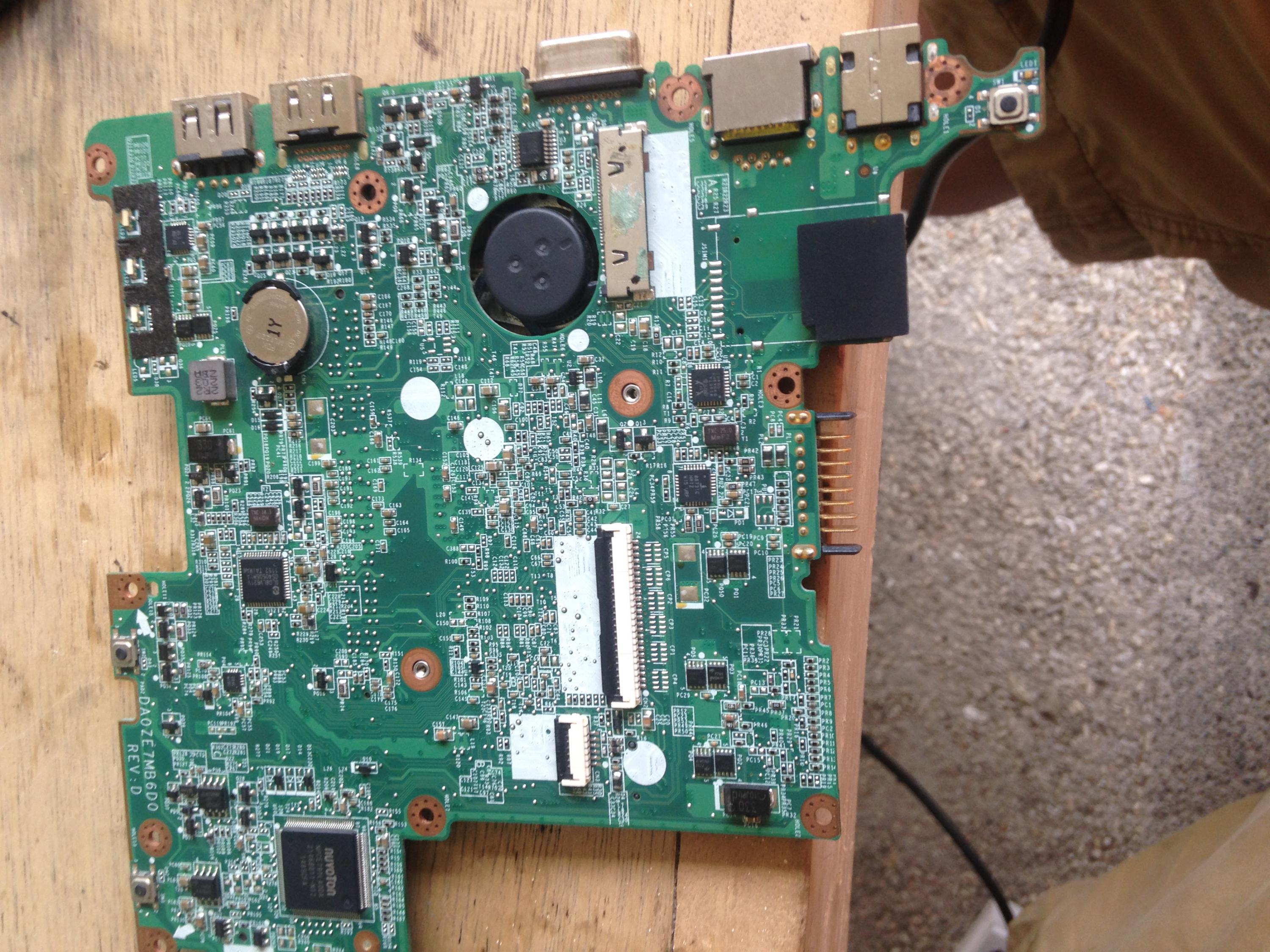

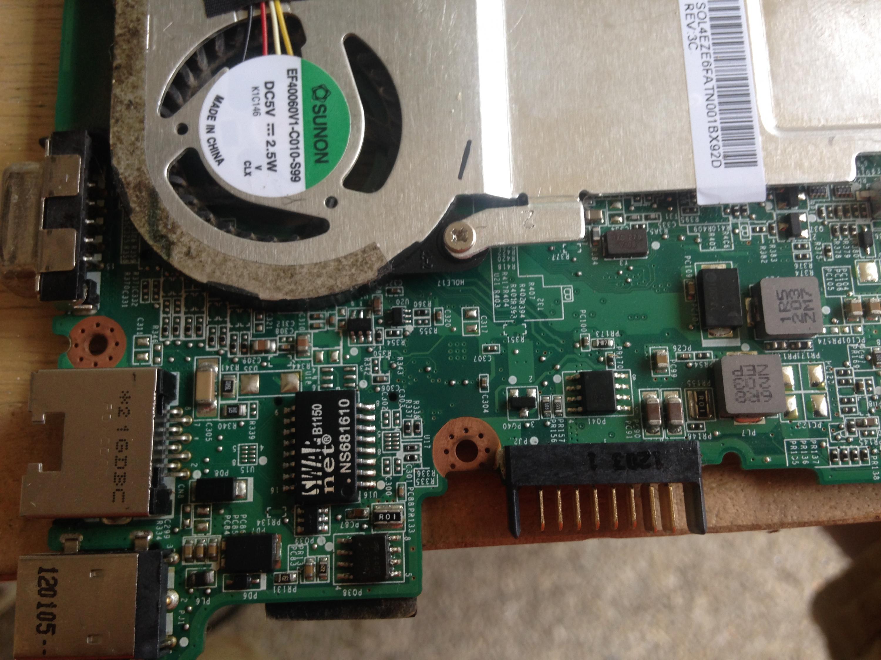

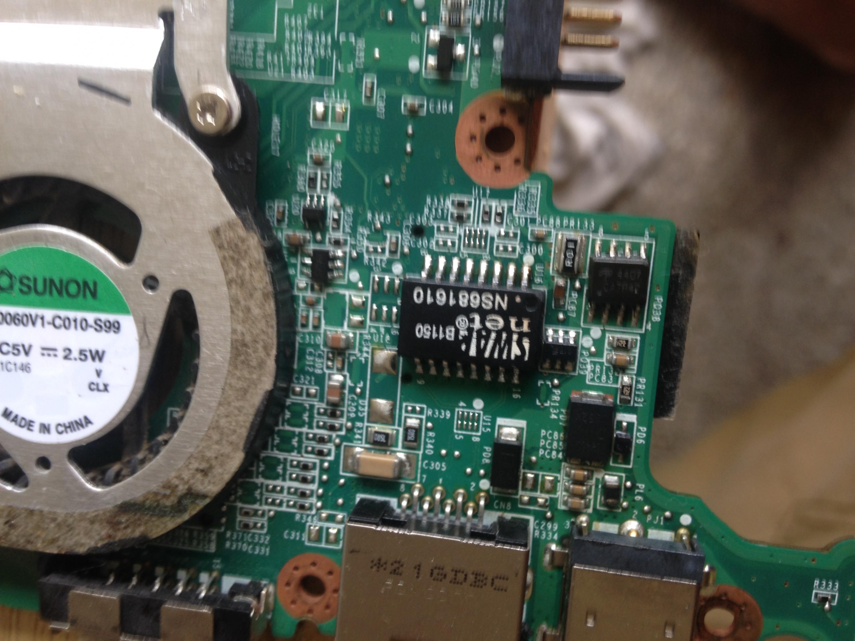

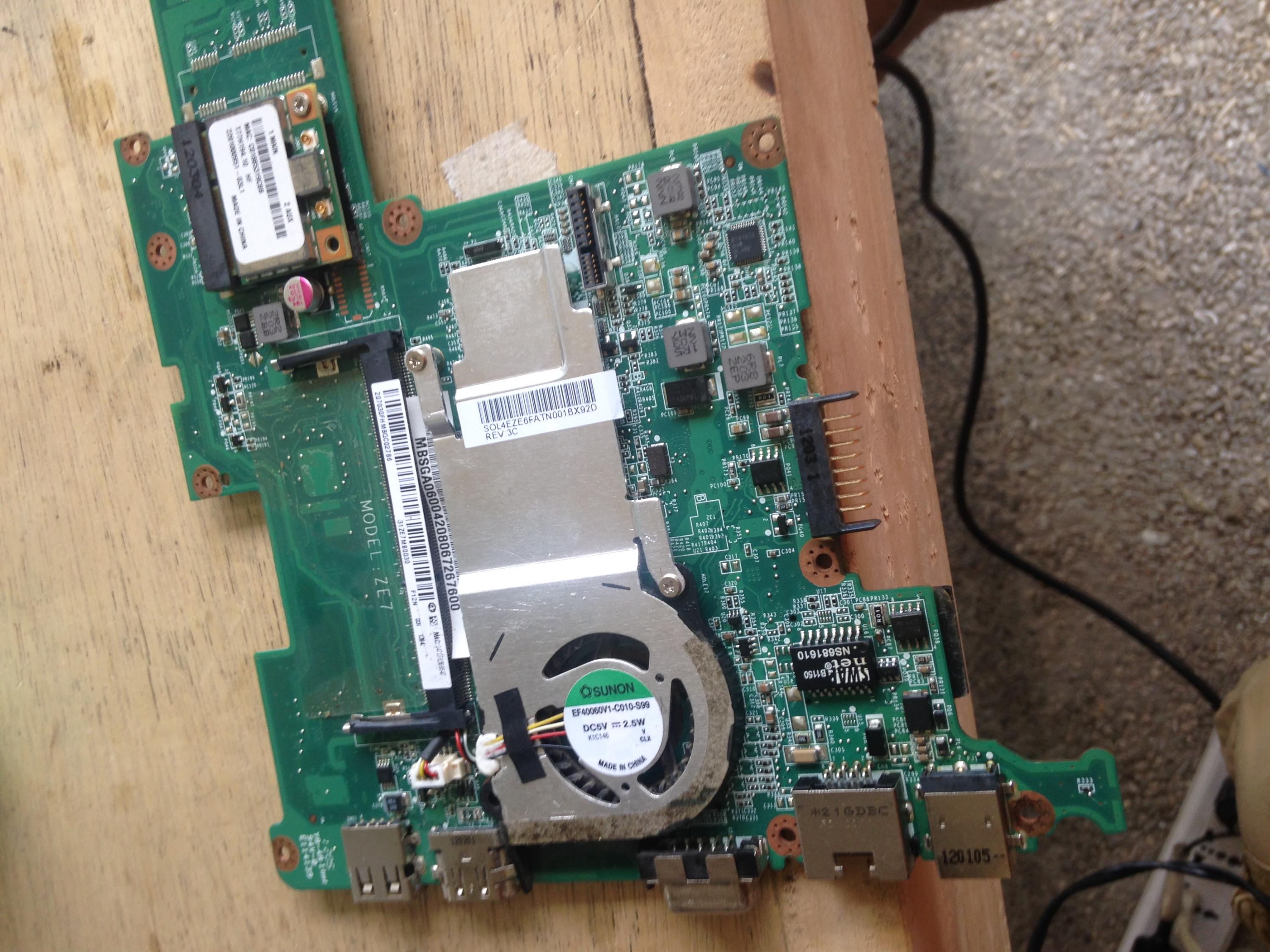

                        • raajkumar
                          • Mar 2015
                          • 354
                          • Srilanka
                          Re: acer one d270 dead
                          you check the capacitors on 19V line. do you have the schematic for this motherboard ?. upload a clear image of your motherboard both sides.
                          • Romulo
                            • Nov 2016
                            • 484
                            • Philippines
                            Attached is the image of the board

                                    update:remove pr133,pc87,pc88 now there is 19v on pq38 and its not getting hot but when i change pr133 and put it back still got the same issue pq38 getting hot.anyone please help on this
                                    • raajkumar
                                      • Mar 2015
                                      • 354
                                      • Srilanka
                                      ok. you got the point. you just remove pr133. and check for short on both pads. you have to inject power from 1v to that pad which one showing short. when you injecting power you can find which part is getting hot.
                                      • Romulo
                                        • Nov 2016
                                        • 484
                                        • Philippines
                                        thanks for the response raajkumar i already done inject 1v on shorted side of pr133 now pl7 and pl8 getting hot should the two the culprit?
