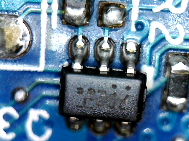

      Re: VAR00 LA-9201P short to ground
      this is the chip that gets hot...
