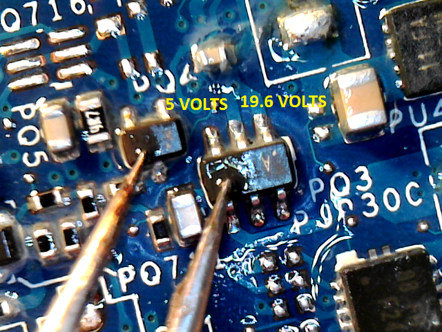

    took voltage reading at the location shown in the attachment and get 19v...

      B+_BIAS is pin1 of PQ3 and also pin1 of PC11.
      it is different from B+. I think you measured B+.

        These are the measurements I took from pq3 and pq4? These are the voltages prior to pressing the power... After pushing the power button the 5 volts drops to 0.00 and the 19.6 volts drops to 0.5....

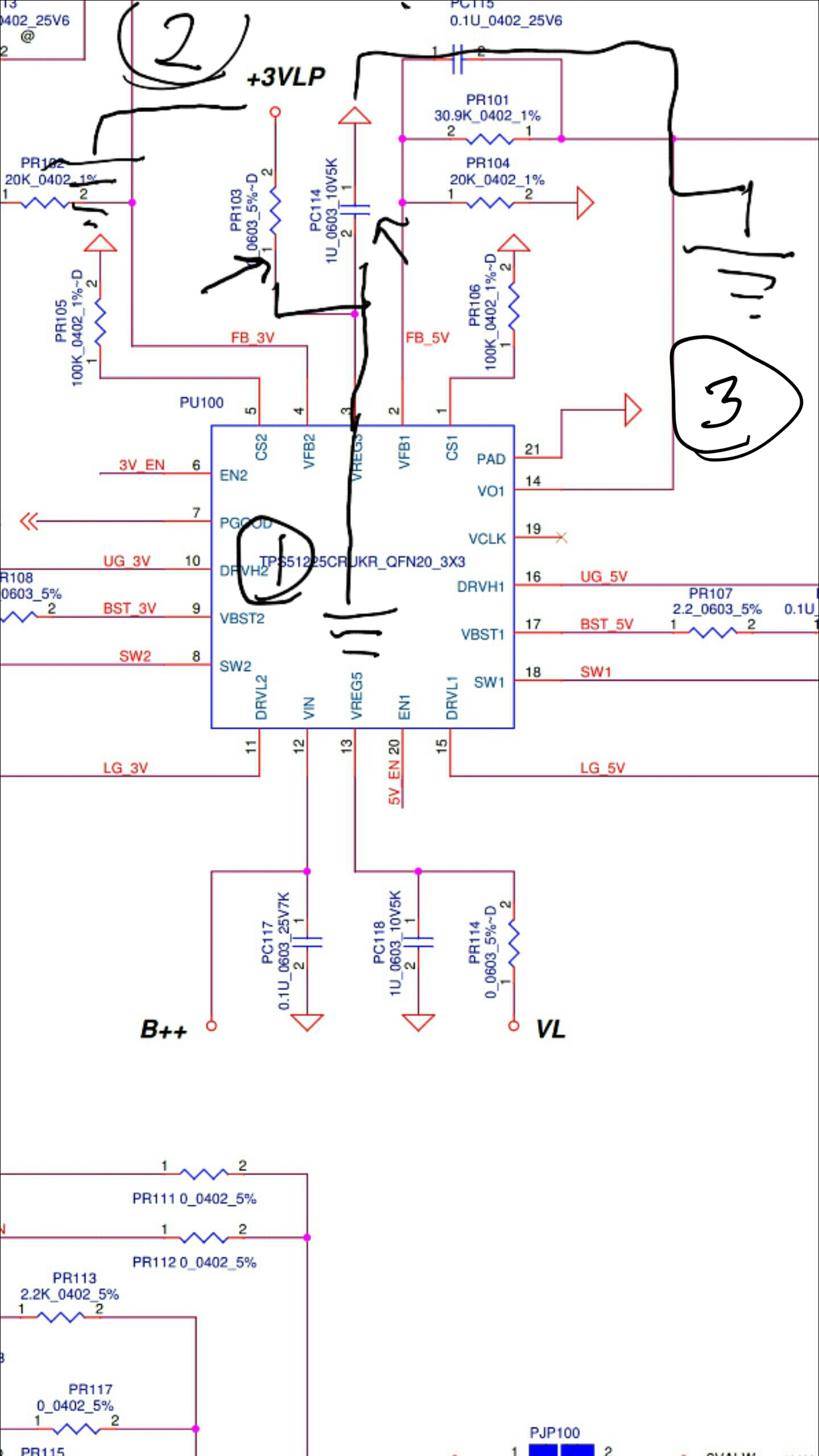

                now open page45 of the schematics and measure the following points after turning on:
                PCH_PWR_EN , PCH_PWR_EN# , SUSP, SUSP# , SYSON , SYSON#

                  okay i get
                  0volts PCH_PWR_EN before power and 0volts after power is pressed
                  0volts PCH_PWR_EN# before power and .3volts after power is pressed and it drops immediatly to 0.00 this was at qz15 on page 45,, pin 3 gets 5valw...
                  SUSP = 0 volts
                  SUSP# = 0 volts
                  SYSON = 0
                  SYSON# = 0
