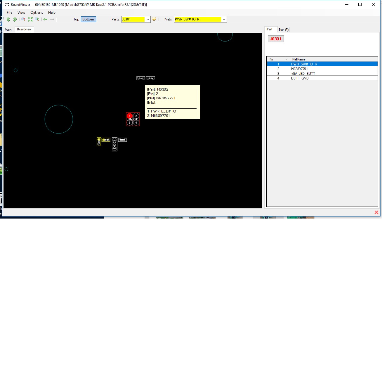

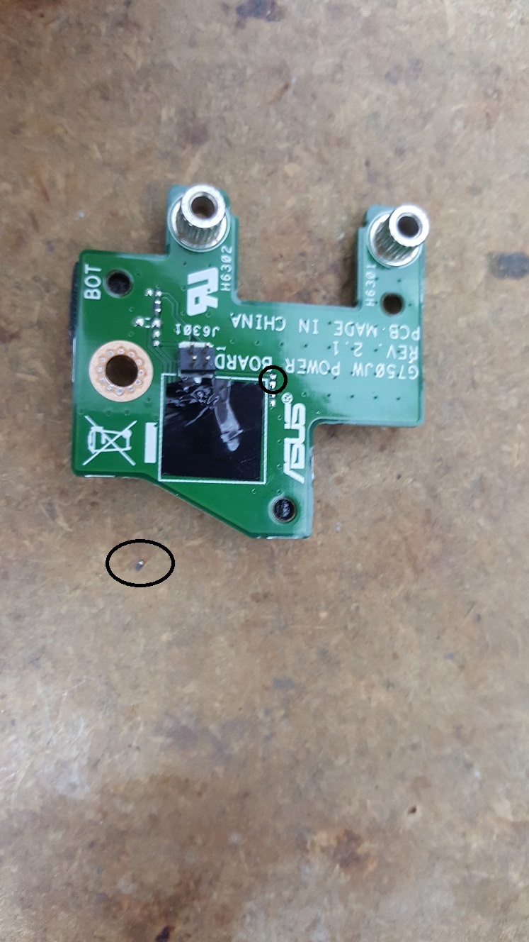

    The part J6301 (the power board) shows in Board Viewer but there are no values for any components attached to the board. There was black scorches around the SMD, I tried to resolder it but the whole side was burned off.
    Whats a value that should work?
    ASUS ROG
    60NB0180-MB4020(211)
    G750JHA
    Found board viewer schematic @
    https://www.badcaps.net/forum/showth...ghlight=G750JW

    Re: Component ID/value
    Assuming you've resolved whatever issue caused it to burn up in the first place (I hope)...
    That is just the current-limiting resistor for the LED. It's being powered by 5V. You can use Ohm's Law to figure out an acceptable current.
    5V / current = resistance
    5 mA = 1k ohm
    10 mA = 500 ohm
    Etc..
    Somewhere in that range should be fine for most LEDs. I wouldn't go to a higher current (lower resistance) unless it is obviously too dim.
      A 560 seems to work fine
