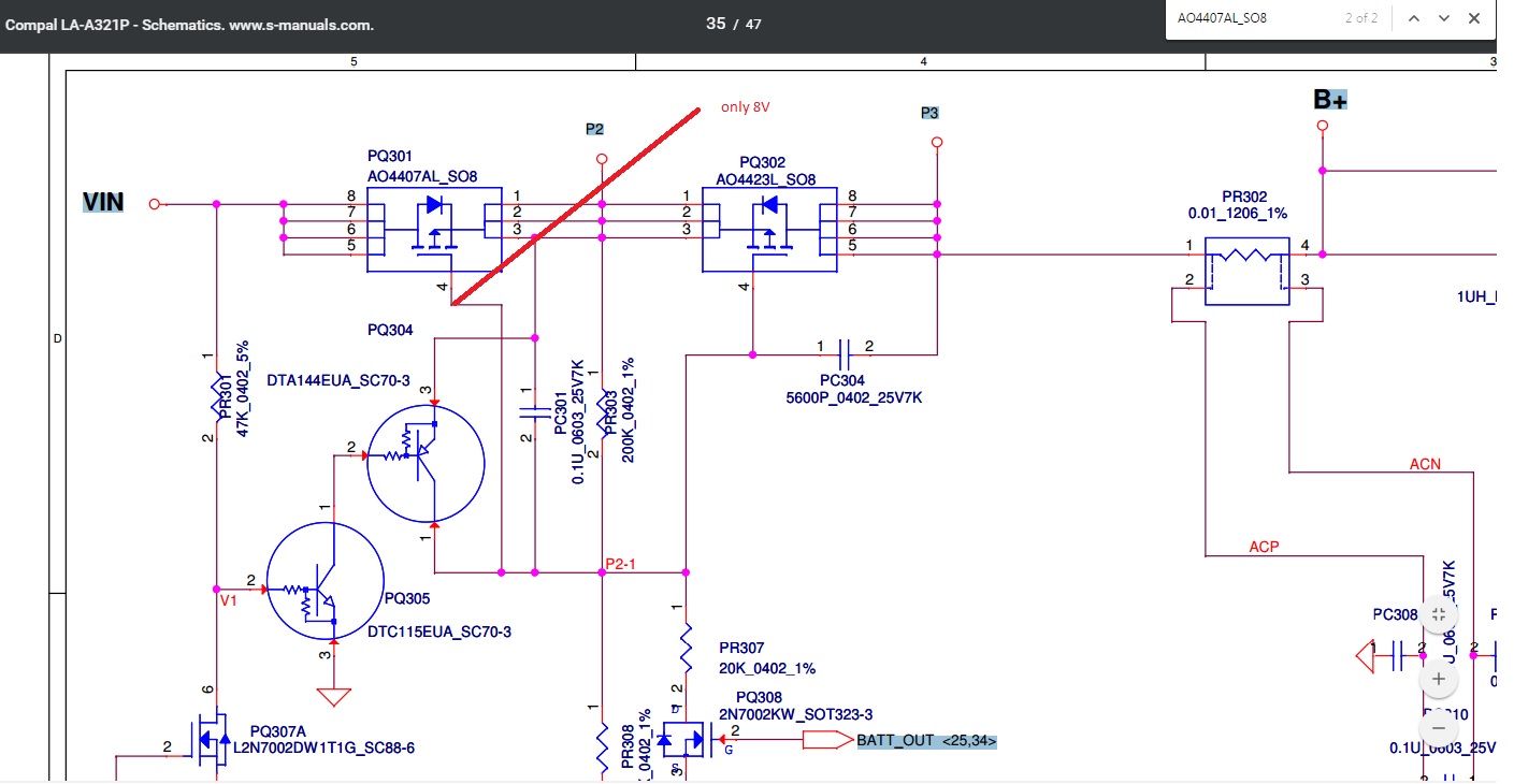

    hello i need help
    i have a lenovo m30-70 after i power on, the led turn on , black screen and after 5-7 seconds is turning off.
    i measured the mossfet PQ301 and on the gate i have only 8v . i atached a printscreen with the schematic.
    thank you

      Re: lenovo m30-70 power off after 5 seconds
      Originally posted by casti3l
      hello i need help
      thank you
      The voltage on the Gate is correct 8V PQ301 P channel fet
        First do some basic stuff remove BIOS battery & the Battery hold the power key ect
          if it start that that circuit is fine.
          u must find coils with no voltage at start
