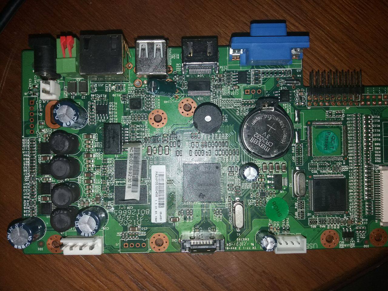

    I have 20dvrs with no video no sound, they turn on power light on and cooler working.
    Im searching for problem about 3months and i thing is bios/firmware problem, but they have different chip bios with to much legs.
    can i programm firmware/bios with usb or any programmer via usb, vga, hdmi or any method
    i need your help
    thanks anyway

    Some details like make/model and photos might help.
    The DVRs I had to repair when I worked at a CCTV place were mainly dead due to poor quality power supplies that had burnt up components on the board.

      all are dahua cctv 2011 2012 2013 model

        have you tried removing the battery for a while and testing it whilst out ?
        maybe try a different power supply

          i try but no working

            I can't read any of the markings on the ICs, what's on the BIOS chip ?

              mx25l12845emi

                  Have you tried pulling off the BIOS chip and using a reader ?
                  A CH341A will read those chips.
