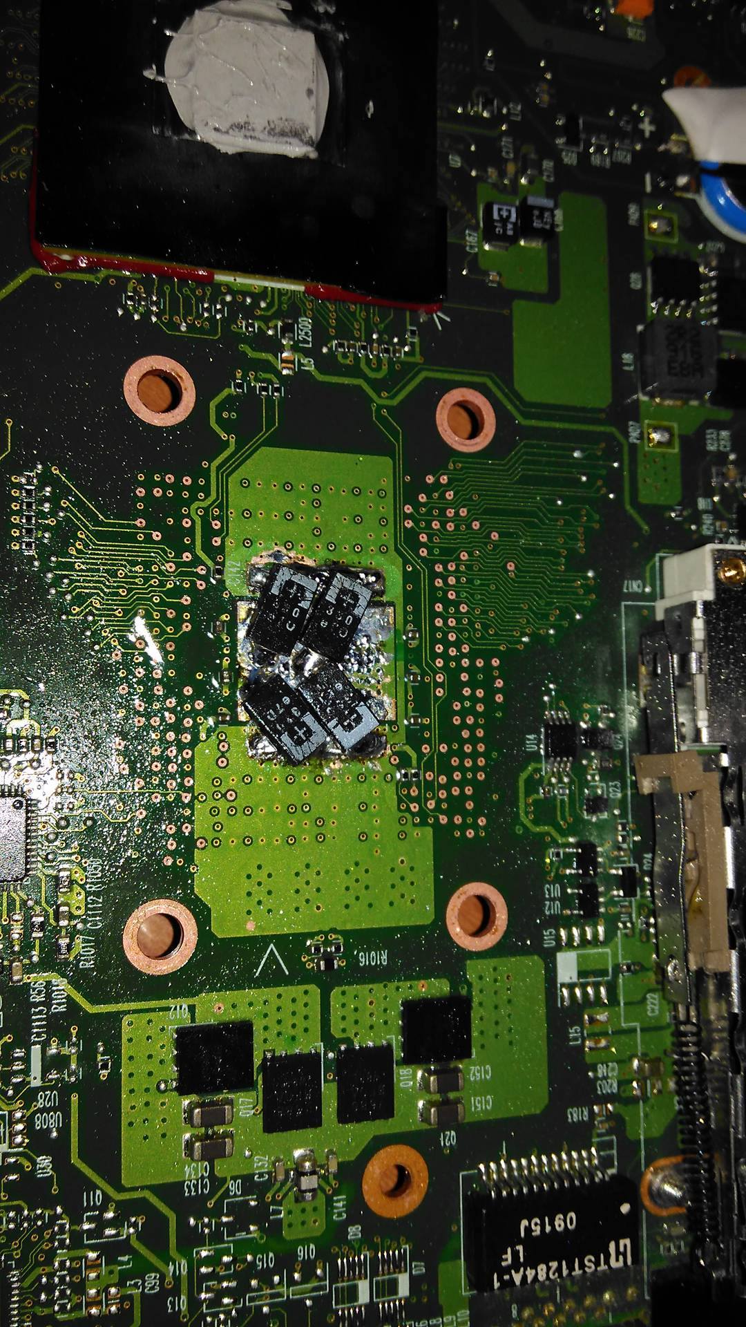

    Greetings guys,
    I got two toshiba A300 that were somewhat dead..
    Changed both of their nec/tokin cap for 330 tantalum and they are working.

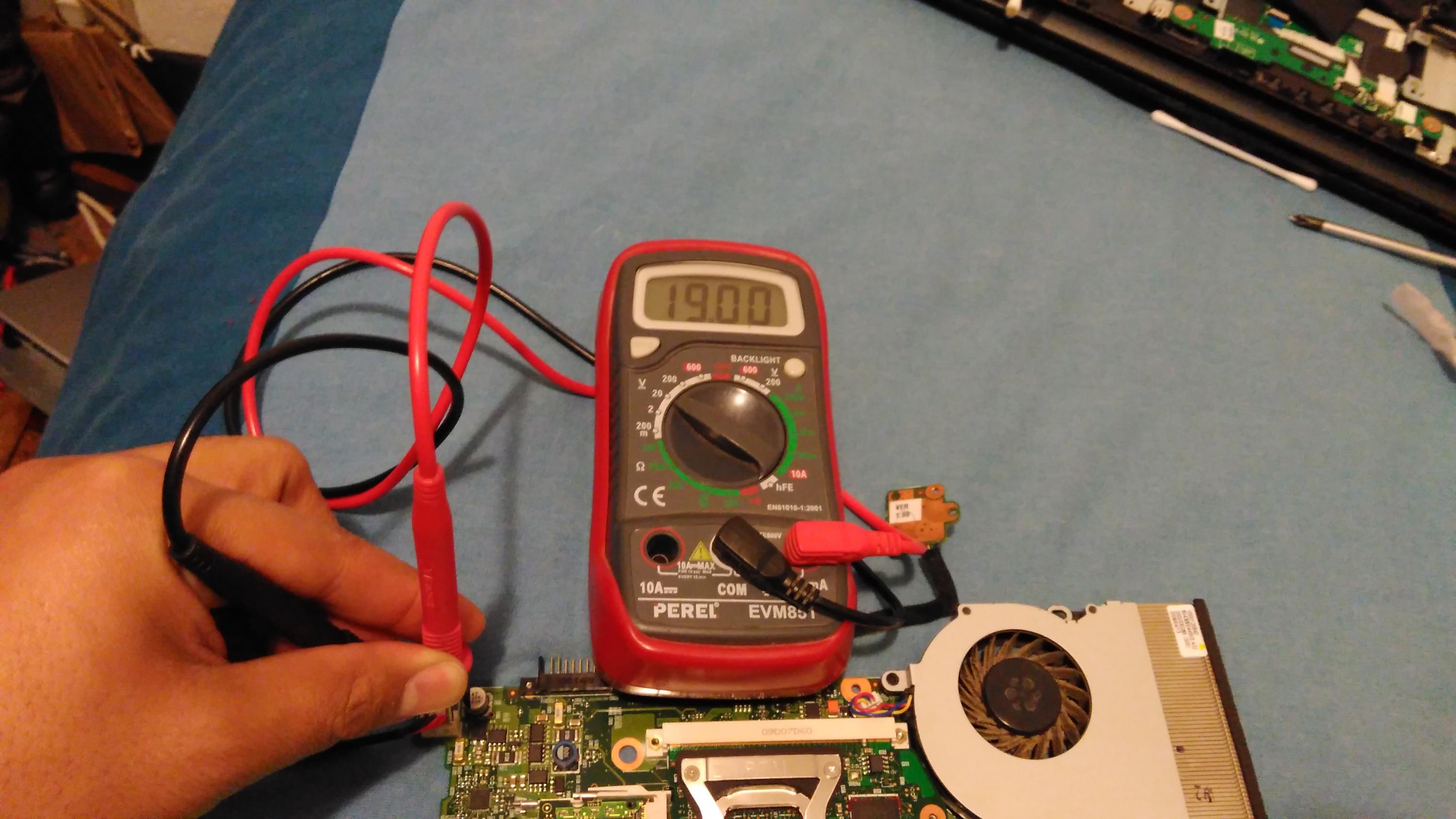

    Altho, I would like to ask if some one has the boardview file of their board or if some one knows where can I buy it.
    What they are doing from time to time, and I suspect is a charger fault, they turn the green light on. I press the button to turn the laptop on and it dies. The fan flickers and loses power.
    I measured on the charger pins (the four pins, 2 red and 2 black) after the barrel plug and before turning it on I get a steady 19v on them. When I press the button, the voltage drops to around 11.5v and then raises back up when the mobo dies (I can listen some click when it cuts the source).
    Am trying to understand for sure where the problem lies so I can tell the owner, if it needs more things or just the power brick.
    Already redid the tantalum solders.
    The board is a PT10G_6050A2171501_MB_A03. I fould some schematics for it but can't seem to find the boardview nor be sure they are the ones for my model since I don't know where to find the things..
    Would appreciate your help even if only with suggestions.

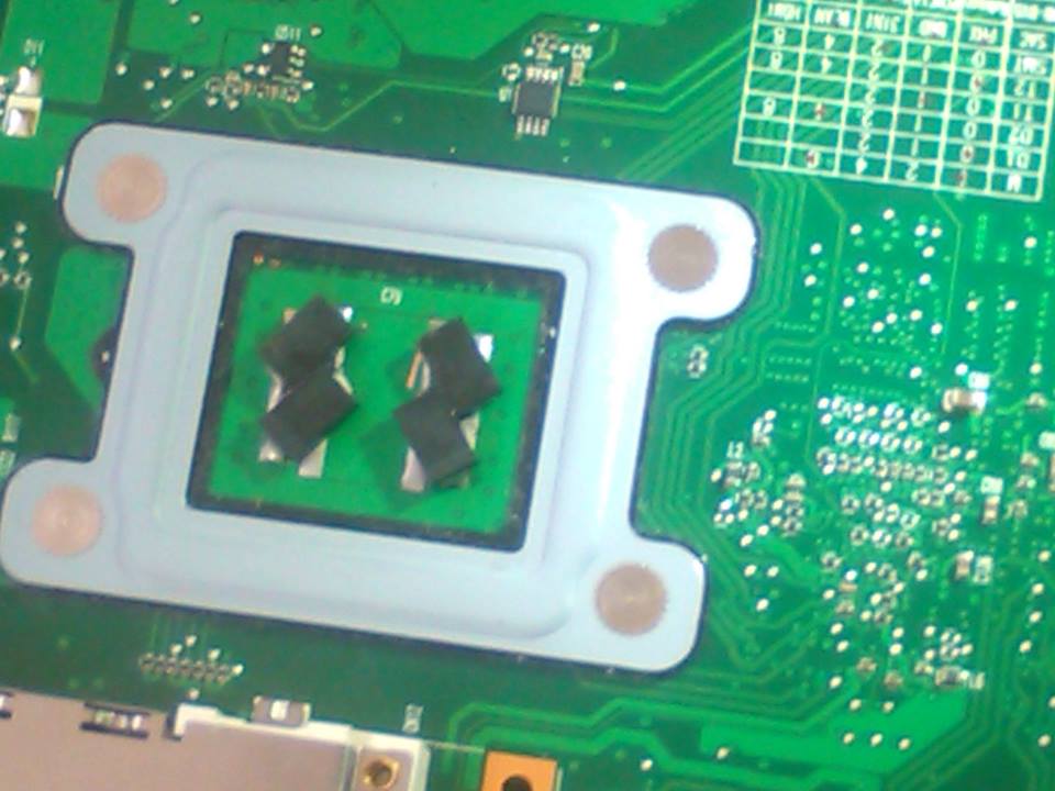

    I think this 330uf is not enough, because you have to install 4 caps but your photo say you just soldered only 3. add more caps and clean the motherboard soldered place. This problem is only with capacitors.

      Just put 4 to 5 tantalum caps

        Carissimo , mete 4x 330uF e fica Ok !
        Cumprimentos
        I was saying to this guy in our language to install 4x 330uf tantalum caps

          Thank you all for your suggestions.
          Will do so!
          I have read in other forums that 3 were enough and, to be honest, that's all I had laying around. Have to get another dead laptop donor board for those haha.

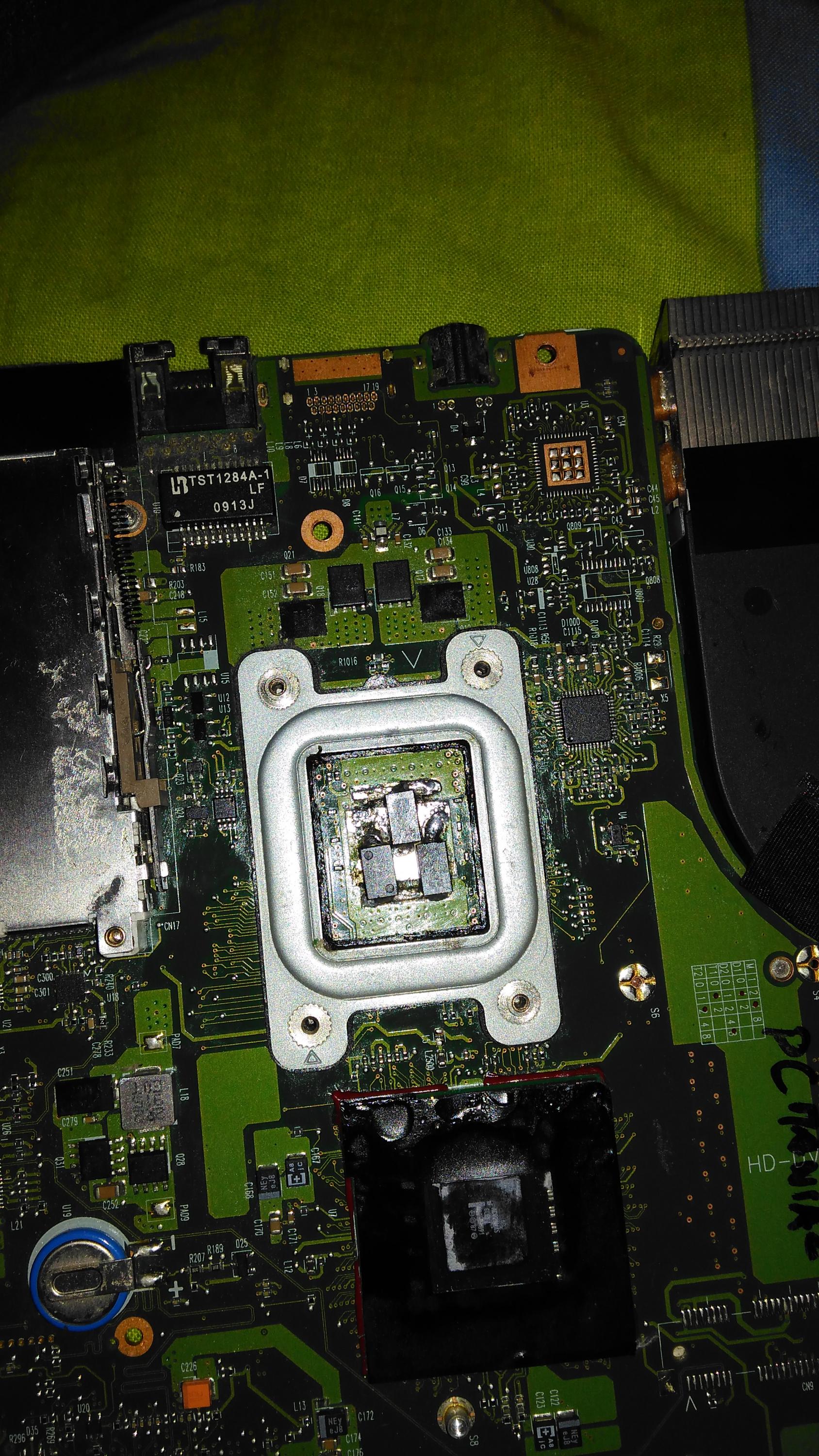

            Re: Toshiba A300 - Tokin cap exchanged.
            Greetings,
            I have added the fourth cap and, still the same.. :\
            any other suggestions?

              This is what I do... and works fine.
