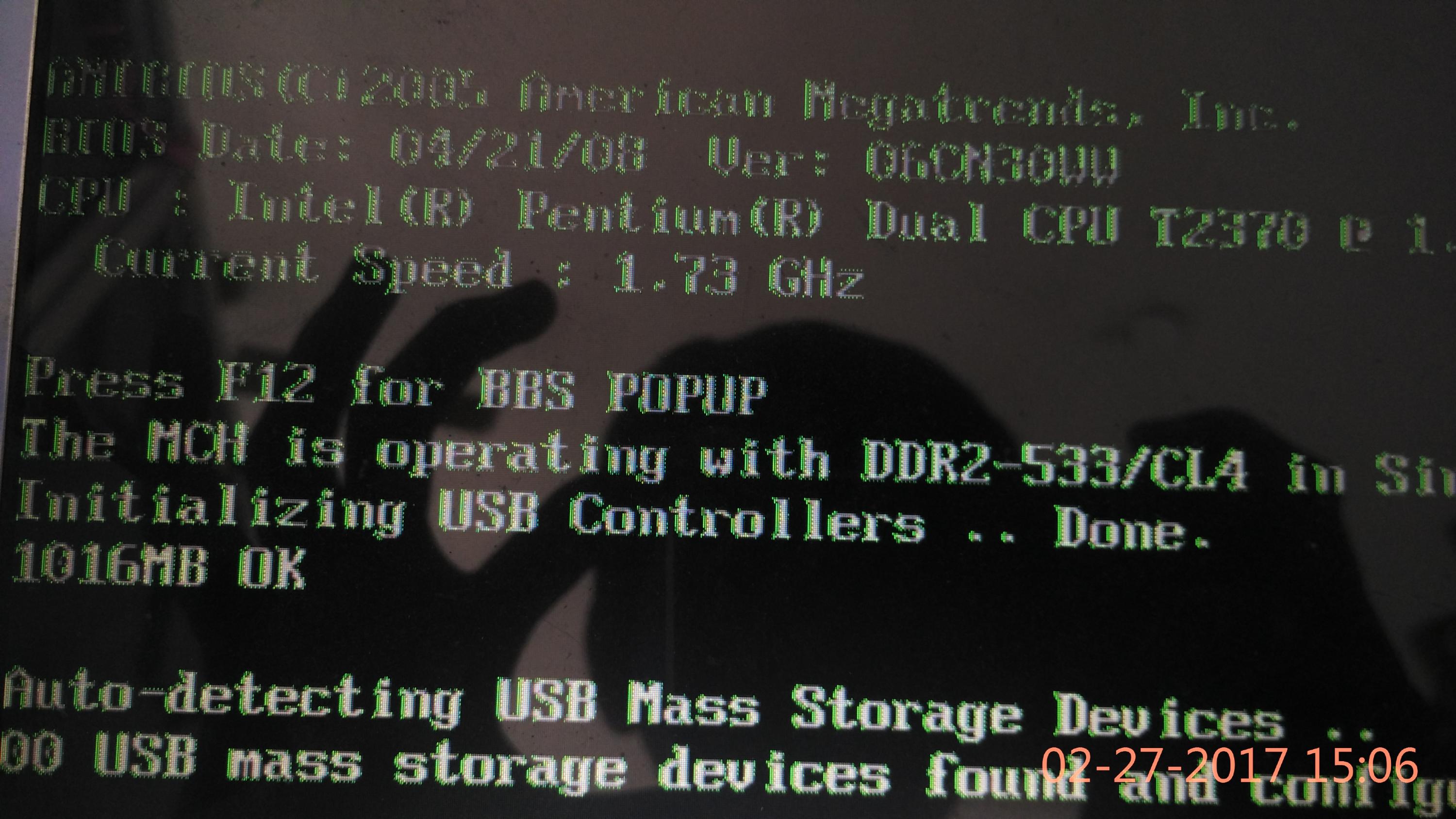

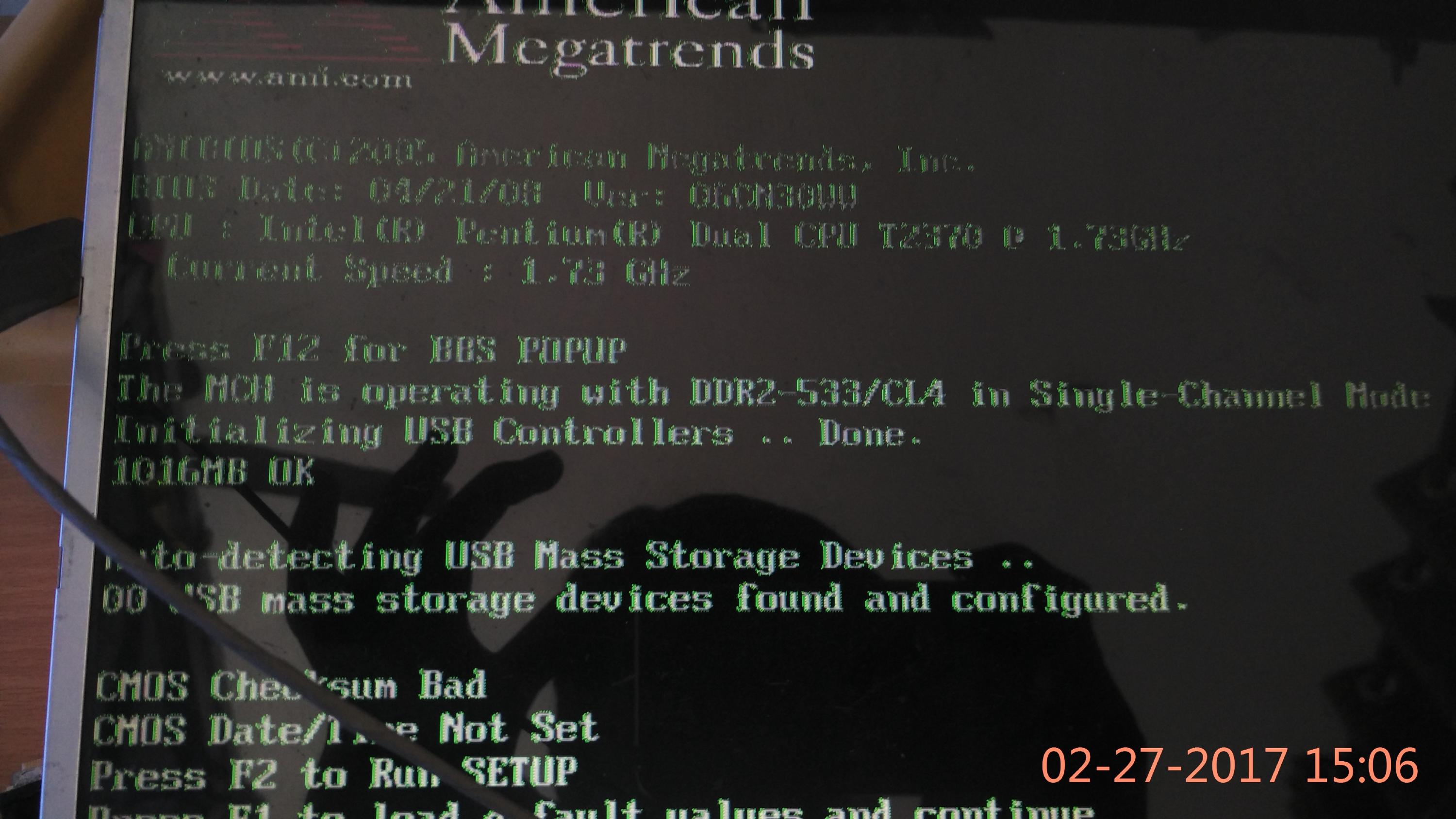

    hi..i have lenovo y510 without graphics has a colour problem.need solution for this problem.green shade letters.
    i have replaced display cable and processor not resolved..i think board only problem.pls give me ideas how to solve.
  • jasko_jacker
    • Oct 2014
    • 1140
    • italy
    Re: lenovo y510 colour problem
    Probably Gmch (northbridge with graphics inside) must be resolder or replaced
    • powerontech
      • Dec 2016
      • 21
      • INDIA
      Thank u sir for ur reply..actually there is a minor water damage on the fuse near lvds connector.Today only i have seen.i have raplaced the fuse now working well..
      thank u once again.
