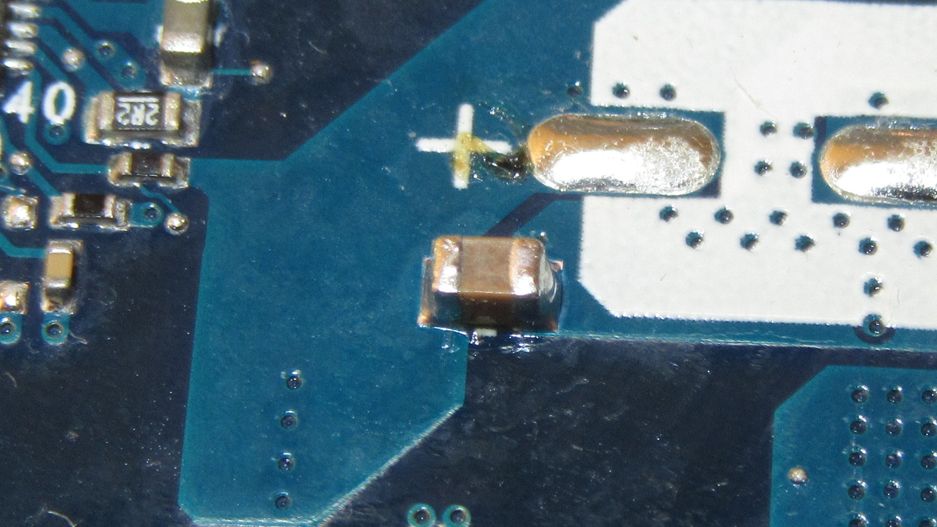

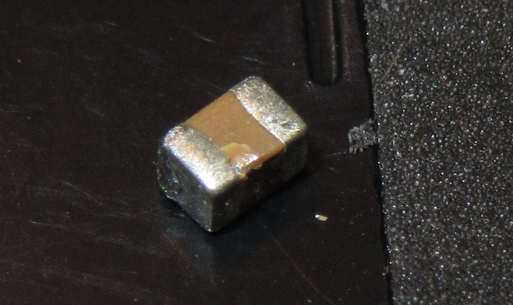

                        There is definitely low voltages in places to what there should be with highest only of 18v. I need to find out why I am not getting the 20+ volts especially at PDSL which is showing 0v. Also Acok is 5.29v and should be 0v
                        • inflex
                          • Aug 2012
                          • 545
                          Re: Toshiba satelite c650 not working
                          You might want to be checking / looking for a short. In particular look at the 0805 ceramic caps around the switch mode regulators. Look at the surface of the caps very carefully and don't be surprised if you see some cracks on one.
                          Put your multimeter in to diode mode and start checking the values, should be 0.3V or higher usually, if you get anything like 0.01 then you've got a short most likely.
                          It's a fairly easy way to spend half an hour under the magnifying glass in good light, but it often reveals faults without having to do much else.
