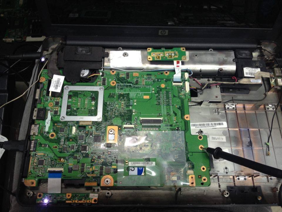

    hello again guys.
    i got another problem. with this hp g60 model
    it turns on and when it goes windows login in it suddenly turn off and goes back on. and again and again.
    but when you enter in bios menu and stay there its fine.
    im thinking of cpu supply is not enough like for toshiba issue (nektokin)
    but im not really sure bcoz it has no nectokin ic.
    when i seeing the mother board under cpu i found 3caps and one empty pad.
    i was wandering putting another 330uf caps on it.
    any idea guys... thanks

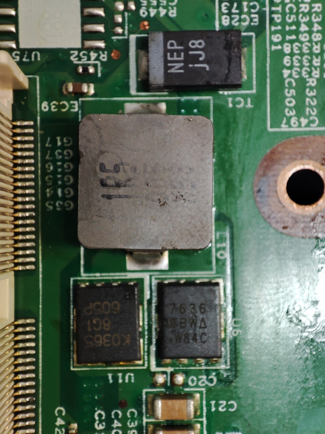

      • atacmd
        • Sep 2021
        • Russia
        The problem is solved by replacing TC1, L10, U6 and U11
