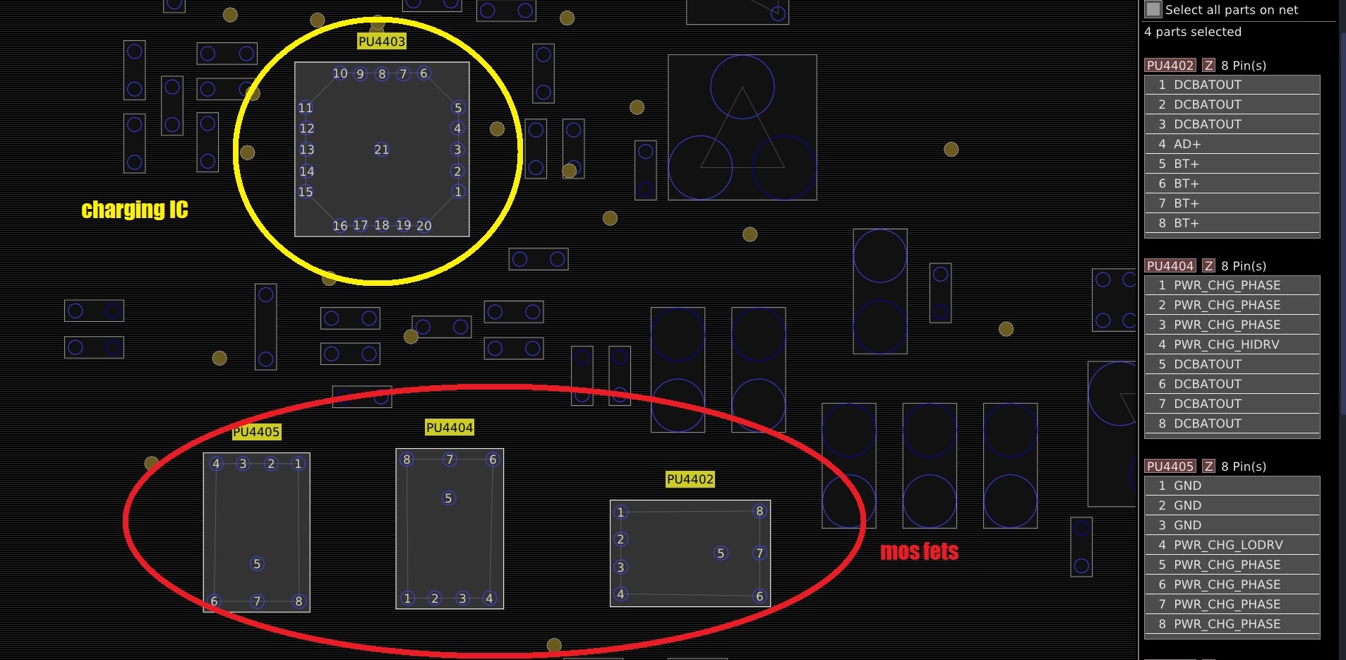

        Re: Acer ES1-511 (E15 series) not charging
        when you change charging IC did it work for you?
        heres pic of mosfets and IC from boardview file, what shall i check for.
        thanks
        • ldoctoru
          • Jul 2018
          • 9
          • romania
          check mosfets and if they are good change IC(check output IC on pin 5).
          In my case after i change IC, charging works
          what IC do you have on board?
          • CeeEee4
            • 43
            • EU
            can i check mosfets on board, or do i have to remove them and test?
            Charging IC is BQ737..
            i have 0V on pin 5 - (ACIN) when charger is plugged in. what voltage should be there?
            thanks for your help
