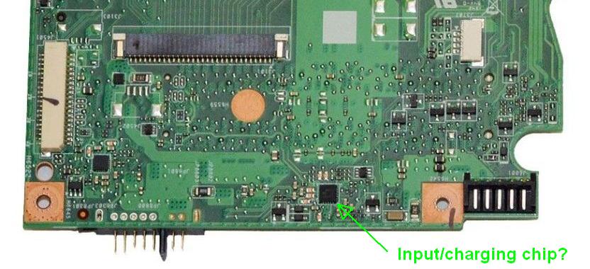

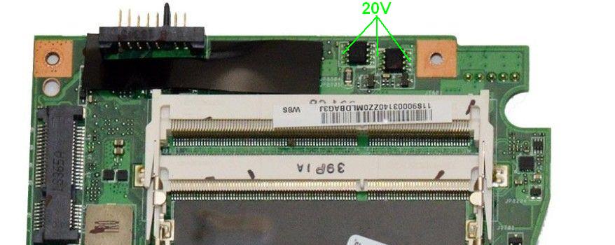

        There are definitely things you can do without a schematic. There are many similarities between boards, and the individual chips usually have datasheet available.
        For example, if the attached pic is what your board looks like, I can easily find the input MOSFETS. You should measure the 3 indicated points to make sure 20V is going through both of them. If not, then there is a problem with the input/charging circuit.
        If power isn't getting through both MOSFETs, then measure the pins on the input/charging chip. But if there is voltage all the way through, then check for voltage on the main 3V and 5V rails. If those don't exist, then measure the pins on the 3V/5V chip.
        You can confirm which chip is which by doing a web search for the the part numbers.

          i am getting 20vdc from the fets.

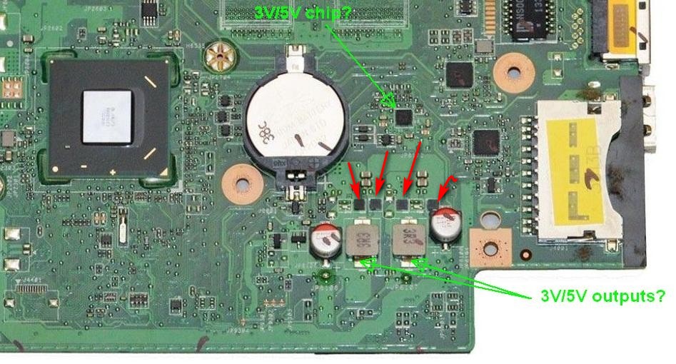

          i am not getting any voltage on the 3/5vdc rails, however i am getting 20vdc across those four small caps just above the inductors.
          so i focused my attention on the chip next to the RTC coin.
          but this is where i f*cked up..at first i was getting 3vdc and 5vdc across the caps next to the chip, but i accidentally short circuited two of those caps with the DMM lead because i was not being careful. now i do not see the voltage across the surrounding caps. i must have caused even more damage. i definitely saw a spark..

            I think that's happened to all of us at some point. Unfortunately, it might make the repair far more difficult or even too difficult/expensive to be worth doing. It just depends on what got shorted to what. For example, one of the pins on that chip is 20V and if that were shorted to the 3V or 5V rail, then there might be a lot of dead chips on the board right now.
            The best way to deal with this is to just start over. Make sure the AC adapter is unplugged and replugged from the wall so that it can reset (just in case it went into protection mode due to the short). Then check that the 20V is getting through both input MOSFETs.
            If so, then get the datasheet for the 3V/5V chip and find the 4 outputs. There are 3V and 5V LDO outputs and 3V and 5V switching outputs. Check them all for shorts to ground (multimeter in diode mode, red probe on ground and black probe on the pin you're testing... a short will read as less than 0.1V).
            If you find shorts, then they can be investigated. If not, then the 3V/5V chip may need to be replaced before dealing with anything else.

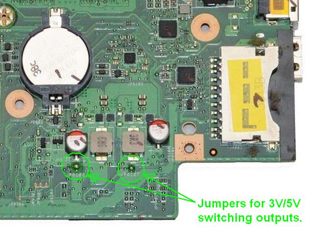

                The inductors are on the main switching/buck outputs. So those were not outputting voltage originally. That might have been due to a short on one/both of those rails, you had a bad 3V/5V chip, or the 3V/5V chip wasn't receiving the enable signal to turn those outputs on. But now they definitely won't work since the LDO outputs aren't working.

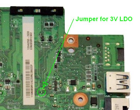

                The circled blobs of solder in the attached pictures are solder jumpers. And they are awesome. You can disconnect the 3V/5V outputs from the rest of the board by just using some desoldering braid on those points. It can really help narrow down where problems are.
                There appear to be at least 3 solder jumpers. There are two by the inductors for the switching outputs, and there is one more on the opposite side of the board for the 3V LDO output. The 5V LDO output may not have one, but if so, it's going to be nearby.
                Just go ahead and check for shorts at the inductors and also at pins 3 and 13 of the 3V/5V chip. If there are any shorts, disconnect the solder jumpers and then test both sides of the jumper to see which side the short is on.
