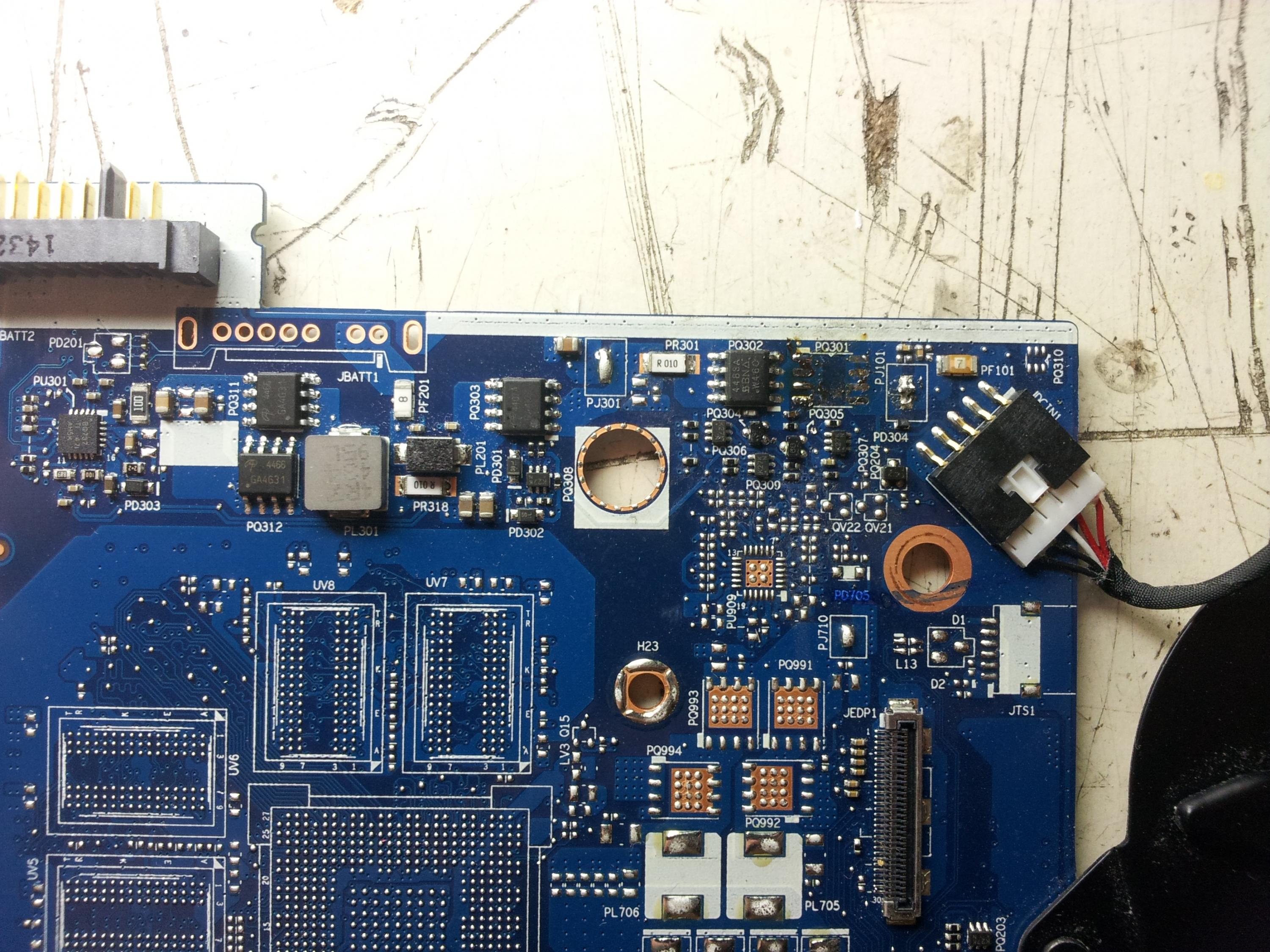

    I received today a laptop for repair that had probably a short circuit in DC jack.
    Has no response at all, neither battery charging, neither on pressing power on.
    The picture is from the "modification" the customer made and lead me to thought of short circuit i told you before.
    Schematics of M/B uploaded.
    Thanks in advance!!!

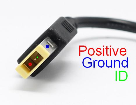

    Alright, so the first thing we need to know is if the AC adapter works. It's possible it could have shorted at the spot in your picture. That may not damage the adapter though. They are usually pretty smart about shutting down when shorted. Well.. good ones are anyway.
    Test the voltage. It should have 20V between positive and ground. There is also an ID pin in the center. There is a resistor inside it that connects that pin to ground. The value of the resistor will tell the notebook the wattage of the AC adapter. The notebook won't run/charge if it thinks the AC adapter isn't powerful enough.
    Common values of the resistor:
    45W = 120 ohms
    65W = 280 ohms
    90W = 550 ohms
    Even if the AC adapter measures okay with a multimeter, it still might not work properly under load. It's always useful to have another adapter to try. A universal adapter with many different tips is a good investment.
    If the AC adapter is working, then the next thing to do is follow the power on the motherboard itself.
    Check that you get 20V on JDCIN1 pins 1-2 (page 51). If it is there, then follow it through the fuse PF101.
    Next, make sure you can read 20V on both sides of PQ301 and PQ302 (page 53). If so, check the 3V and 5V regulators PU401 and PU402 (page 54). Check the LDO and the main output on both. If they aren't working, check for shorts.
    It's also a good idea to test the "ADAPTER_ID" pin (pin 3 of JDCIN1) to make sure it does not have a short to ground (with the AC adapter unplugged).

      Ok hold on, if this adapter has 3 pins it means it should got 3 wires too, correct?
      Because as i see the customer has "connected" only 2 wires in charger damaged cable, so we miss one?

        The resistor is actually in the connector part of it. So they didn't need to add a 3rd wire in the cable.
        Some AC adapters, like for Dell notebooks, do have an extra wire because the center pin is a serial data communications pin. But the Lenovo ones keep it really simple. No communication. Just a little resistor.

          Re: Lenovo G50-30 Completely dead, no lights at all.
          Charger gave me 119Ω so i think it's ok (45w)
          I get 20v on pin 1 and pin 2.
          I also get 20v on both sides of PQ301 but on the PQ302 i get them only to the one side (the side that "looks" to PQ301) the other side gives readings of only 0,9v on all pins.
            Okay good, now we know where the 20V stops.
            Next, measure voltage on PQ302 pin 4. If it's 0V then PQ302 is probably bad. If pin 4 is around 20V, then unplug the power and check for a short between PQ302 pins 5-8 (they're all connected) and ground.
            If there is a short, then it will be time for a fun short-finding expedition.
            If there is no short, then measure all pins on PU301 (20 pins total). Also measure all pins on PQ306, PQ308, PQ309, and PQ310 (they each have 6 pins).
            Waiting for messages back and forth is the longest part. Better to do as much measuring as possible.
                PC307 is probably bad/shorted.
                Everything you measured tells me you are supposed to be getting 5V on pin 4 of PQ302 right now. But you are not. So the 20V must be shorted through either PC307 or PQ304. But a bad capacitor is more likely.
                Measure the resistance across PC307. It is probably at/near 0 ohms. If so, remove it and test it out of circuit to make sure it's still 0 ohms.
                Also, test the pads to make sure the short is gone with the capacitor removed. If so, then you've found your problem.
                The component is an 0402 sized 0.1uF 25V ceramic capacitor.
                    I tested PC307 on circuit measures 180Ω ,when i removed it i got 10MΩ and was increasing for as long i was taking measure 11MΩ,12ΜΩ,13ΜΩ and so on.
                    PQ304 has 20v an all three pins, PQ305 has 20v only on pin 1,PQ301 has 20v on all pins.
                    I removed PQ304 from circuit and gives no measures at all, with black on pin 2 and red on 1-3 and the opposite with multimeter in diode mode.
                    Just to make sure, PQ304 pin 2 is the one that is directly connected with the pin 1 of PQ305, correct?
                    Also in Ω mode the PQ304 shows various resistance on all pin combinations, i think the pin 1 should not give any resistance at all.
                    Now i'm confused though, how is it possible the PQ304 to be faulty but the same time to have output 20V to PQ305 that hasn't output at all?!
                      It sounds like PQ305 is good.
                      Yes, PQ304 pin 2 is connected to PQ305 pin 1. The 20V on pin 2 gets there through the biasing resistors that are built into that transistor. You can see them drawn on the schematic. The blue circle is indicating that everything inside the circle is inside that one component.
                      PQ304 is a PNP transistor and should never have 0 ohms between any 2 pins. I suspect you are reading nothing in diode mode due to the biasing resistors and the low power used by the multimeter. That's okay for now. We are looking for a shorted component and it seems PQ304 isn't it.
                      PR303 and PR308 form a resistor divider with 20V on one side and 0V on the other. That should give about 5V in the middle. And a voltage that low will turn on PQ301 and PQ302. But it doesn't have 5V. It has 20V. And 20V turns them off. So, there must be a low-resistance path around/through PR303. The only thing that is designed to do that is PQ304, but PQ304 is supposedly off (It should only turn on if PQ305 turns on and pulls PQ304 pin 2 down to 0V). Therefore, there must be a short circuit through something (i.e. a bad component).
                      I'm attaching a picture that shows the voltages you have measured and the corresponding state of all the transistors. I find it very useful to write voltages on the schematic like this. The orange arrows show the only possible paths for the 20V to get where it is now.
                      There are no other options except for things like physical shorts between traces on the board. The following are the only components that could be bad:
