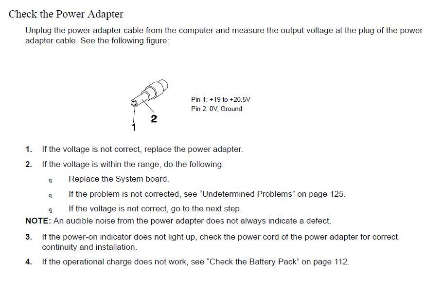

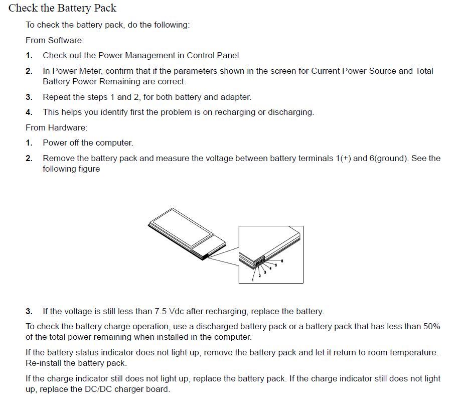

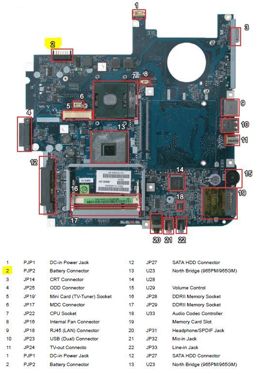

                        Found these if they help and there is a schematic for your motherboard here
                        Hope this helps bud
