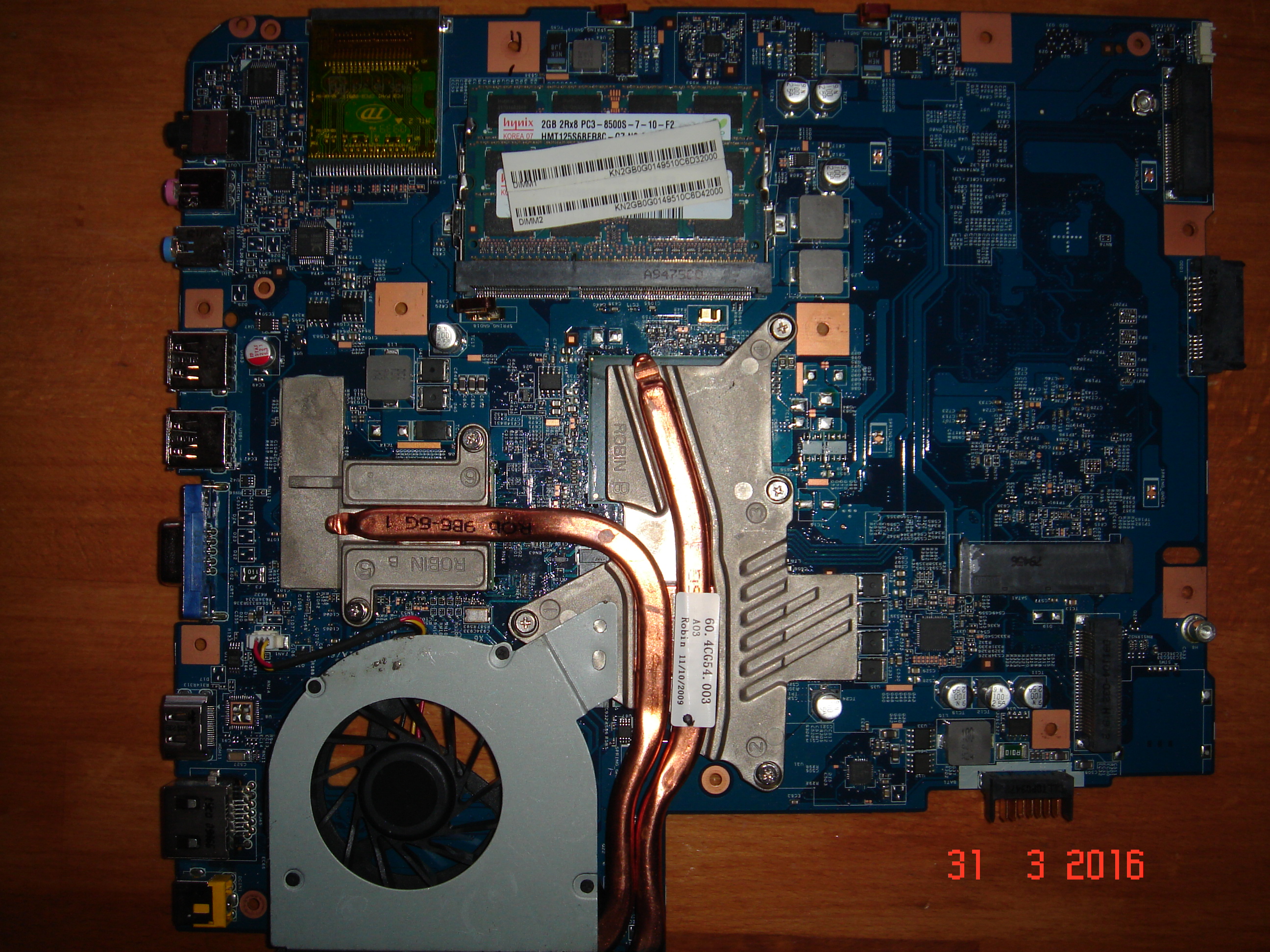

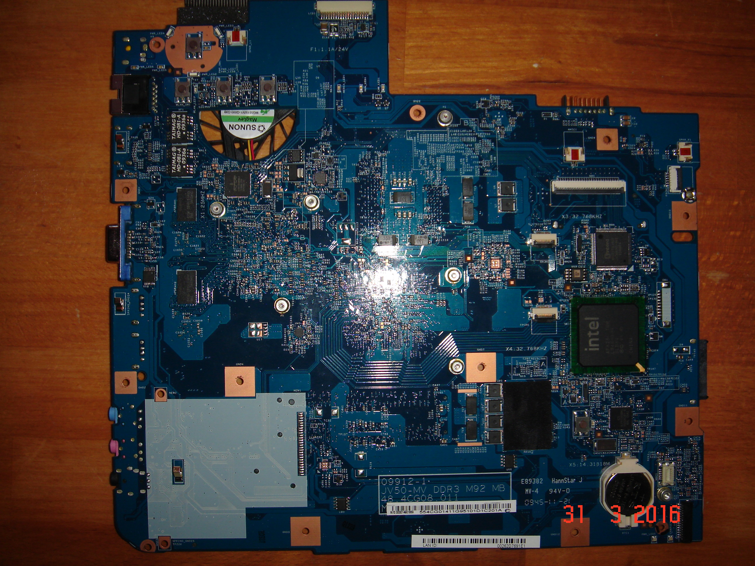

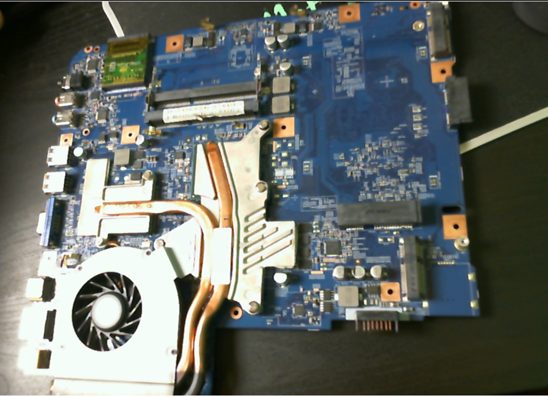

    Hello guys,
    i have here a Acer 5738ZG with motherboard JV50-MV DDR3 M92 MB
    GPU and Chipset reflowed, all bga are getting Hot but i still get a black screen.
    Do you think that i should reflash bios, or it's a waste of time ?
    Any help apreciated.

        Reflow is a waste of time. Do a reball of GPU or change it and youl'll see. Of course you can try reflash BIOS first.

          i would first try bios . if that doesnt help, i would probably reball the intel northbridge ( if it is the small one, reflow wont help. u have to reball it.

              umh that looks like an old mainboard core 2 duo. check all coils voltage when it turns on.

                      make a high quality picture of the whole board.

                        I can also make a photo of a particular component, if needed.

                              if cpu and gpu get hot could be: vga bga problem that need reballing or bad memory ram or bad bios.
