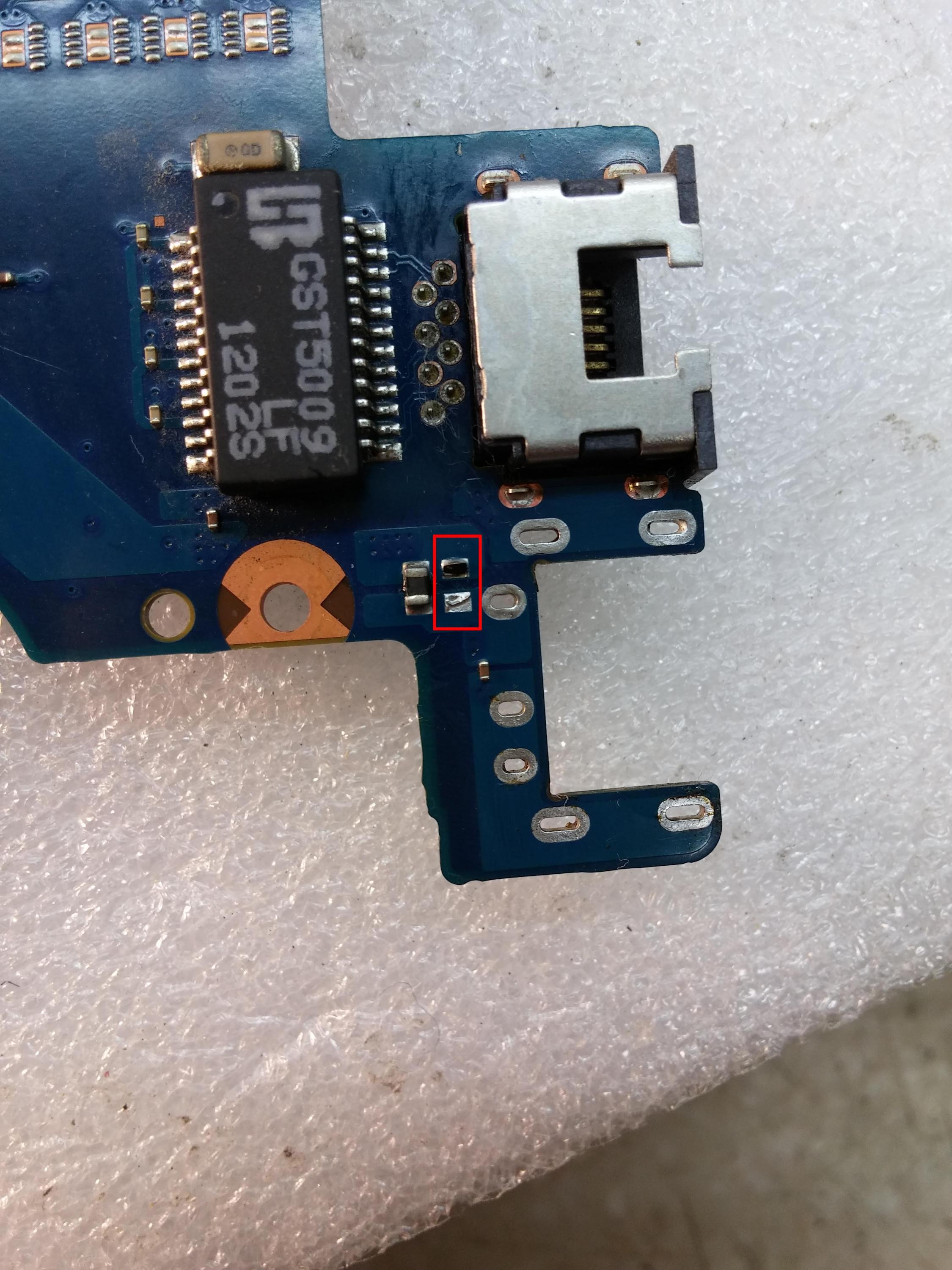

    hello
    i have laptop that the dc jack broke and 1 part is now missing
    can some one identify it please ?
    part is from samsung 305ea51-a01il
    thank you

    Re: missing part on samsung 305e5a
    why do i think that its a filter cap and it will work without?
      It is inductor...marking HU-1M2012-121JT
      you can put a pair from different board it will work...

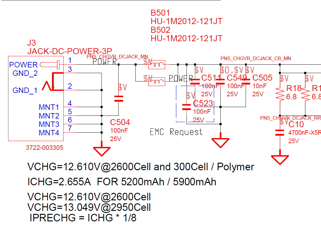

        Do you have a diagram or you did something similar?
          Well you can see it from first picture...Missing component is in parallel with standing inductor...Just by looking traces it is all conected to positive lead of dc connector...Filter cap should be connected to the ground from one side,but you can se that the ground side trace is clearly separated... This is very common on these boards...here is diagram from similar board :
            thank you Djosla and dj_ricoh
            i cant find the part HU-1M2012-121JT on ebay does it have
            alternative ?
            thank you
              You can take it from ny board you have in stock that has input LC filter next to the connector...It really is not that importaant as many laptops doesn`t really have it...A piece of wire could work but it is not professional...
              In theory your laptop should work even without second inductor but it could cut off due to overload...
