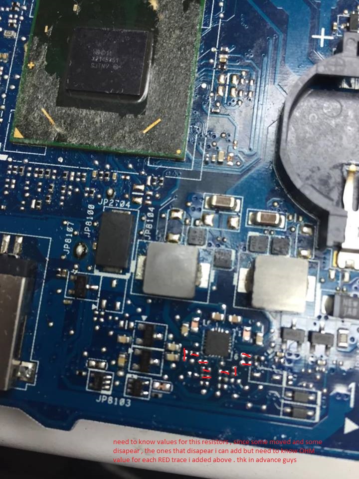

    hey guys , serious problem ,need your help
    got this l850 on my desk , with issues on kbc and with regulator , while replacing regulator , 2 components disapear and outher 2 changed position , since im not sure
    here is a photo , i added red traces were i need to know values .
    th in advance , alltough dont forget this is on UMA board
    PLF PLR CSF CSR UMA

    Re: hey guys , serious problem ,need your help
    In the schematics they list C850, C855, L850, L855 together
    Maybe this is for the boardview file C850, C855 the same, because the folder from the boardview shows also C850, C855, L850, L855.
    Hope you can use it, it's not uma but it might give an impression
    You also can try the datasheet from the chip. Mostly they give a basic application schematic where you can see the values.
      Hi
      i have spare mbs that you can use components, stop by
      ps. you know that you have a knob that reduce air flow right trolling
        lol , obviously filipe , but the problem was doing to much things at same time , and i was not paying the attention i should , hot air is always with same speed FAST
        i will ask luis to pass by to see the mbr , btw the mbr is the one who have the 1225c right beneat the PCH
          hi
          its exactly the same as yours and you can rip components out
