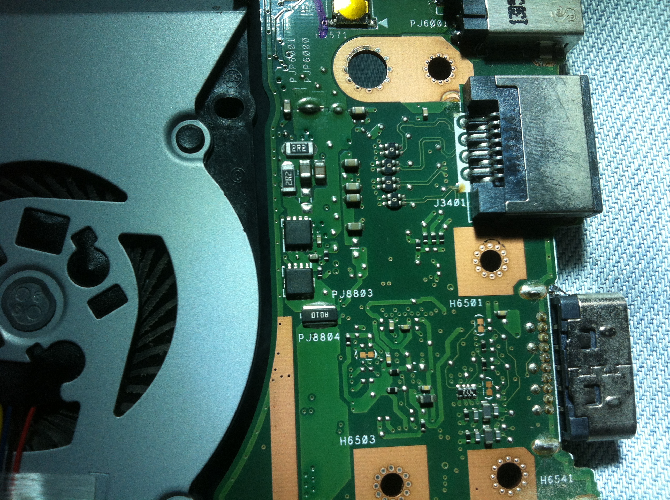

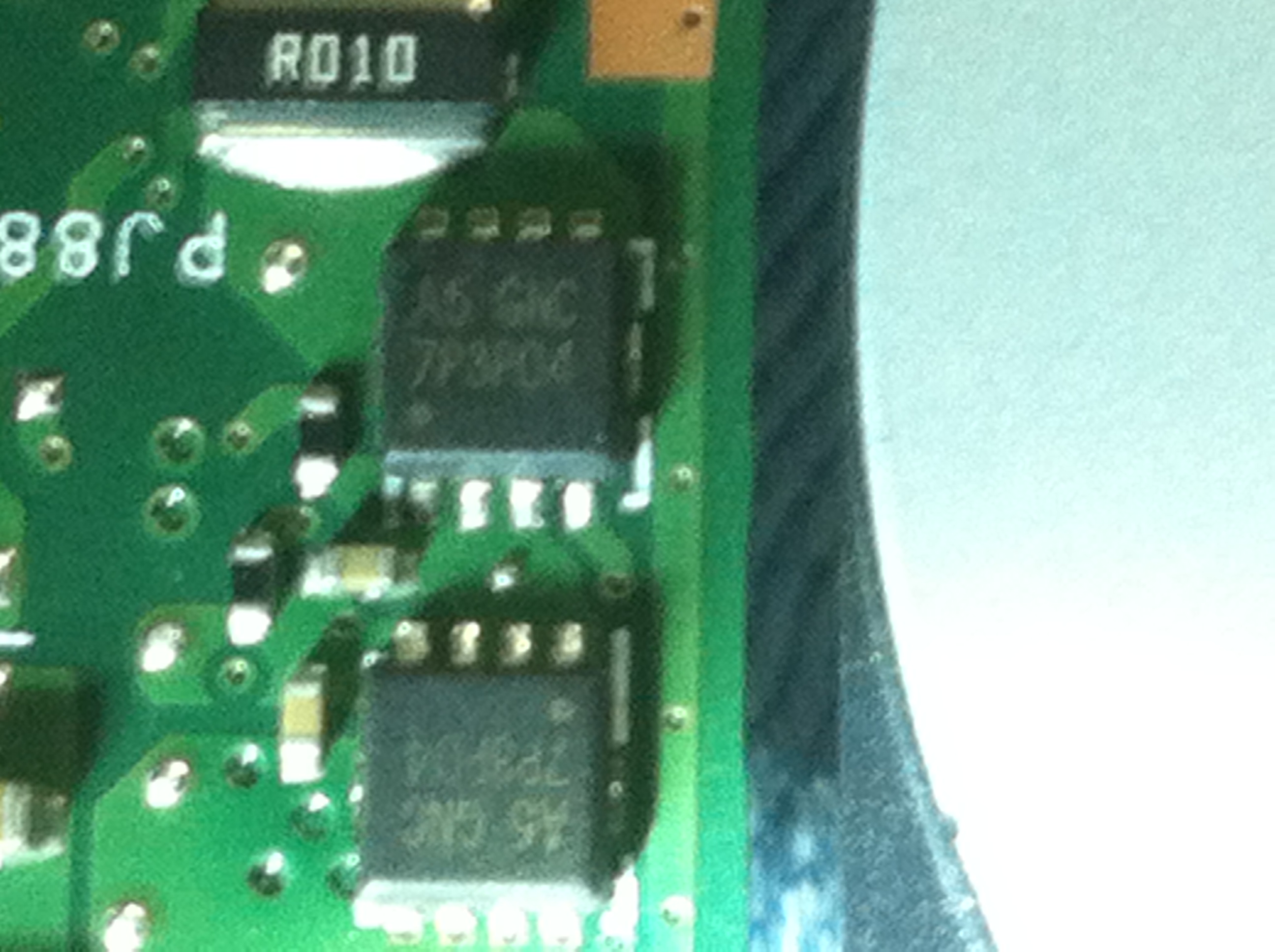

    This mosfet got the top mark like this:
    A5 GNC
    7P3P04
    thanks..

      Re: help needed to identify mosfet
      it's asus S400CA...

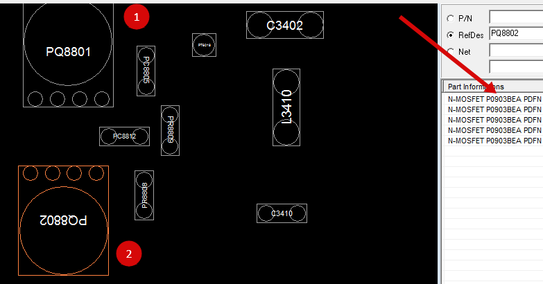

          P0903BEA. N-Channel
            Bro it's a P-channel Power MOSFET. Replace with another P-Channel power MOSFET in SOP-8 package.
              unsolder and check channel. then replace with other
                  A5 GNC
                  7P3P04
                  thanks..
                  dears, I´m sorry for hear this i hope not be too later, this is a N-Chanel I just replaced one same for si7326dn and working fine
                  https://cdn.badcaps-static.com/pdfs/...87f8f4fa76.pdf
