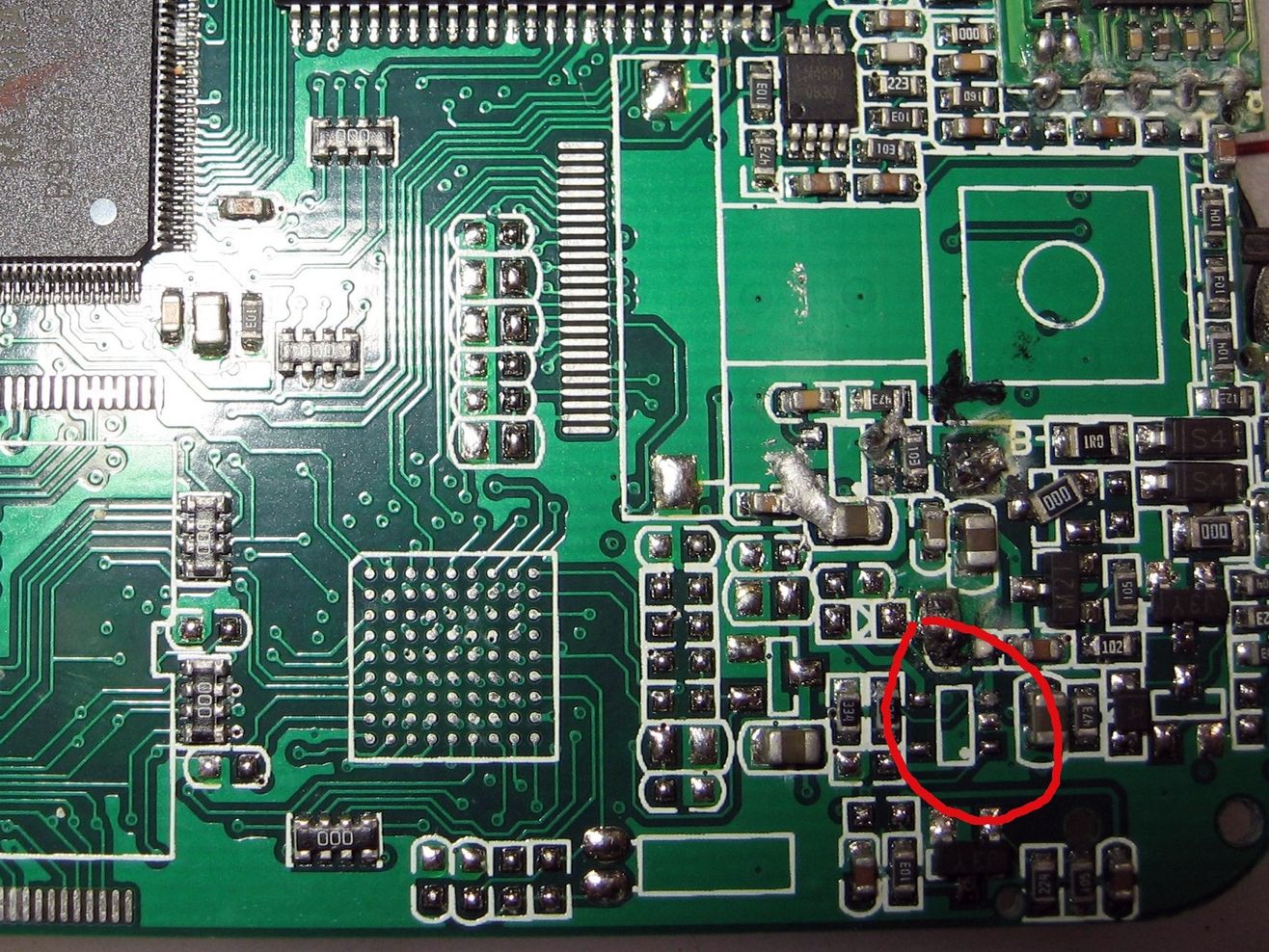

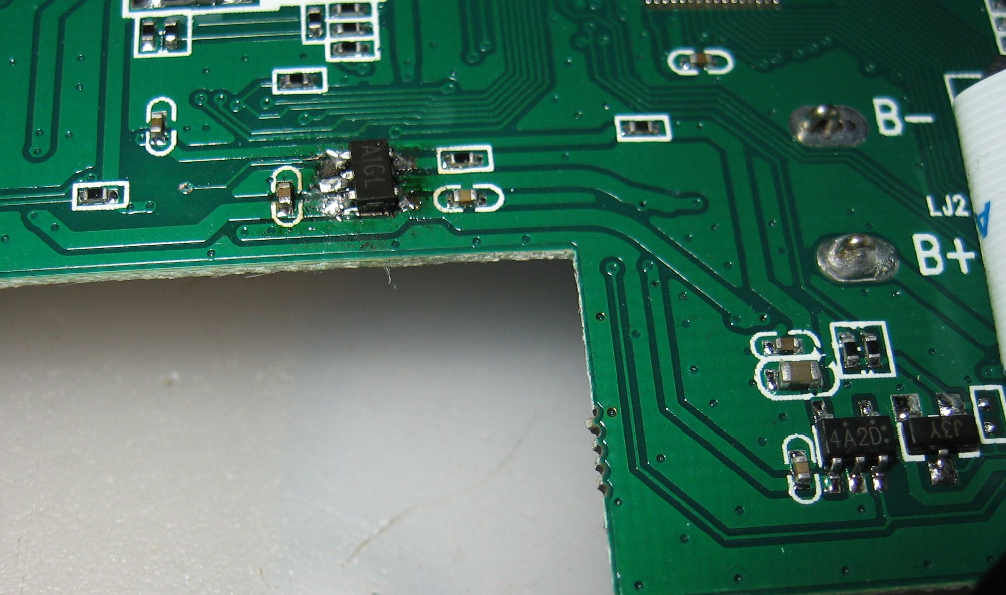

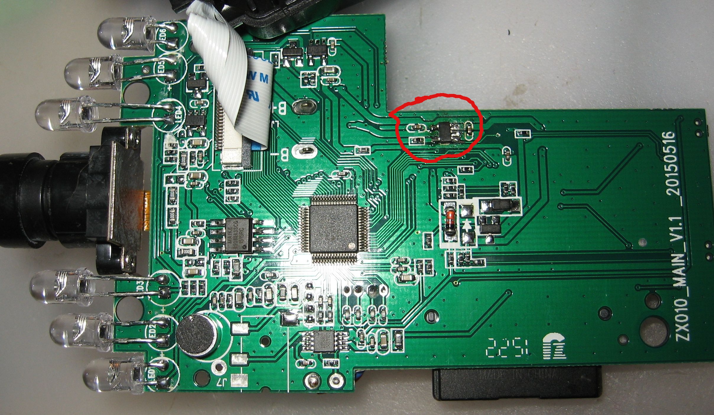

    This camera worked for couple months and then stopped, it was weird because it started blinking like it was trying to turn on, then off and so on. When unplugged from charger, it was running OK on battery. I tried another charger, it looked like it worked, but time would reset time any time when unplugged. Also there is button to turn IR night light and camera would freeze any time I tried to turn them on. I used it with new charger for few more weeks (I didnt care much for time settings or IR lights), but now it started to blink on/off again. Then charger burned. I opened camera and found burned regulator. I cant see any marks because plastic was destroyed, so I took some old board from MP4 player that also work with USB charger and on 3.7 battery, found regulator that looks the same and changed it. Appears to be working now and even keeps time and I can use IR lights without camera getting frozen.
    I wonder if I can leave it like that or maybe somebody can ID original part.
    On pictures: 1st pic - shows A1GL I took from player and replaced unknown burned one.
    Pic #2 - full camera board and this regulator circled in red.
    Pic #3 - player board and previous location of A1GL is circled with red.
