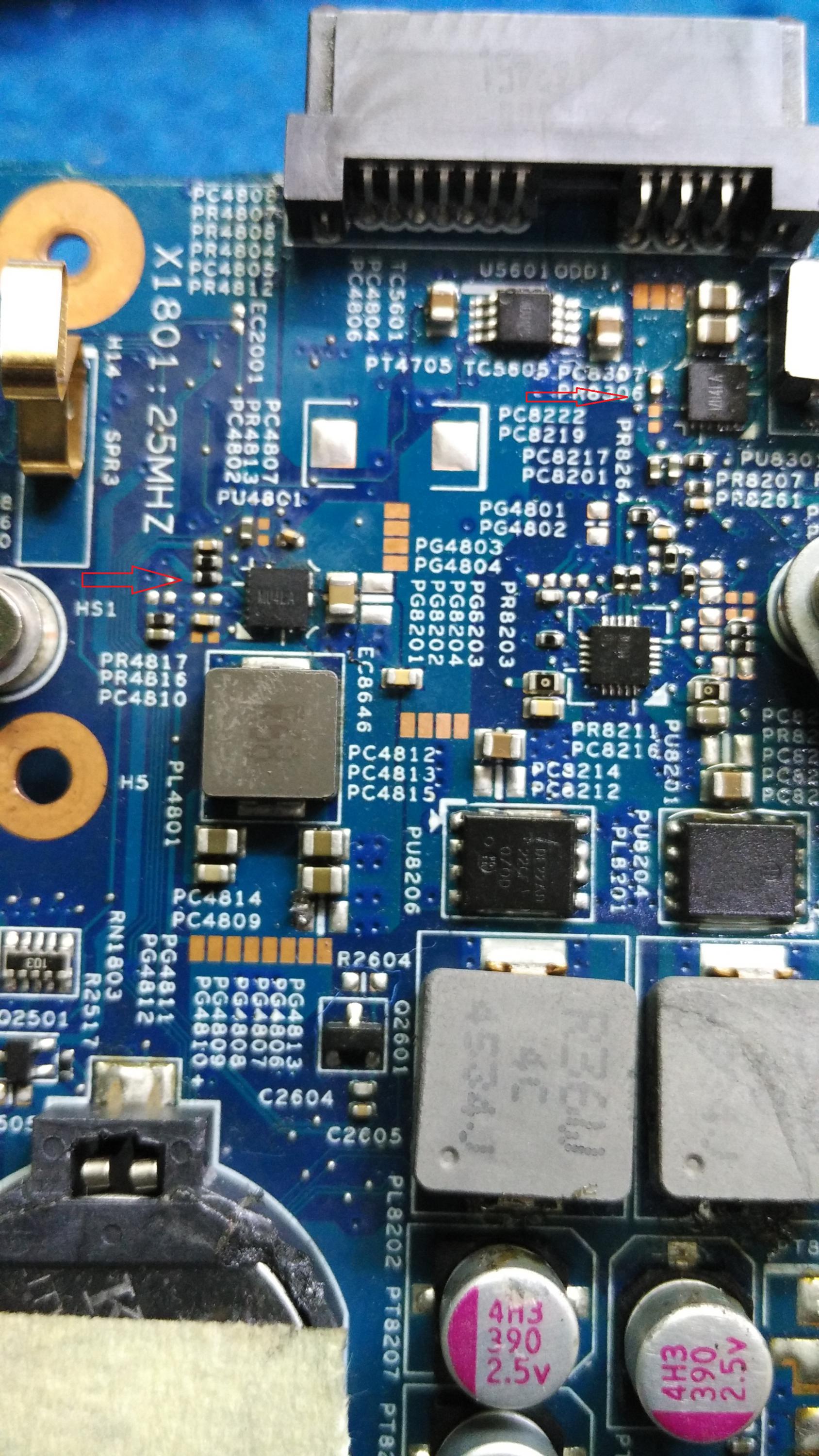

help again, I cant determine what type of this IC, MU4LA
  • kazia
    • May 2015
    • 145
    • indonesia
    any one know?
    and what substitution for this ic?

    Re: help again, I cant determine what type of this IC,
    which platform (marking) motherboard?
      it's asus x450j.
      SV41 JN MB
      13320-1
      448.01P03.11
      only that printed on the board,
      and only one ic is bad the other one is work, I have switch that two ic's.
      that ic's is look like sy8208dqnc which code MU3XX, try it and not work.
      http://www.*****************/detail/...dqnc-1132.html
        Pu4801 - sy8208bqnc

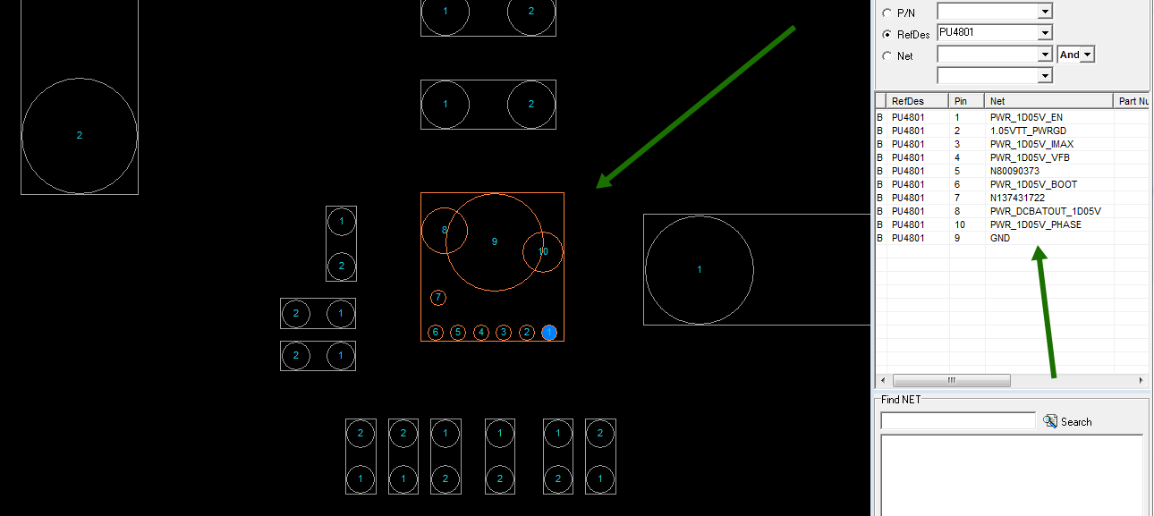

                    didn't find schematic and datasheet the IC, if I see from kotnatan's pic the IC for PWR_1D05V rail
                    Did you get voltage on pin#1 pwr_1d05v_en?
                    try register on http://**************/load/noutbuki/306 you'll find boardview for this model, you should pass the test first. then search asus x450jn
                        The SY8208 part was manufactured by Silergy (it was also the subject of a patent infringement case). AFAICT it has at least three versions -- adjustable (DQNC), 3V fixed (BQNC), 5V fixed (CQNC).
                        Note that the suffix is VERY IMPORTANT.
                        Page 38 of the following schematic shows a SY8208DQNC_QFN10_3X3:
                        https://cdn.badcaps-static.com/pdfs/...64b9172990.pdf
                        The Compal circuits show a SY8208BQNC_QFN10_3X3 on page 1 (PU401), a SY8208CQNC_QFN10_3X3 on page 1 (PU403), a SY8208DQNC_QFN10_3X3 on page 2 (PU701) & 3 (PU451):
                        https://www.badcaps.net/forum/attach...4&d=1450291182
                        More schematics ...
                        https://cdn.badcaps-static.com/pdfs/...334a2c1a25.pdf
                        The SY8208DQNC incorporates an adjustable step-down switchmode converter with a feedback reference voltage of 0.6V.
                        The SY8208BQNC appears to be a fixed 3V converter, and the SY8208CQNC appears to be a fixed 5V converter.
                          Big Thanks to every one, problem solved,
                          yes the IC is sy8208DQNC adjustable not fixed voltage.
                          unfortunately bios is curupped to, that's why this board still not work.
                          after flash that dump bios, bord working perfectly,
