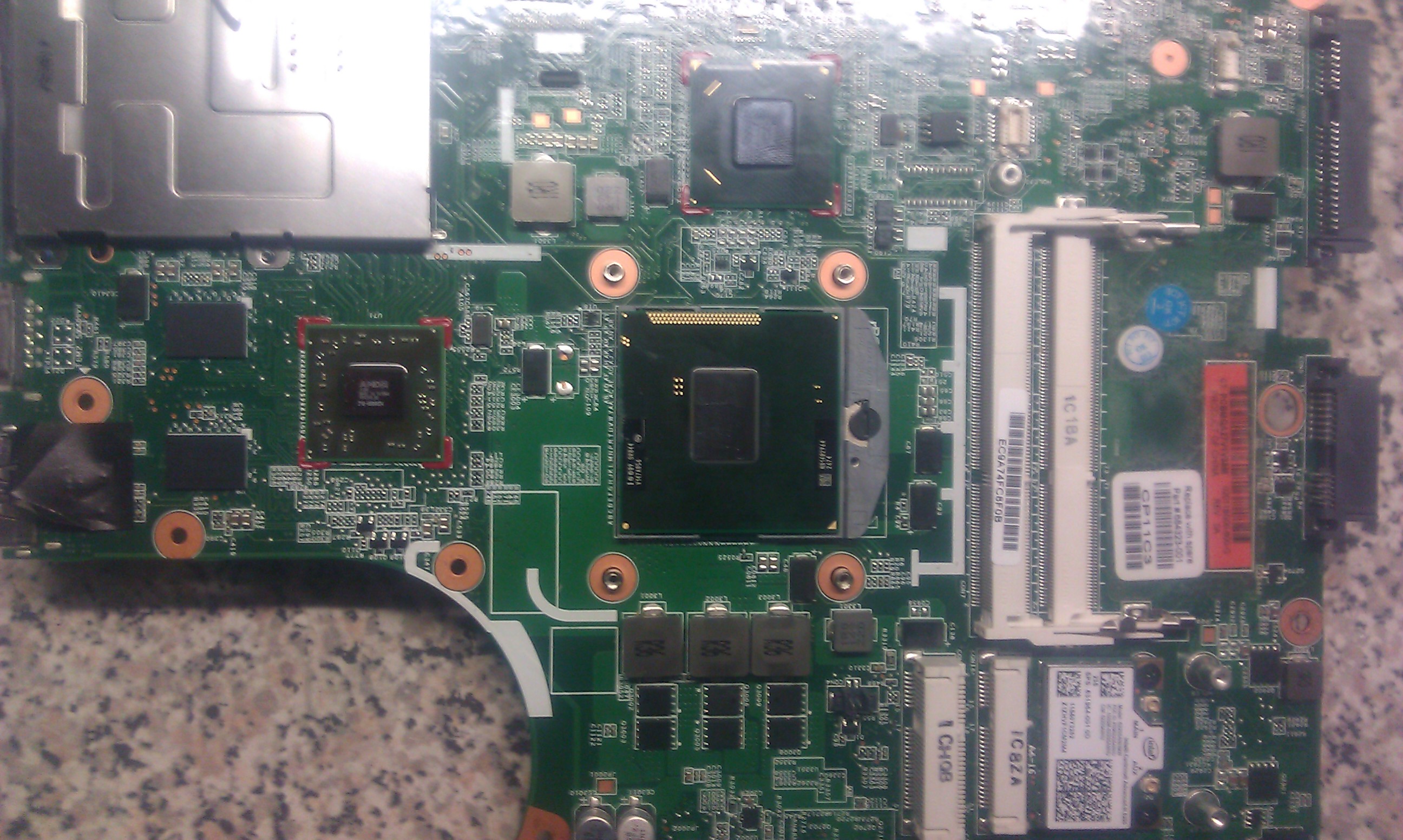

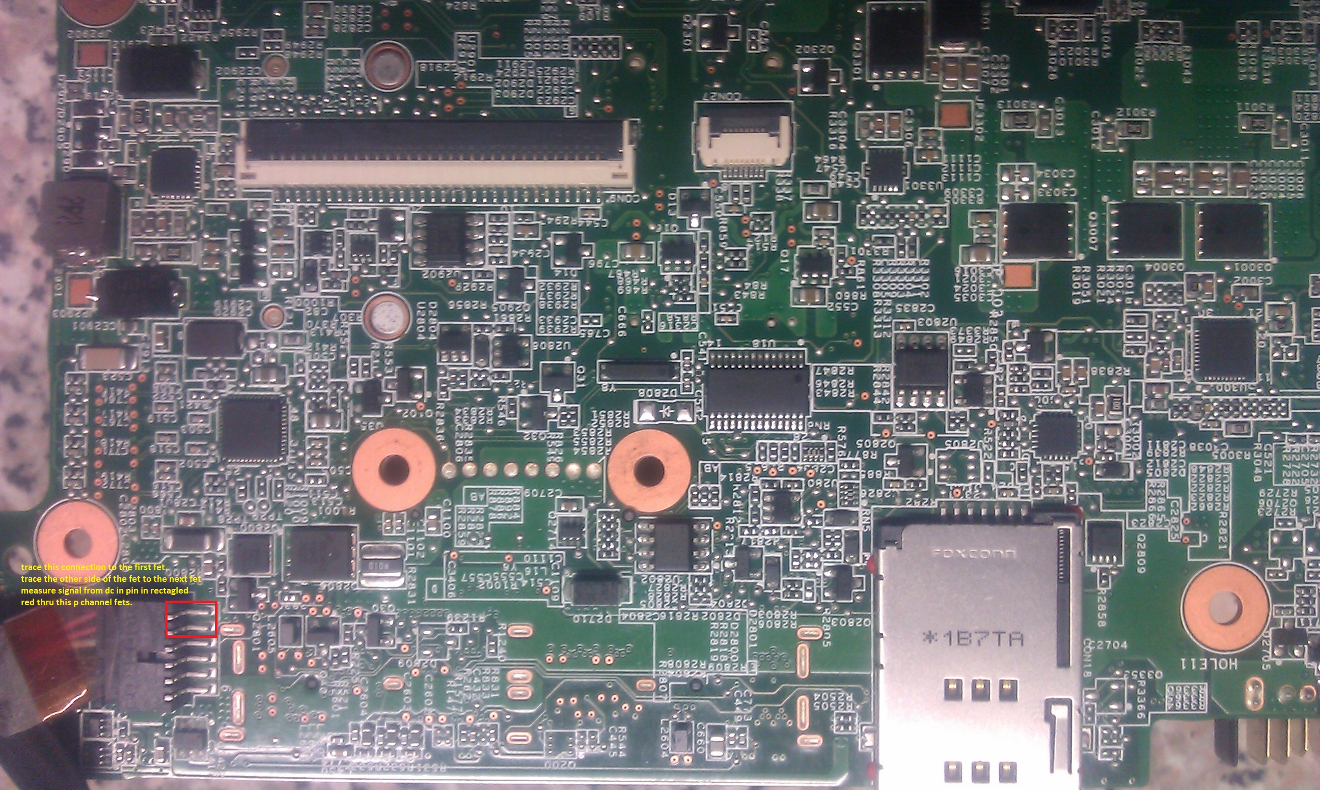

    On the mobo from HP8560p it have a short to gnd, but it looks to be all over the board in different areas. Is there a general supply where this can be generated.? the mobo is totally dead, I have 18,4V on Vin of the RT8205C.
    The rest is all zero. I changed it for a TPS51125, but no result/
    Both with the Ohm meter and Diode meter I get 0 in the 3V and 5V connections.
    No short in the big capacitors or coils.
    So Vbatt and Vadp are present but the V3A and V5A are shorted to gnd.
    And most likely the rest too. No schematics, so I try to find things via datasheets of components.
    Anybody pls advise.
    Thx in advance

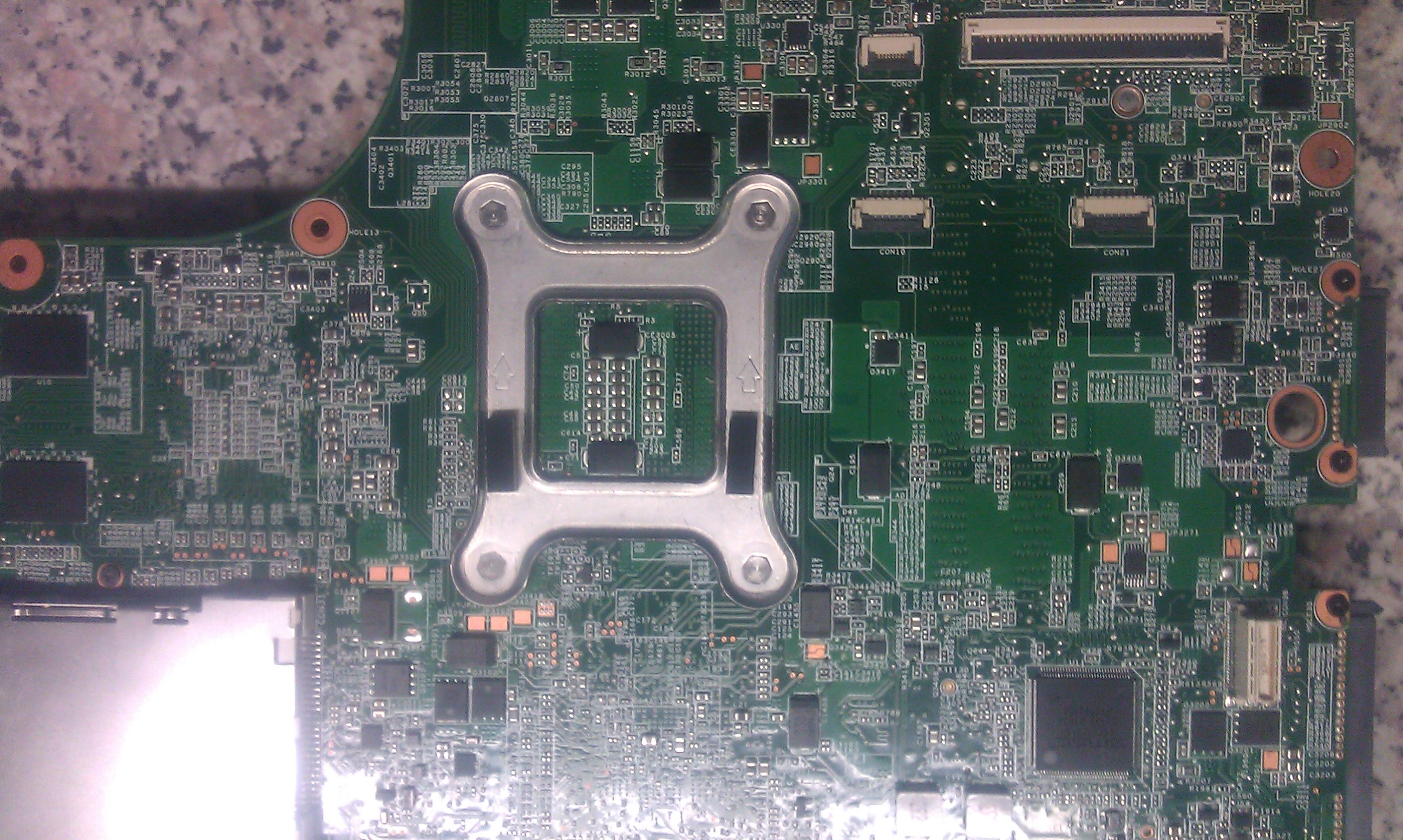

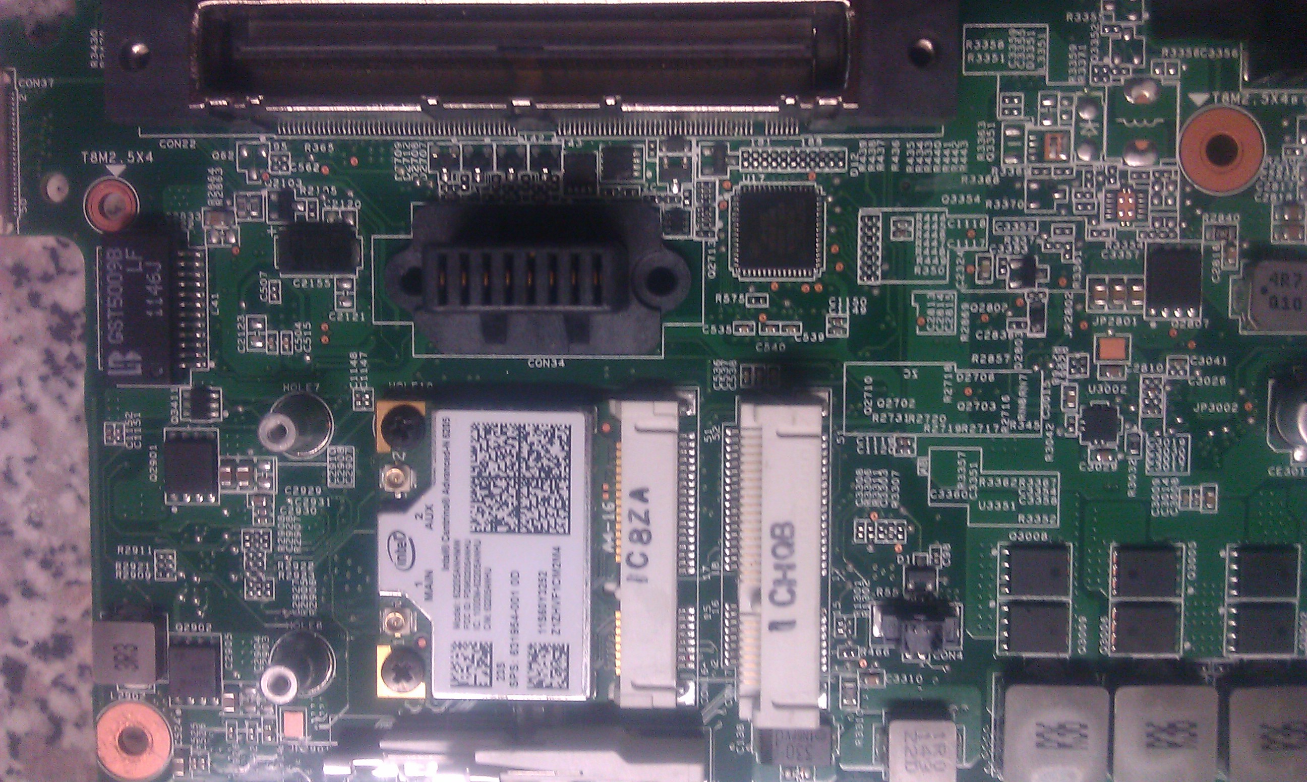

          Re: Everything looks connected to gnd
          Near CPU socket everything is 0V.
          On picture I put the measured voltages around the power connector.
          The power ID (pin3) is only 0.95 V at the connector, while the input is 18,4V
          I don't have a labpowersupply, is there any way I can simulate that?

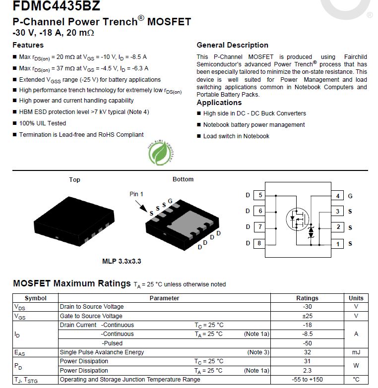

                    I'm sorry, but I can't find the mosfet where the 0.95V pin 3 (ID) is going to. I tried with the meter all over the board. I can follow the line about 10 cm till a component that is not assembled and then it disapears in the board and the onliest place I can find it on the other side is on the docking connector, I know that HP needs the ID pin, else it will not work,
                    so I was looking for the track on the mobo already but could not find it.
                    The voltages are in the picture

                        I think it's best you tell me where on the picture, I don't have schematic and read from other schematics I find dangerous.

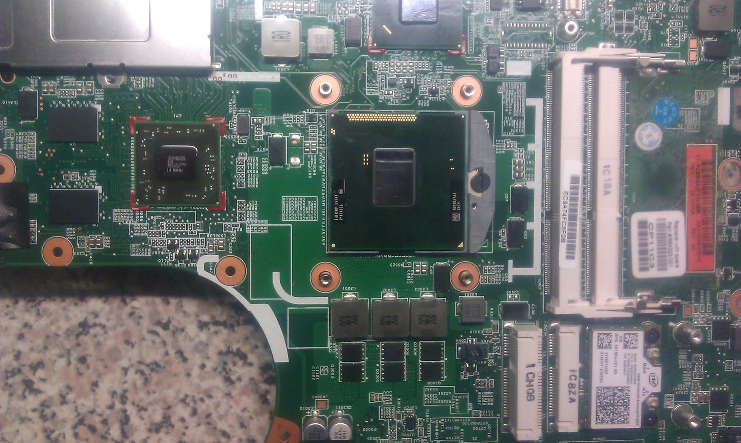

                        • fddizon
                          • Sep 2011
                          • 555
                          • Philippines
                          take a nice picture near dc jack with parts that have 8 legs on them.
                          like these two pictures
                          https://www.badcaps.net/forum/attach...5&d=1372652742
                          https://www.badcaps.net/forum/attach...4&d=1372652742

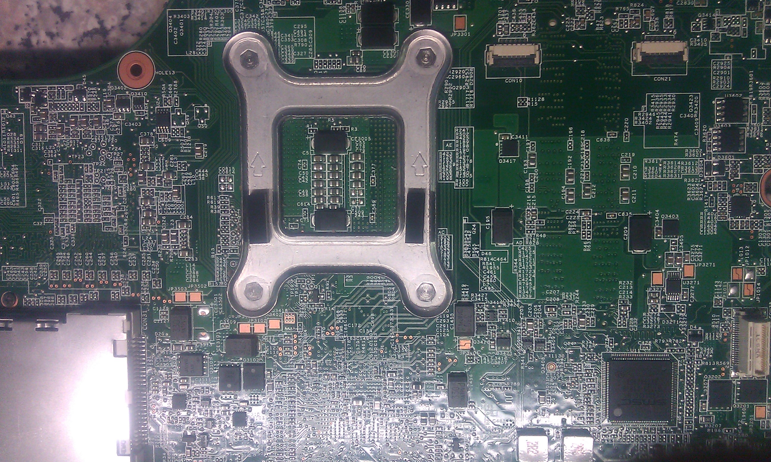

                            • hansie55
                              • Dec 2013
                              • 254
                              • Netherlands
                              herewith

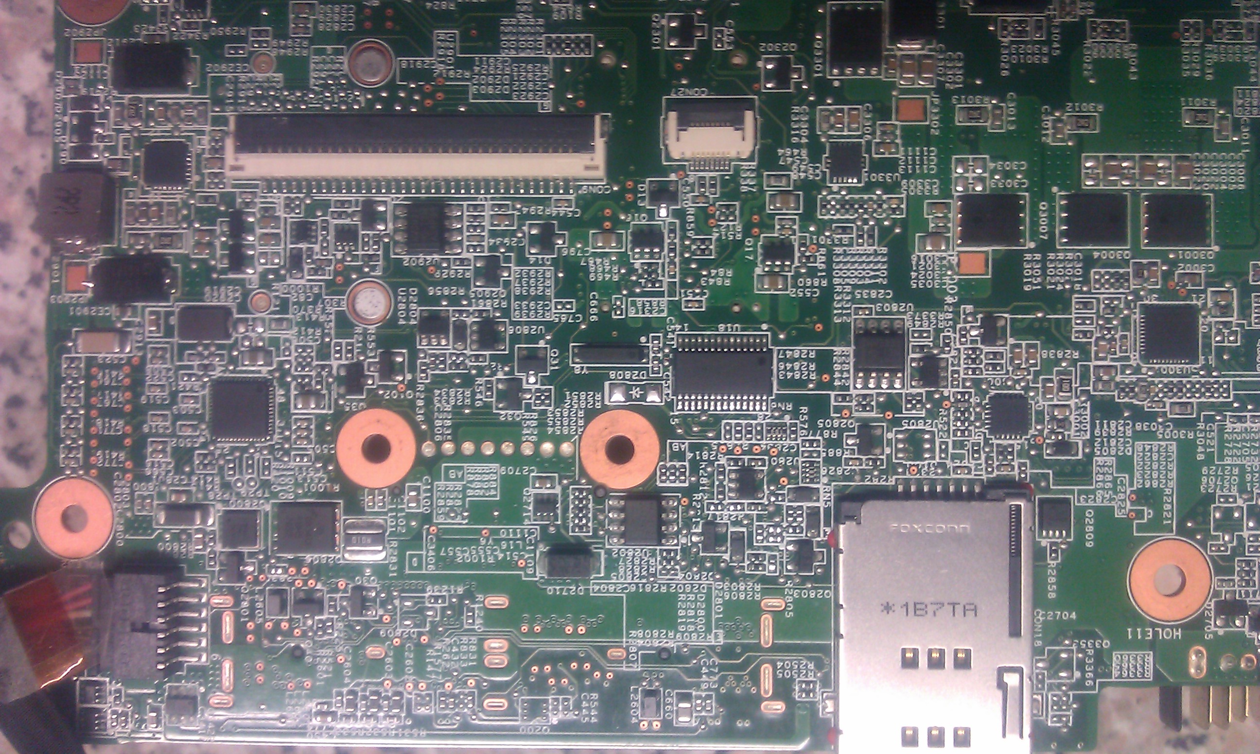

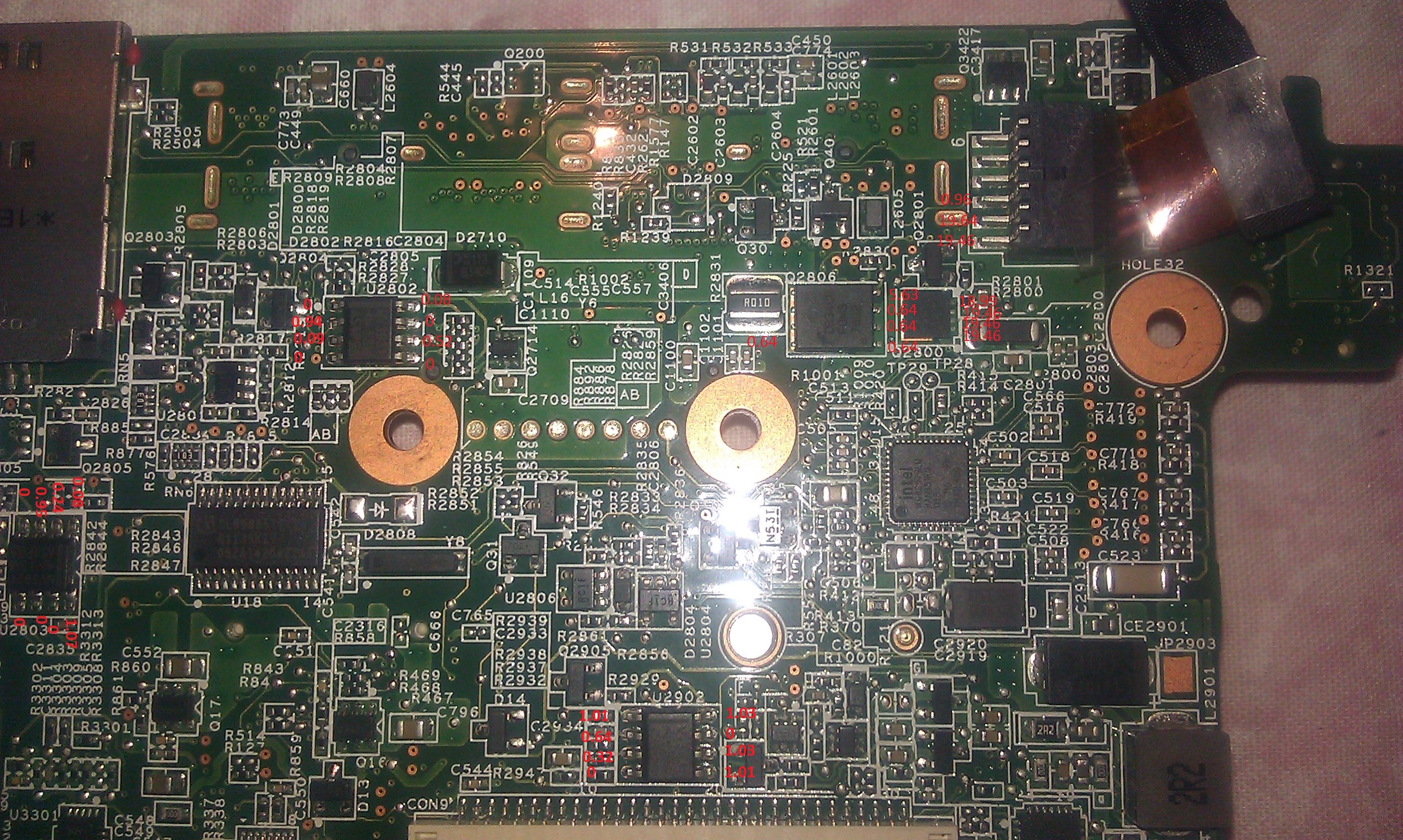

                                    • fddizon
                                      • Sep 2011
                                      • 555
                                      • Philippines
                                      try this... see attached
                                      when you find the fets that has one side with 19v and no voltage in the other side, thats where you will inject the 19v instead from dc jack
                                      • hansie55
                                        • Dec 2013
                                        • 254
                                        • Netherlands
                                        U did that and attached the 19V to pin 1 of Q2806.
                                        Now U2901 (RT8205C) got real hot, I took it out, but still a short there.
                                        L2901, C2901, C2902, L3241 and L3242 got warm, but U3241 ( EC1PG) is getting red hot. (I still have to find the real partnumber.)
                                        Multiple shortage??
