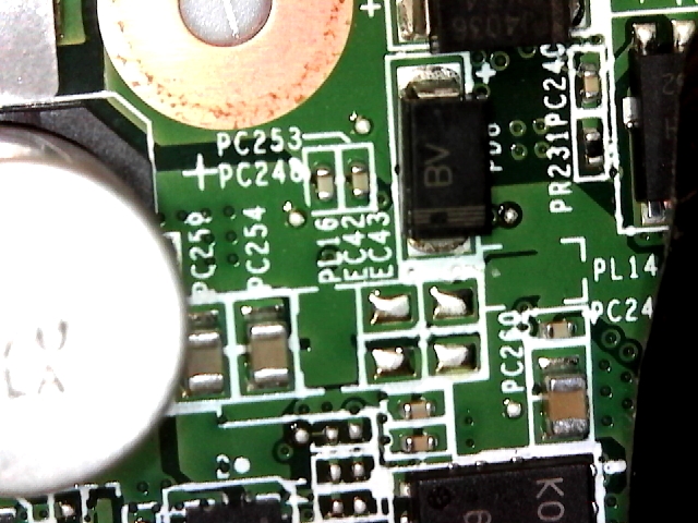

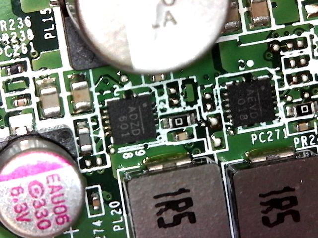

                        I am having trouble locating either of them on the board. I found the labels for them, but I don't know what component they are pointing too. A "PL" is an inductor, right?
                        See attached pictures.
                        • mattpd
                          • Oct 2012
                          • 302
                          Re: HP laptop with no power. Can you help me understand the shematics?
                          Maybe this is PL15 (gray component next to pink capacitor)?? If so, I get 3ish volts on one side and 0 volts on the other side.
                          I still can't see anything near the PL16 label.
                              I wonder if it's the right schematic. An inductor can look like PL20, the bigger component nearby or just like a SMD capacitor, only grey.
                              You need to find out if VIN goes to the chip. If it does you need to find out why it isn't switching, what the voltage on the EN pin is, or if the output is shorted elsewhere. What's the resistance from 3V3 and 5V to ground (with battery and DC power removed!) ?
