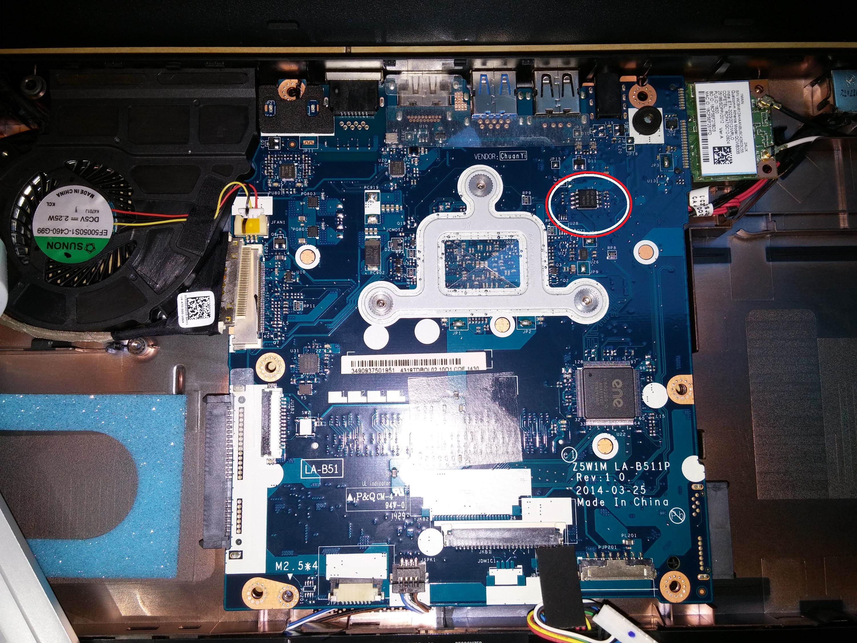

    Hi guys,
    I have an Acer ES1-511-C665 laptop. Last night I just shut down Windows, and this morning, it's dead. I don't remember doing or seeing anything unusual before this happened.
    Here's what I see when I push the power button:
    • The power LED light comes on for about 5 seconds, then off for about 5 seconds.
    • The fan spins for about 1 second, then stops for a while, then repeats.
    • The screen is black/blank, but I do see a white screen flash very briefly (like 100ms or so), might be the backlight.
    This repeats endlessly, like in a loop. The only way to get out of it is to hold the power button for 20 seconds or so.
    Desperate, I disassembled the laptop, and unplugged the battery cable, waited, re-plugged it, and re-seated the RAM, but still dead as before.
    Any ideas?

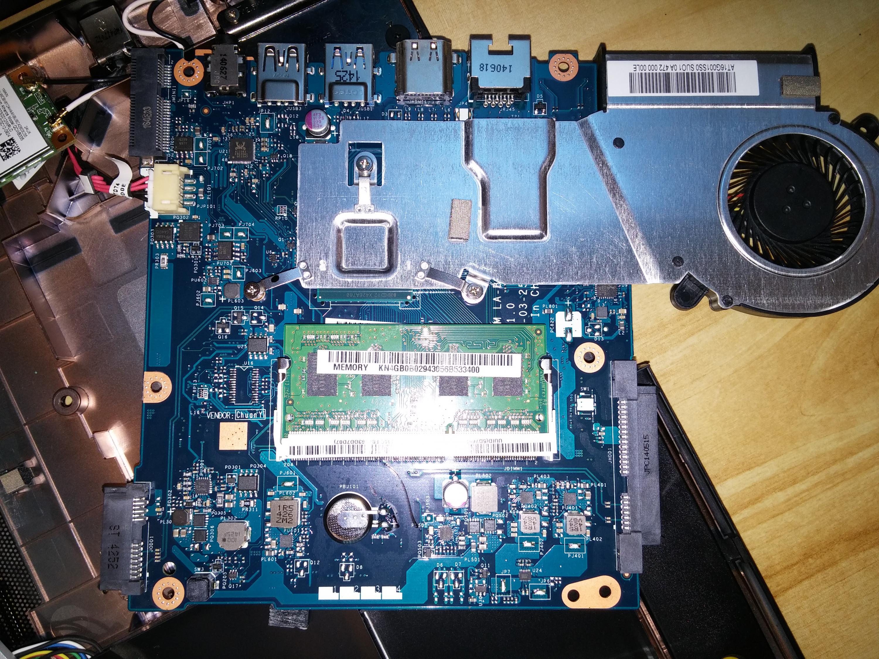

      Re: Acer ES1-511-C665 - blank screen, fan spins briefly, wont boot up
      hi post picture of mainboard, front retro. sounds like no cpu detected
      white screen could also be bad vga.

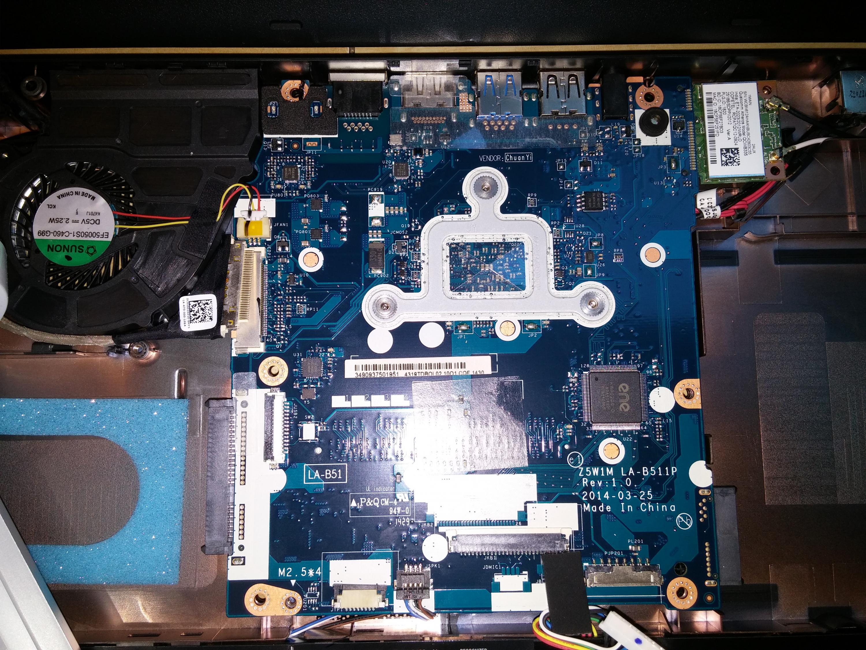

          Attached a pictures front and back.
          I really hope it's not the CPU/VGA... Repairing that would be out of my league.
          Originally posted by angel-boy
          try a bios dump,
          Sorry, I'm really new to this... Do you mean read the BIOS?
          I do have a Bus Pirate that can read SPI devices, but I've never done anything like this before.
          Could you confirm: The BIOS should be in the "BE1422 25L064CSIG POL534" chip?
              I recomand you to get help from a service to resolve the problem
              you need to write bios dump , the chip from picture
              I actually tried to read/backup that chip with Bus Pirate earlier, but I made stupid a mistake...
              I didn't read the correct datasheet before using Bus Pirate. It looks like the chip is actually a GD25LQ64 which is 1.8v. I thought it was 3.3v and just connected everything to Bus Pirate's 3.3v I/O and power...
              It did read it successfully several times, and no smoke, so I'm just hoping there was no real damage to it or anything else around it.
              I just bought a cheap level converter module on eBay. I'll try again when I receive it.
              Thank you for the files! I'll look into this again later.
