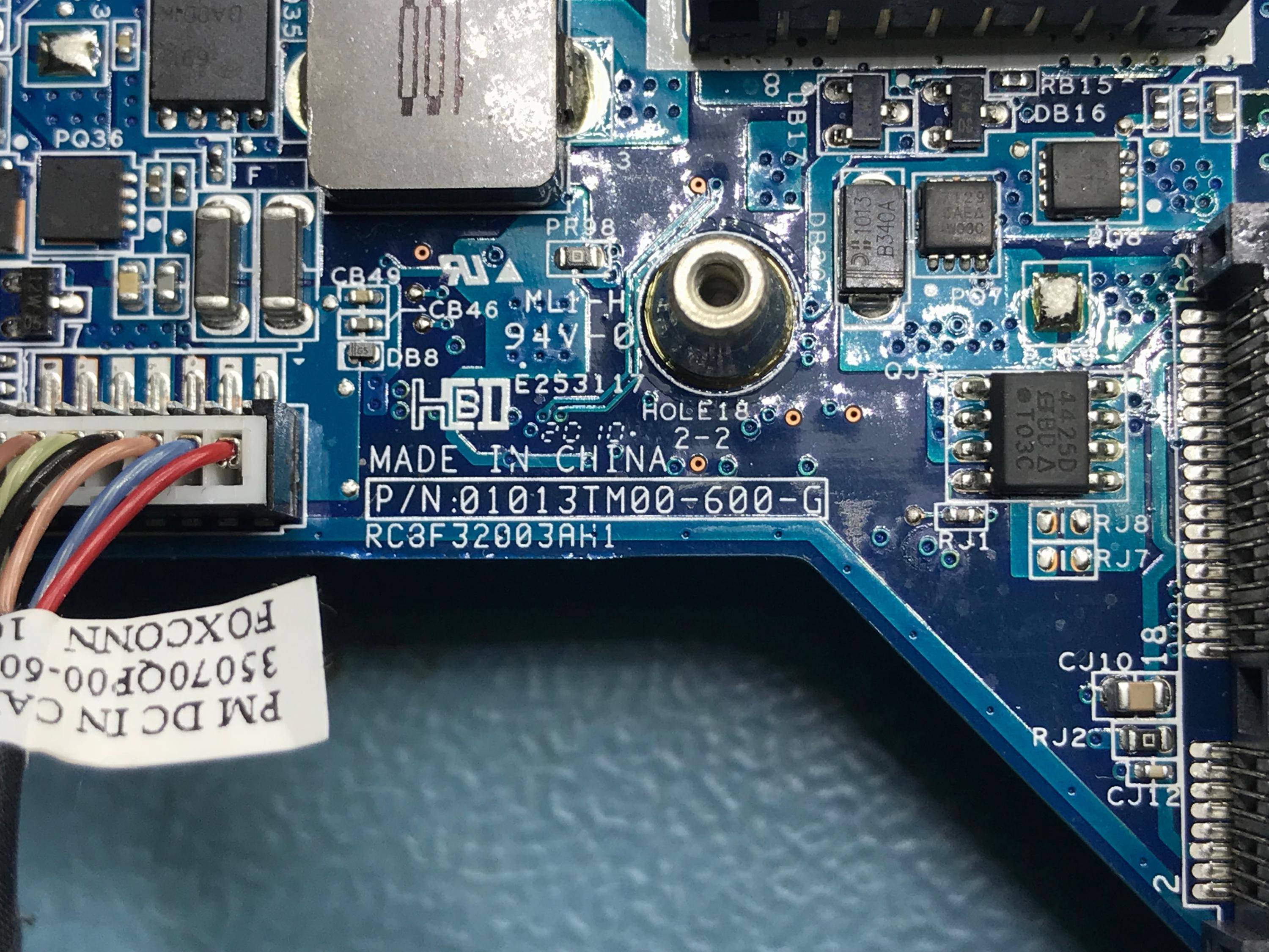

                            I tried convert dsc to uma on g62, mb: PM_A_HPC_S MV_MB_V1 , pn: 01013tm00-600-g , I followed instructions in this video https://www.youtube.com/watch?v=XTIhHfZrfcE
                            but no success, only backlight of lcd is on, with no picture. Someone who do succesfull convert? Thanks

                              if the mainboard is Foxconn Star Federer and you move the two resistors of Post #18, then it should work. I did it on this mainboard. If it does not work, the original problem might be something other than the ATI graphics chip.

                                I don't know if it's Foxconn mobo or no. But in post is other board, I have blue one and in post #18 is green.

                                  yes, the blue board is different. some solution is provided in Post 21.

                                    On link which is in post #21 isn't my board.
