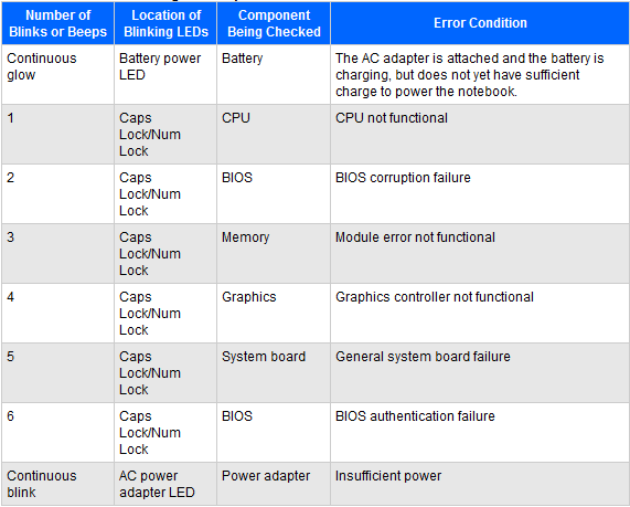

    So the symptoms are:
    1. Turns on by itself when connecting charger.
    2. Nothing on display.
    3. Caps lock LED blinks once every few seconds.
    As I know, CQ series has troubles with BIOS corruption. This blinking + no display is exactly the same that two of my CQ61 laptops had, which I fixed by reprogramming the BIOS chip.
    I have tried reprogramming this CQ57 BIOS too but no luck yet.
    Any idea where might be the problem or why does it turn on when charger is connected?

    Re: CQ57 205SR motherboard problem
    this common falut of CQ57/C58/G61/G62/HP630/HP650 the one blink
    of the cpu not fonctional; but i see that in all case the cpu is good; reflow the pch with the bga station, and the one blink will go
      Instead of reflowing/reballing, I would rather sell this machine.
      I don't think turning on by itself is a symptom of a bad solder so there must be something else wrong (too?).
