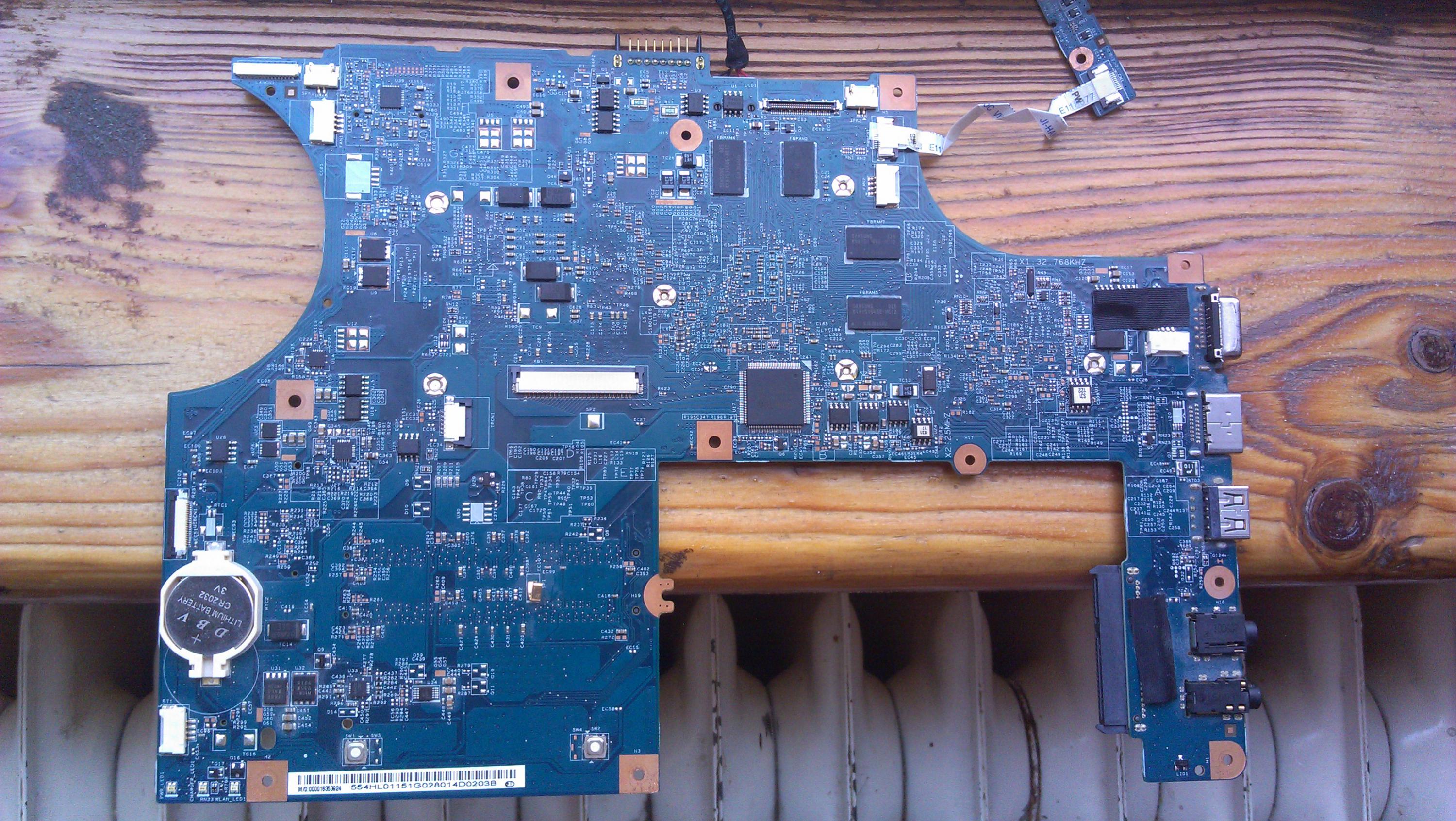

I need help with this notebook. Notebook is completely dead. No lights, no beeps, nothing. I measured some voltages on motherboard. 3.3V and 5V aux voltages are ok. I measured 0V on U27 - RT8223BGQW-GP pin 18 (S5_enable). I don't know what next I should measure. Can you help me?
Thanks for answer.
Motherboard: JM31-CP
Revision: 09921-3
Schematic: https://dl.dropboxusercontent.com/u/...5-1047_144.pdf
