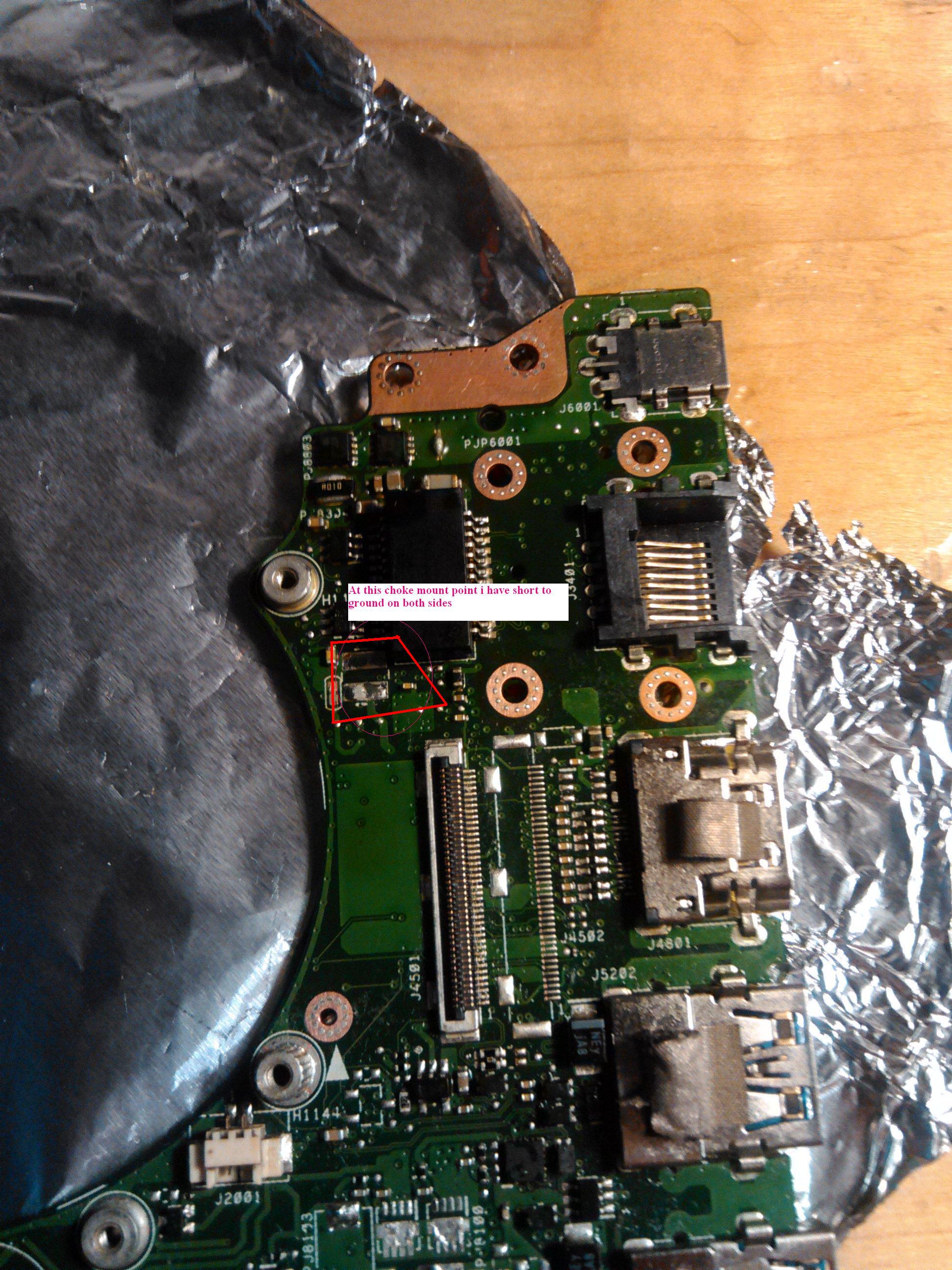

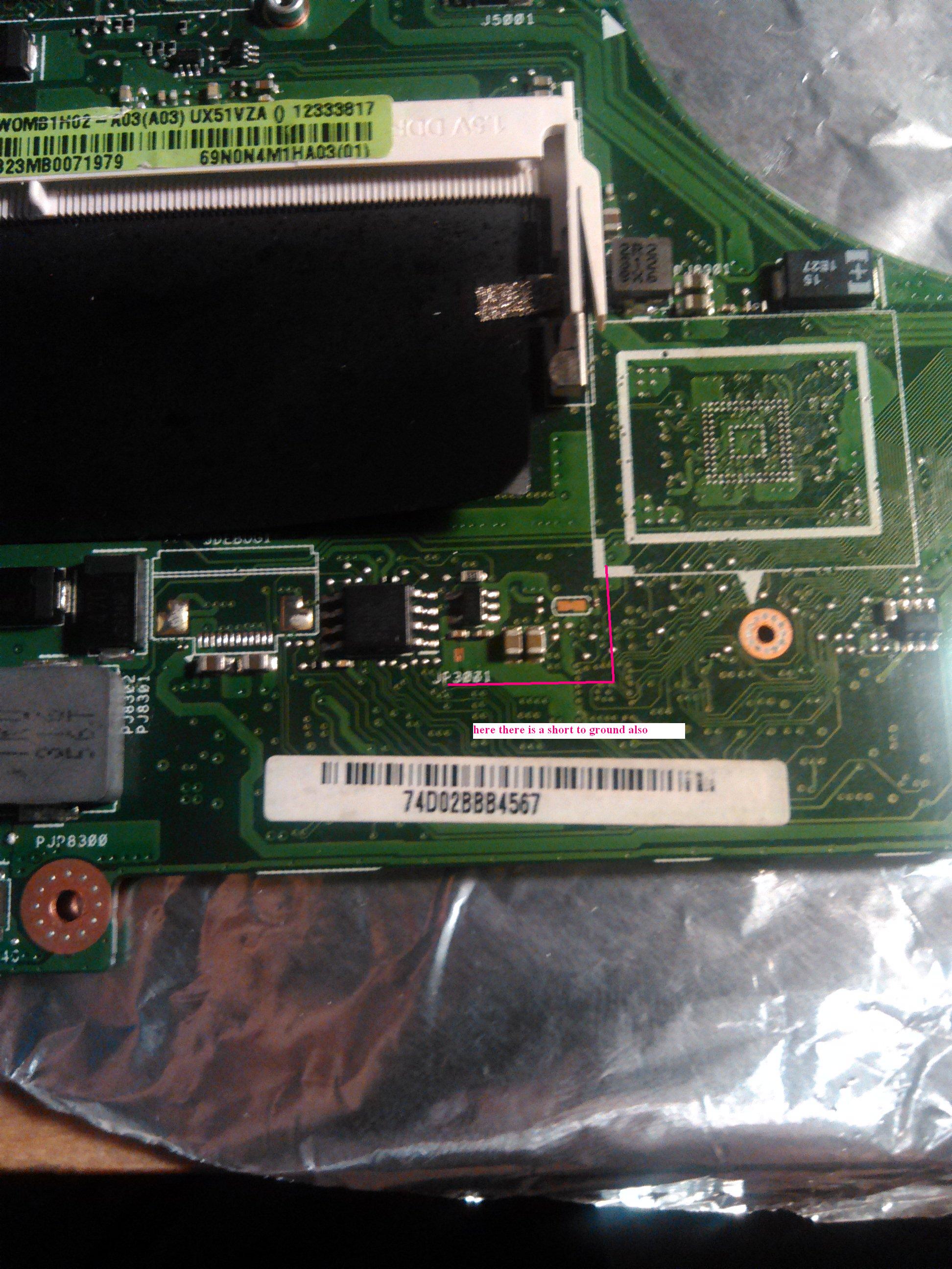

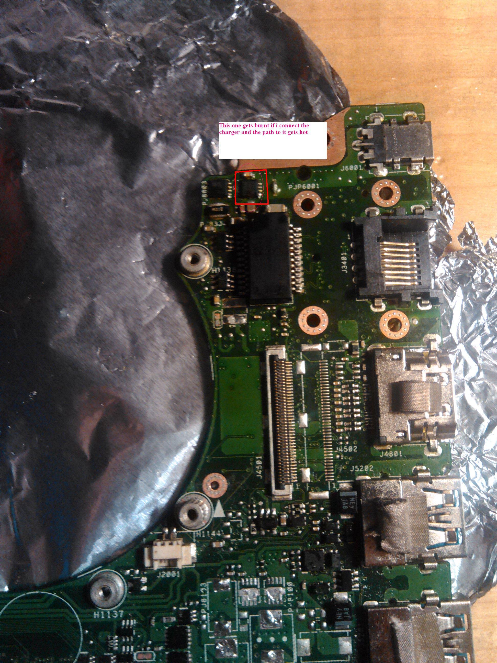

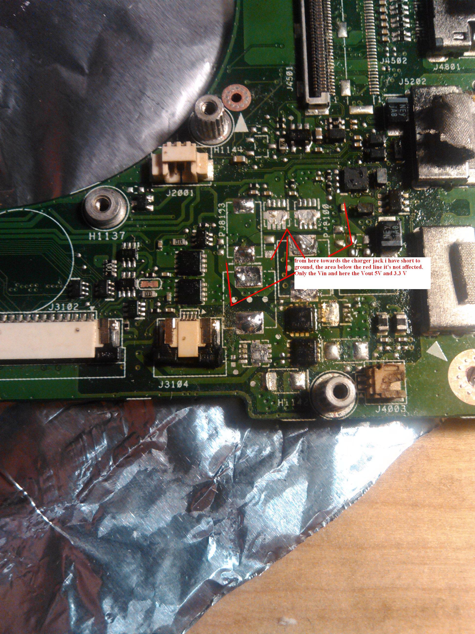

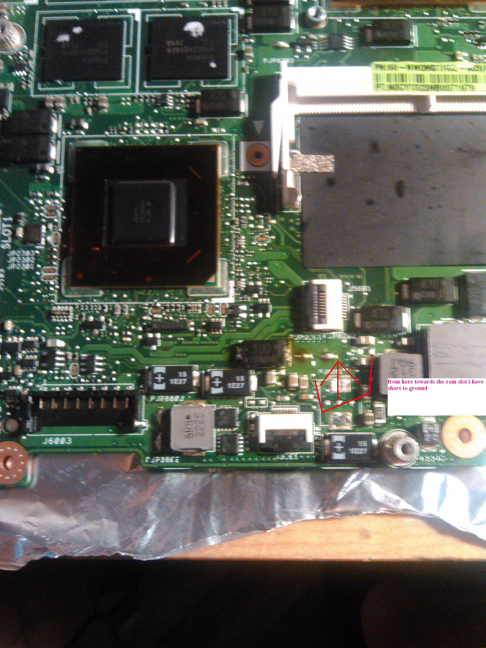

    I need some help in figuring out if the short i have on this board it's a short to general ground plane or it's a defective component somewhere in the positive current distribution.
    I have a short to ground from the choke near the charger input, a short to ground from the chokes for 5V and 3.3V, a short to ground near the BIOS chip, a short to ground from a choke near the battery connector.
    I attached some images with areas and an arrow that points the direction of the short. The RT 8239B present on this M/B it's shot, but i do not have a short to ground in that area, all the shorts seem to be on the Vin feed. If i connect the charger the path immediately following the charger plug get's hot and it blows the first FET as marked on the picture.
    Being unable to find a schematic for this board, things are somewhat confusing. I managed to find the UX31 schematic but it's not entirely correct, of course, for my case....
