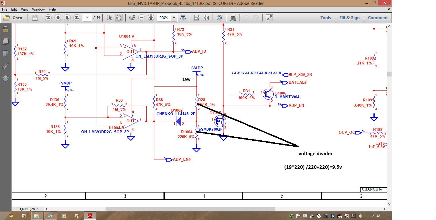

                        I've got wrong analyze at post#3
                        pin#3 high if there are charging process, i think it was ok.

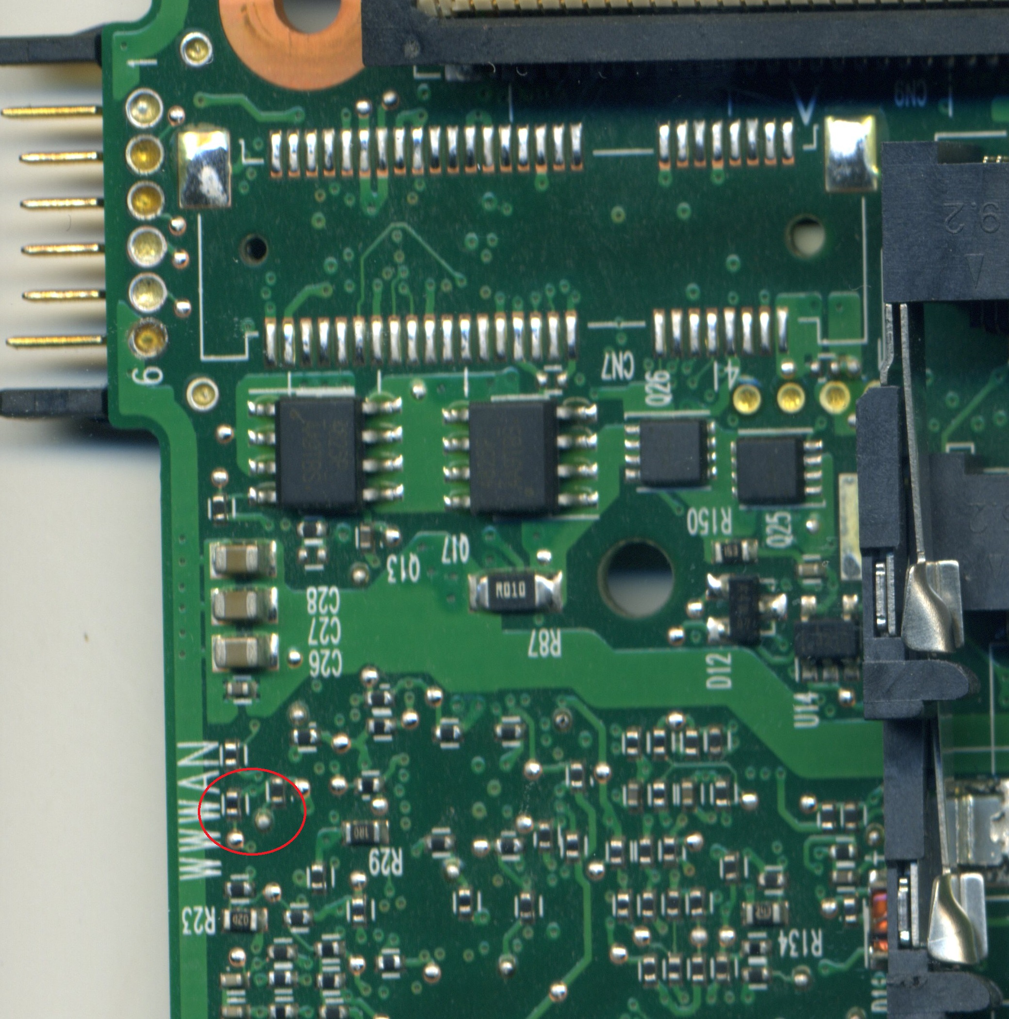

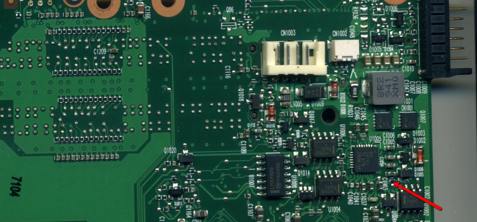

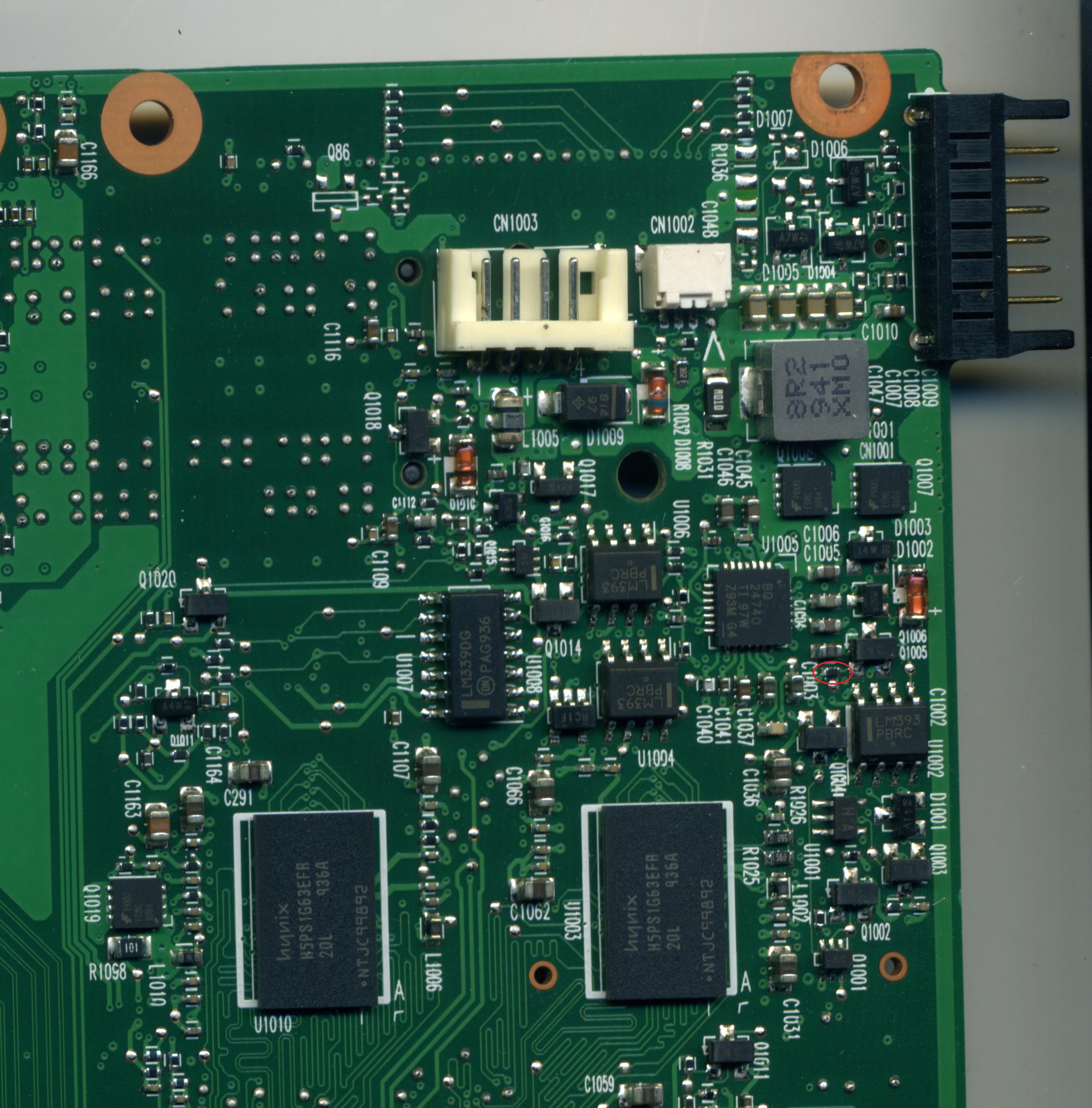

                        see attachment to find Resistor what i mean.
                        use continuity for trace connection with Q1005(pin#1), D1002, and LM393 pin#7
                        if short the R that we suspect, it make a sense there is 19v on that pin#4 q25..
                        maybe other expert correct me if i got wrong about this
                        link picture HD quality that i use for reference :
                        http://rusfolder.com/39487276
                        sorry for my bad english

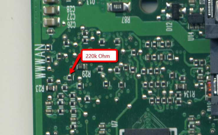

                            Re: HP ProBook 4510s power problem
                            i think i found one of those 2 resistor. I desolder it from board and it is 220 kOhm.
                              it is R1004
                                  non of them are connected to pin#1 of Q1005. I found one that is connected to pin#1 of Q1005 and it is 220k Ohm when i measure it desoldered from board.
