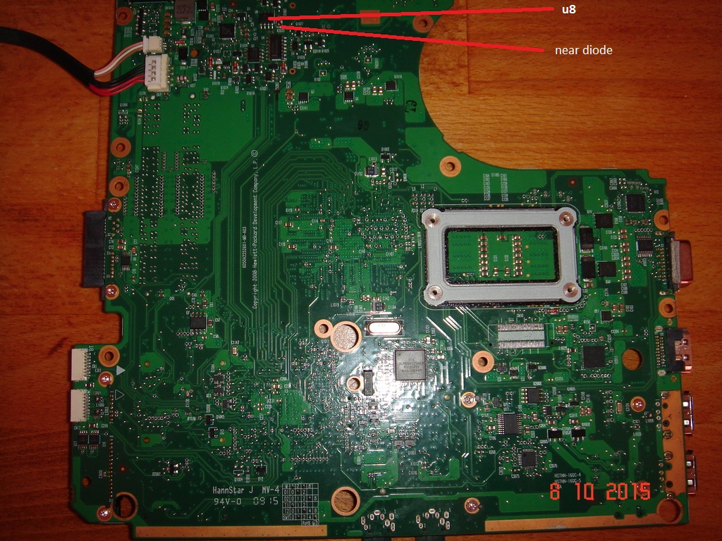

        Re: HP ProBook 4510s power problem
        I have this same laptop to repair !
        i have 19V on some points, but didn't find any 5 or 3.3V.
        No power on bios, so i still flashed but no change
        OP says that he solved the problem by swapping R29, i have spend some time searching for this R29, but i can't find it.
        Can any of you point me where to look for this R29 ?
        Thanks guys

            Thanks Buddy,
            Now I understand why I was having big time finding the components of this thread !
            My Mobo is similar, but not exactly the same !
            Here the reference :
            Do you know which component should I test ?

              #46
              look to post#22, download it the attachment. your working 100% same with schematic and broadview.
              so if you want to test component, compare it both the schematic invicta and zenith. i think how does those working exactly same. R29 on invicta, R2033 on zenith.

                #47
                R2033 is OK, but i don't have any tension on U1, U4 and many others on the same location !
                Do you have any other tips or components to check, please ?

                  #48
                  +VBATR got voltage 19v?
                  voltages on U10 all pin?

                        #51
                        I don't find this U10 !
                        What is +VBATR ? i've mesured all pins on the battery connector i have :
                        0 Volts on all pins.
                        Mesured all legs on Bios = 0 Volts
                        On U8 i have 19V on all pins except 1 that i have 0V.
                        Hope that you understand.

                          #52
                          - please look at page 4 on schematic +vbatr come out after generated from power source which was OK. whether from adapter or battery (+12v-19v)
                          - U10 TPS51125 PWM for 5v and 3.3v (page 7)
                          - from your statement above its seem U8 was broken, every pin has 19v except 1 0v (i guess was ground). should try to follow advice from saularciga to change the LM393, don't forget check resistor around it. (voltage divider:R1241,R1239)
                          - check resistance every mosfet (page 5 and 6) S to D, D to S and respect to ground

                            #53
                            Well, I must be blind or we are talking about different mobos !
                            I can't find, U10, LM393, R1241 or R1239 Lol !
                            Anyway, I'm posting 2 photos from the hole mobo, maybe you can point where are those ?
                            Thanks a lot

                              #54
                              EDIT: i finally found the U10, it's a multi leg chip, but i read 0V on all pins, still not find the rest !

                                #55
                                please use the boardview (6050A2252601) as i mention in post#46. locate at post#22. open it with place5-f2b.
