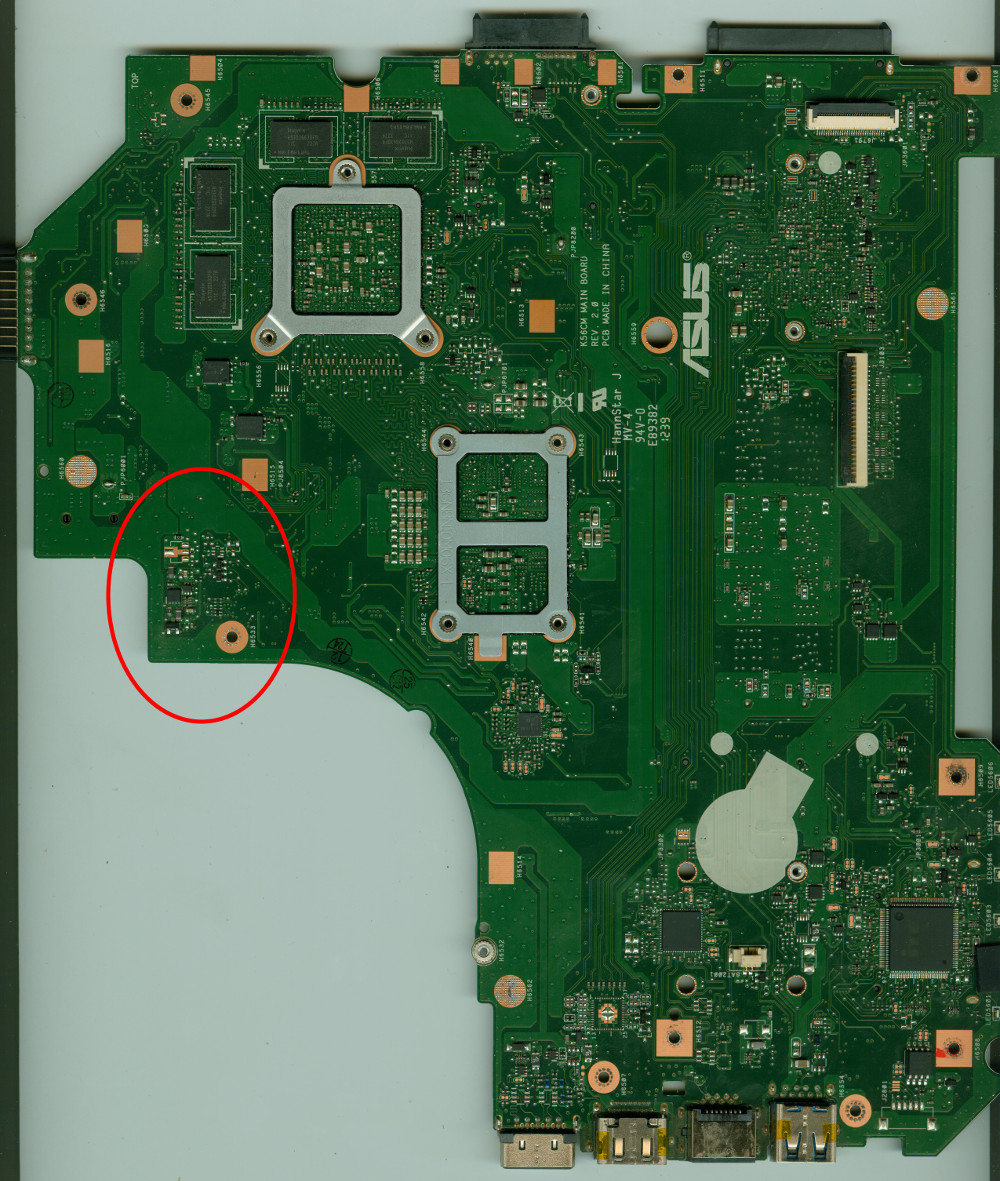

    Hi guys,
    I have a problem with my Asus R505 laptop, my screen wires are damaged since some days (bad contacts when moving the screen...) so I was no more using ma laptop waiting to receive the new cable.
    Unfortunately yesterday I have restarted it to connect the display to my TV but no display on TV nor than on the computer screen.
    I've move the screen and heard the so characteristics noise and smell of the burning electronic component (you know, the little "pschiiiiiittttt"....
    I've removed the charger, the battery, and opened the PC and found the problem: a diode (or what looks like) on the backlight inverter is burned... it seems to be the only burned part, I suppose that the backlight wires were damaged inside the cable and have done a short-circuit...
    My problem is that now I'm no more able to read the reference of this component, and before to replace it by a standard shottky diode I prefer to try to find someone able to give me the correct reference...
    So my question: Can someone tell me the reference of the component burned on the photo:
    For information it is under the motherboard, there is a black sticker over all the back of this side, and the component is located just under the screen connector.

    Take a closer photo and also another of the whole of the board pointing the burned ic.

      Re: Asus R505CB (K56CM motherboard) backlight problem
      link image HD quality:

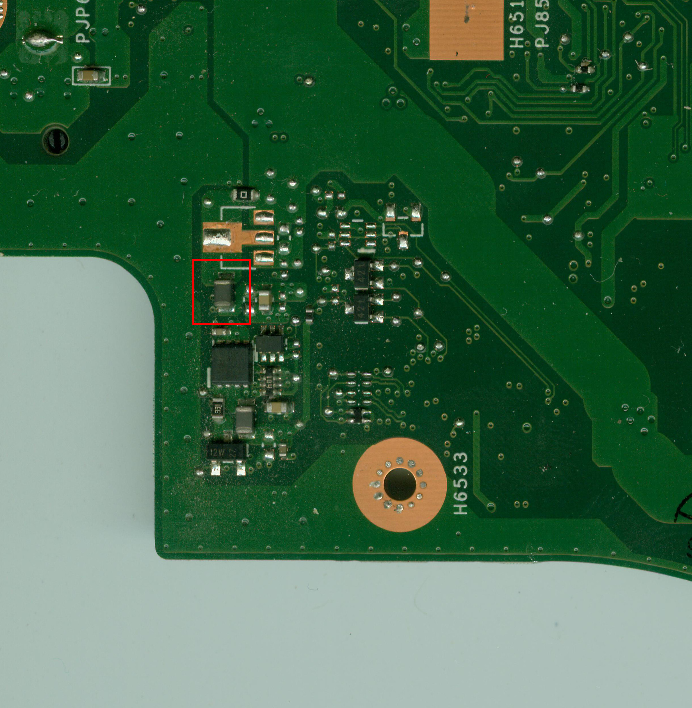

        That's a coil. Probably you will need one 70Ohm/100Mhz
          Thank you both for your help,
          It look evident on your picture that it is effectively not a diode and I better understand if it is a coil why she had burned on a shortcut...
          I've put the copy of your picture with the component localized.

              its a coil , you can simply makng a bypass to it , i advise to add another coil even if the Hr are bit diferent ..

                      I Have the exact same MBoard on my bench, it's a coil that is burned there.
                                  ok it might get handy to some of you , backlight problems usually due to bad LED_VCC_INV
                                  this is due to bad resistor near (R4609) one side is AC bat sys 19 volts and outher side is the ledvcc inv , and if you notice you will see around 1 to 3 volts in my case was around 1.69 when it should be 19 , cheking resistor it says 000 (meaning short resistor , or 0 ohm ) so it should not have any kind of resistance , replacng it with a 0 ohm resistor , made the machine working , also notice that +5vcam , also need to be replace since you're gonna test it and notice there is no continuity in this 0 ohm resistor .
                                  hope it help someone in the future
                                  location of the resistor is bottom side of board , near the place were the lvds socket is but on oposite side . with bdv is easy to find net names and chek wich one im speaking but if you look carefully you will notice 2 resistors with 000 or 0 , and they should make continuity if not then replace
