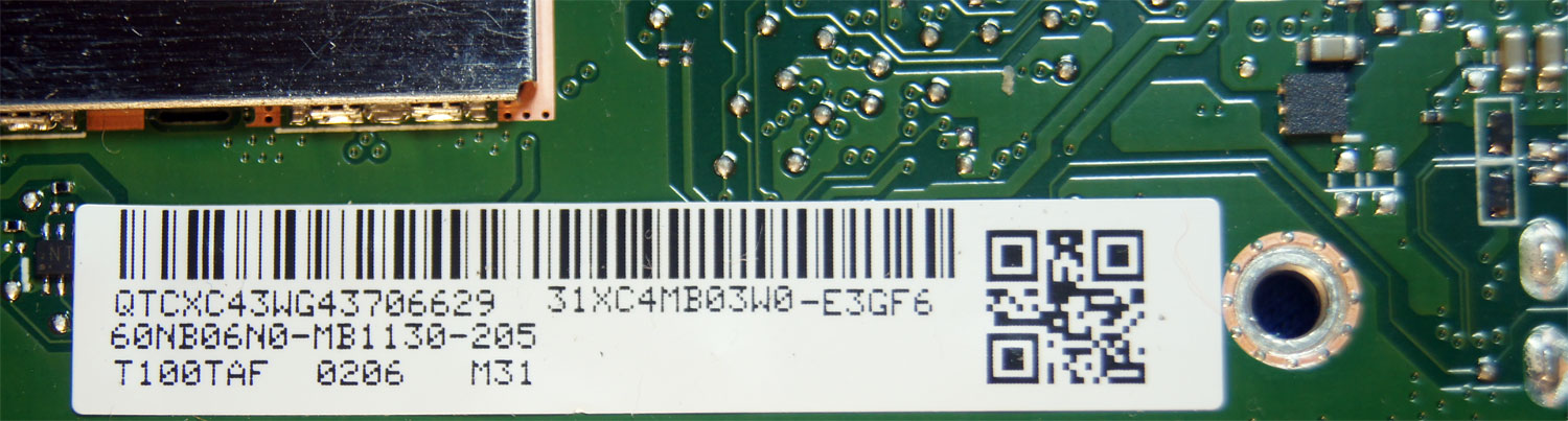

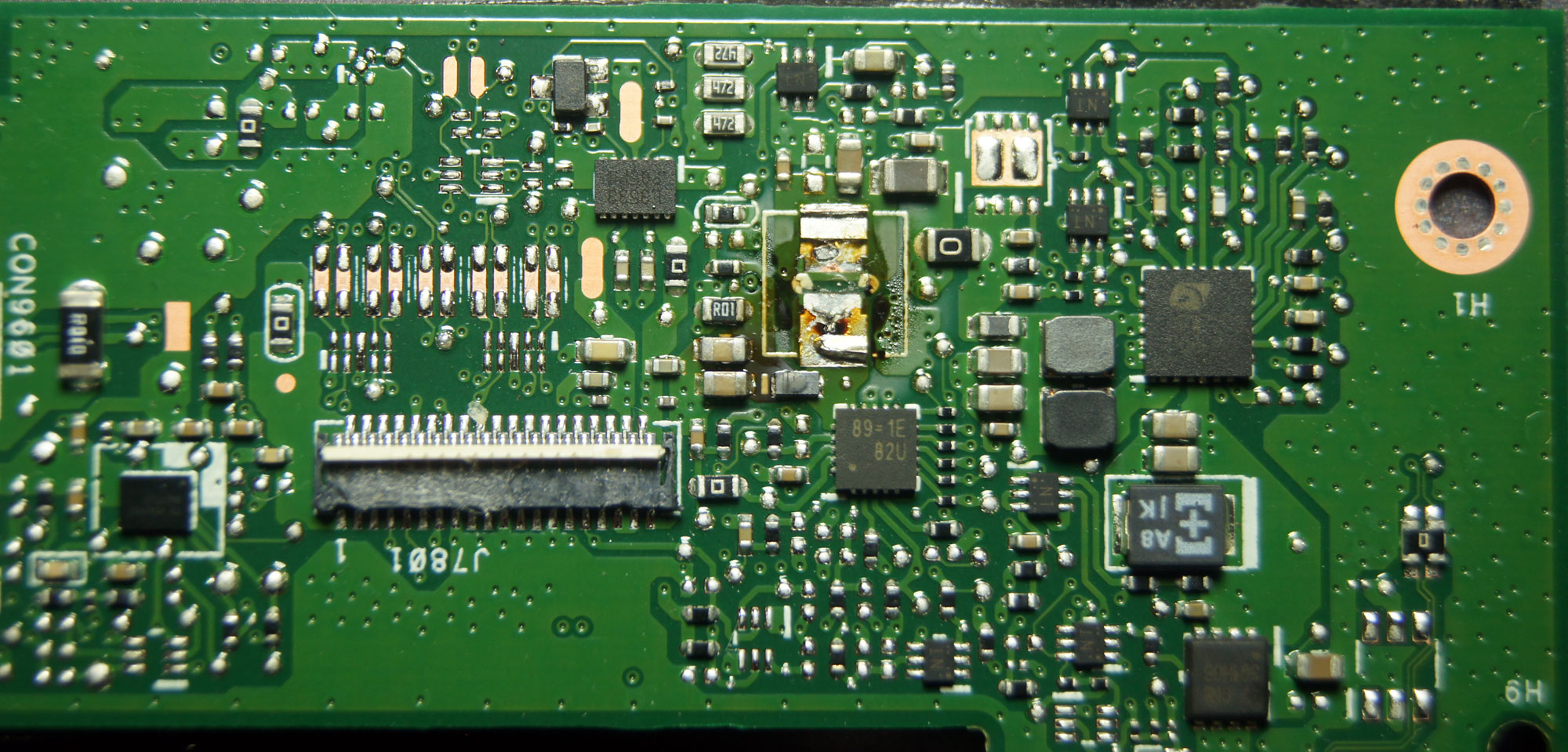

    1) After one month of usage with windows 8.1, monitor turn black and won't turn on. I fixed this. Opened the back of the case and removed battery. After the battery was placed back Transformer worked one week.

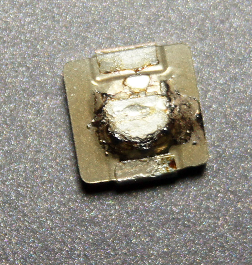

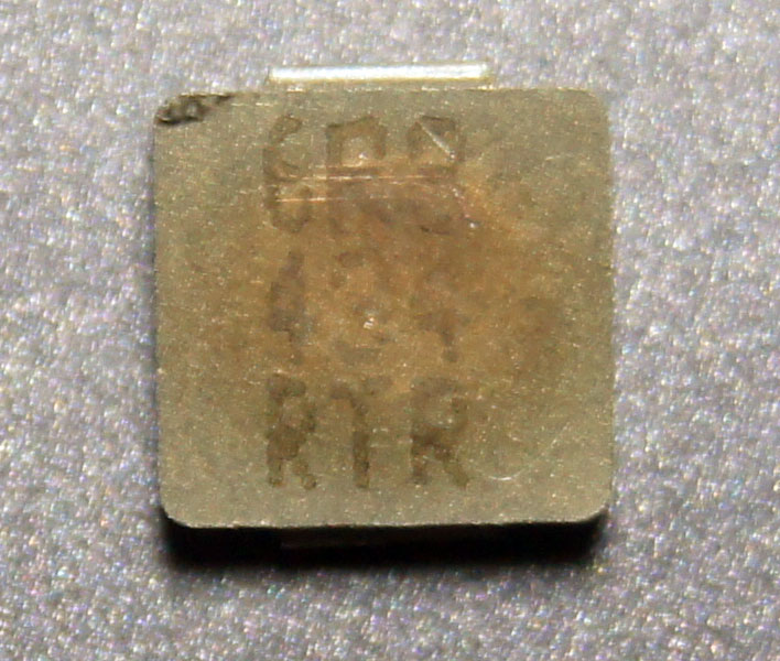

    2) Then suddenly almost the same happened (monitor turned black and won't turn on). But this time I removed micro SD card and heard windows sound. And if I put it back there was a sound again. So I thought that there were some trouble with monitor. I opened back case of tablet and saw that something with the name of "6R8 434 RTR" was out of order. You can see the attached pictures. I am wondering what is that square thing and if it can be fixed. I do not trust engineers here as they generally do fry the board with their irons and surely won't fix it. I am from Uzbekistan and sending that back to ASUS will cost like 100-150$. I was fan of ASUS devices but now wondering of the quality ASUS provides as that thing worked only 2 months. I bought it as a new one not refurbished.

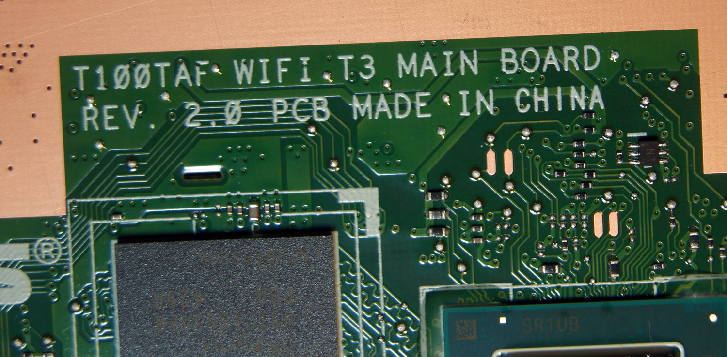

    Motherboard: T100TAF WIFI T3 MAIN BOARD REV. 2.0 PCB
    I was told that the broken square is 6.8 uH coil
    Is that device can be fixed?

    well you need a new inductor (that's what it's called)
    but as you said - it's a coil.
    i cant see it burning like that unless there is something else wrong!

      It could be the only culprit, the fabrication process isn't perfect and sometimes duds come out.

        Check the diode outlined in red. It may be shorted.

          look about 1oclock from the burnt mess.mosfet missing?
            Looks like a normally un-populated part. Look, there is even a 0 ohm shunt jumping the FET pads.
