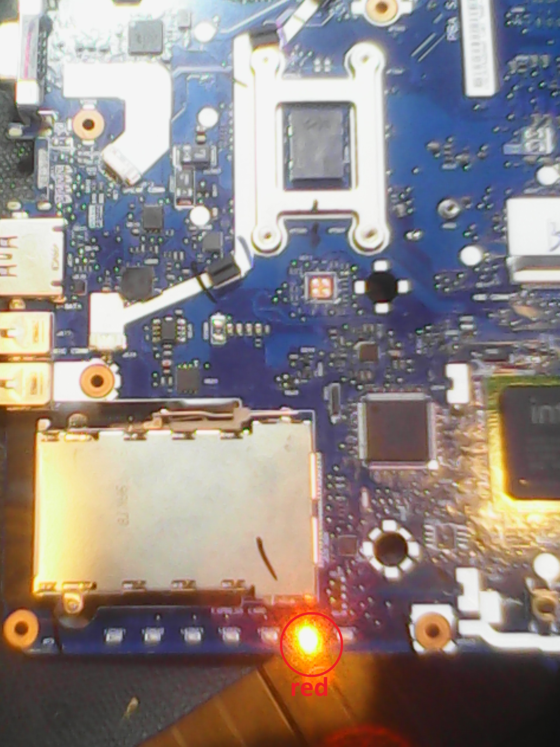

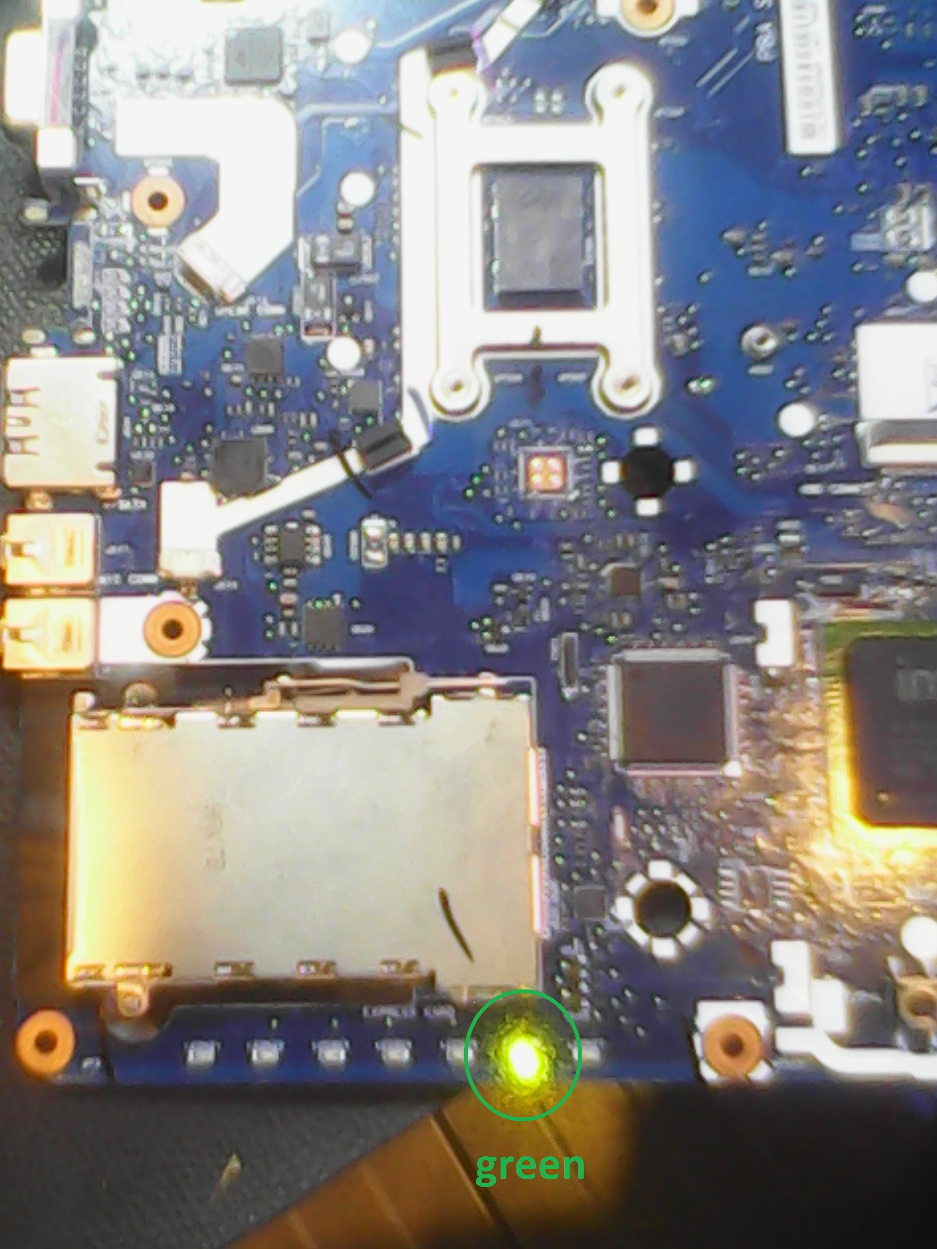

    hello guys another problem again.
    i got samsung R420 it just blink when you plug the charger. no power when press on.
    i checked all coil. did not find 5v and 3.3v

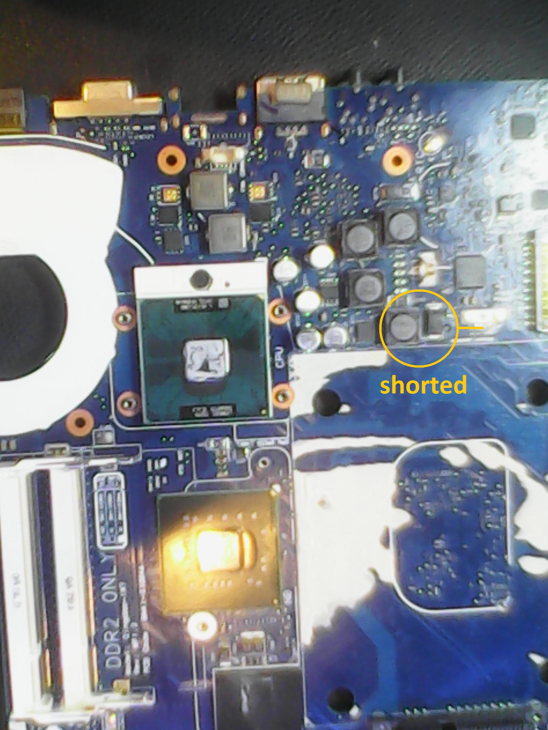

    i found shorted coil it reads 0.004v from pin to ground. and 330uf caps i removed and still shorted pads.
    dont know where to trace the path cos i dont have diagram.
    pls help...

                                  maybe you should eliminate shorted part first. can you tell which coil is shorted?
