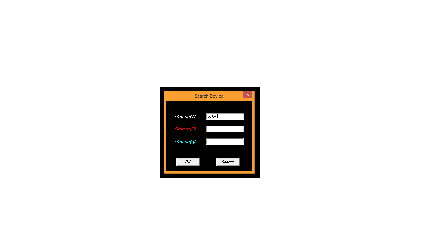

    I also downloaded the ZE7.brd file for this along with eagle but was not able to get the file to open in eagle. Any help would be appreciated.
      Eagle is a PCB design tool, and expects board designs it has made itself.
      Your .brd file will be a totally different thing, try the boardview software here: http://laptopserviz.bg/enview/bvsoft/

        https://www.badcaps.net/forum/showth...753#post536753
        open it with boardview4
