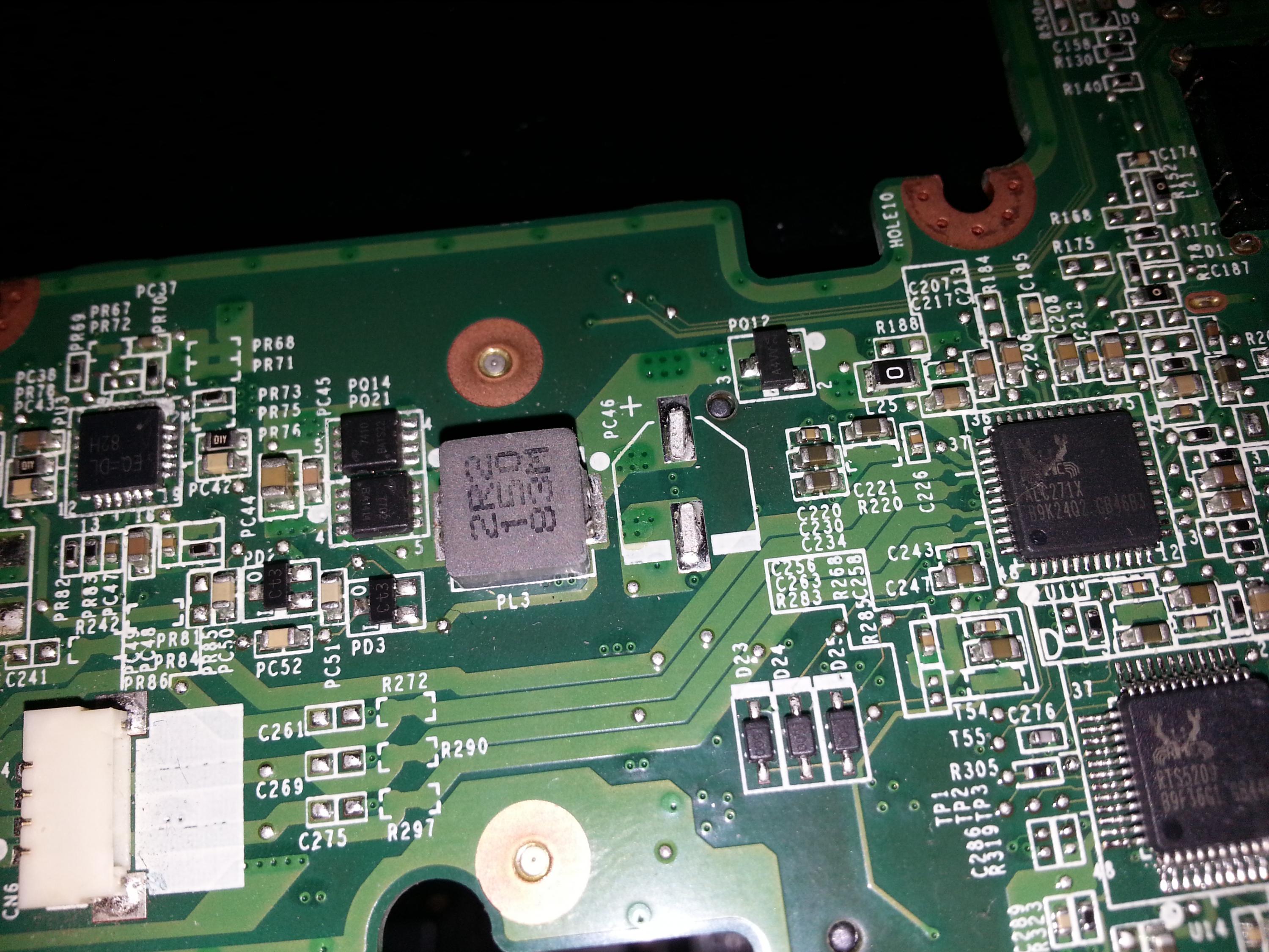

    Re: Acer Aspire One D270 Netbook has no Power or Battery charge Indicator
    see attached photos

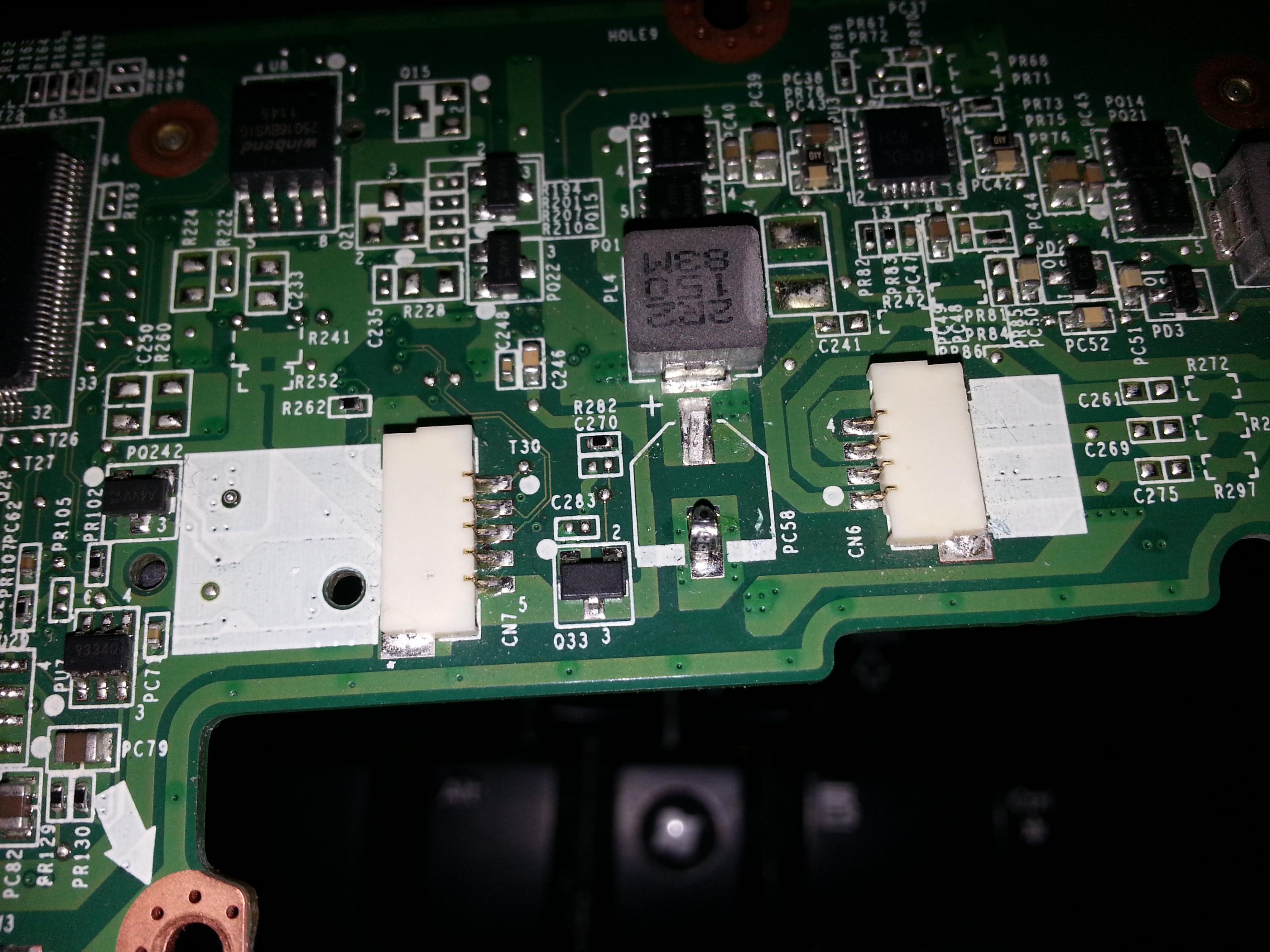

      can you post a picture of the bottom of this board
        OK I can see on the pads where the capacitor leads have been ripped out of the solder, on PC58 it looks like one lead is actually still half there.
        You need to put in new capacitors and then continue troubleshooting from there if that doesn't fix the problem. Make sure the capacitors are Low ESR too.
        Might pay to take some more photos of your board and upload, in case there are any other problems like that.
            verified by some other pictures that I found on eBay the two of the "can upright" capacitors are missing from this board. Not sure if that would affect the operation of it or not.
              Could not having those two caps on the board cause problems?
                  Yes, if they could get away with not having them there and save money, they would.
                  I don't know exactly what would happen, my guess is without those capacitors to filter the ripple\noise from the switching converter, there are voltage spikes coming through which trigger OVP (Overvoltage protection) on those rails and the controller is shutting down.
                  In any case, without those capacitors, the rails will be severely out of specification and won't work to power anything properly. Those capacitors NEED to be there. Put new ones in. It may just solve the problems.
                  Do you know how they went missing to start with?
                    I'm guessing who ever ripped this machine apart did a real bad job. It came in a box like a pile of junk. The fan was destroyed so I have to replace that along with some missing cables.
                      put in a couple of caps I found from a laptop. no change in the problem though. still on voltage outputs from pu3.
