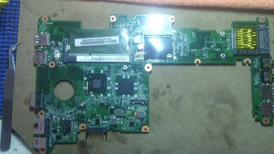

                                        • fddizon
                                          • Sep 2011
                                          • 555
                                          • Philippines
                                          #40
                                          Re: Acer Aspire One D270 Netbook has no Power or Battery charge Indicator
                                          TFS2014,
                                          try to locate this ceramic cap. it might be the same faulty part..
                                          see picture attached...
                                          ceramic cap near a coil bottom right red rectangle
