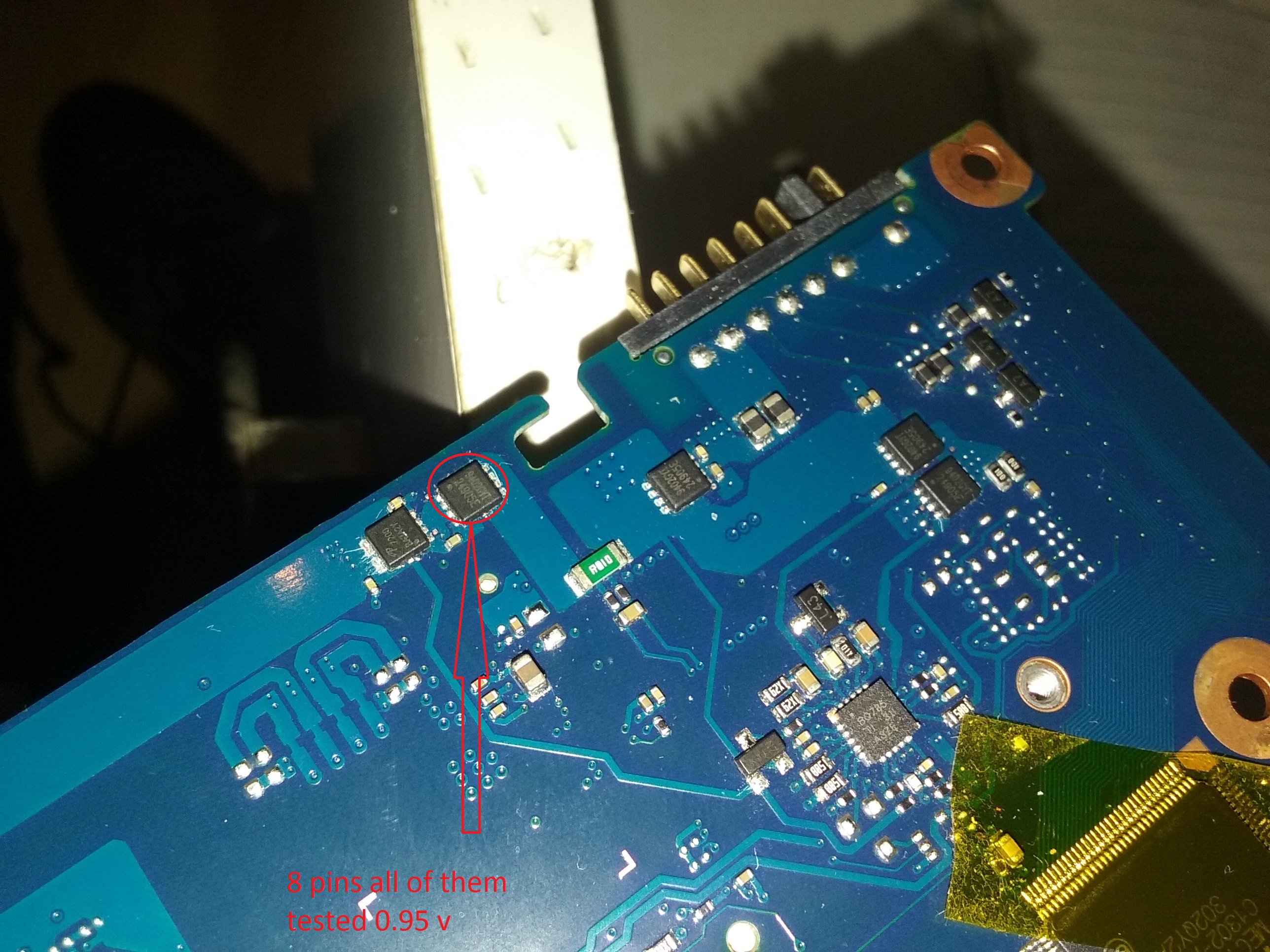

    Hi need help with this laptop with battery inserted laptop start normal ,charger connected and battery start normal and lights for charging is orange color not sure is that mean that charging battery or not ,without battery wont start .Dont have shematic, charger tested ok work on another samsung laptop .

          Re: Samsung NP3530EC wont start without battery
          do some probing manual without schematic.
          check for some fets that are from dc jack to charging IC
          because now its going straight to BAT line
            Thx I do some of the check all have voltage no shorts ,one thing is make me bother on battery connection 2 pins have only 1.05 V should be 3.3V maybe ?
                check mosfets in between dc jack and charging ic
                  see the picture above i did
                    Hi
                    try to
                    bypass the 2nd mosfet in 19v line , if powers on without bat change the 2 mosfets.
                      Try and still same changed with another one from second motherboard
                          Originally posted by makhlouf
                          hi i have same laptop and exact same problem if you have fixed your let me know the solution thanks much
                          Replace second mosfet see picture on post #6 fisrt mosfet pin1,,8 19 v , second mosfet pin 1234 19v pin 5678 0.95 This mosfet from my experience need to replace
