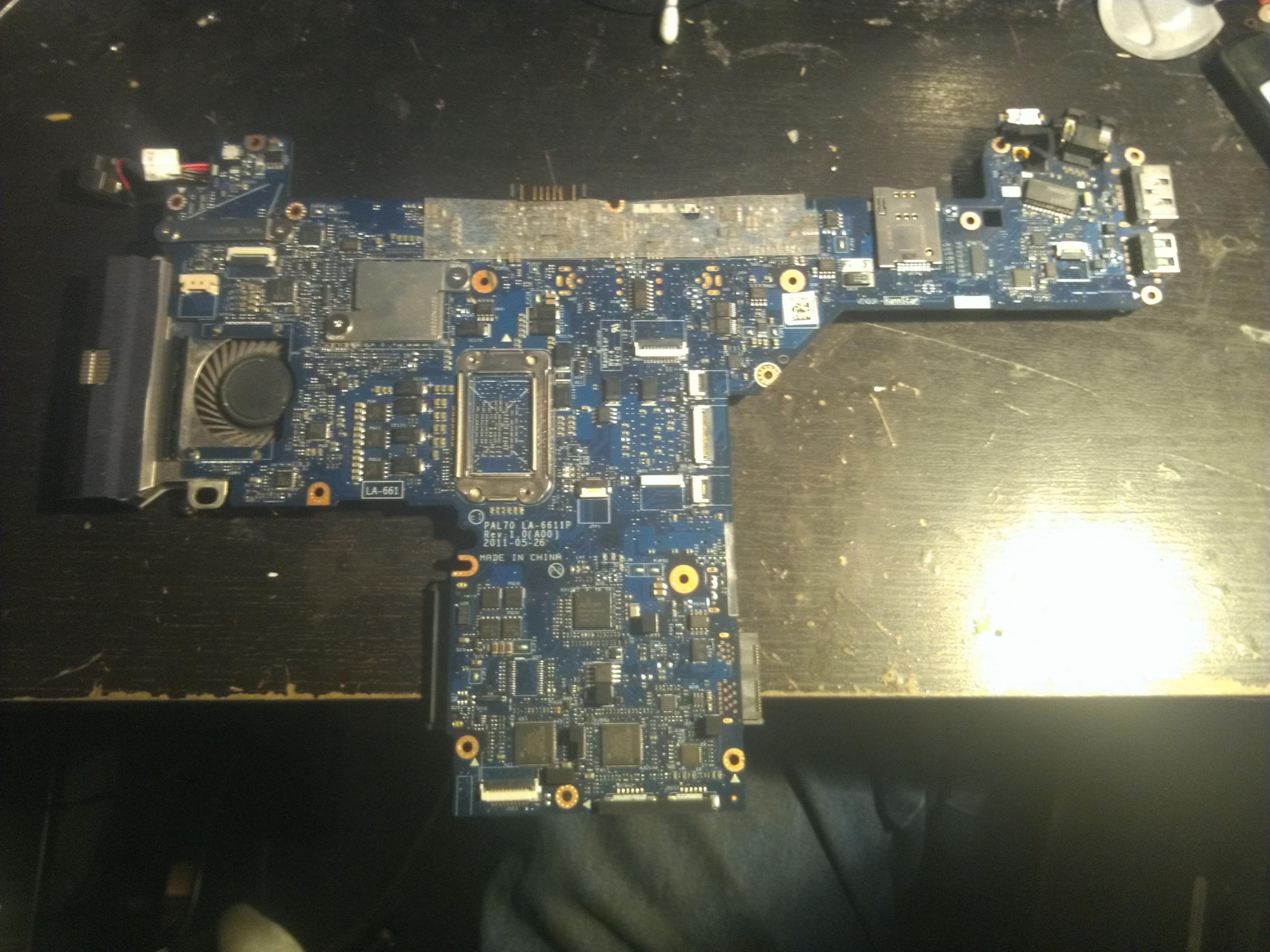

    Just picked this up from the trash @ work.
    Dell Latitude E6320. Unsure of battery charge level. I *DO* have the docking station.
    When plugged into power adapter (even my wife's - known good), I get no lights from the laptop. Removed battery, press power button - still nothing.
    Tried the same procedure using the docking station to eliminate DC Jack wire/solder issue, same exact results.
    I've removed the mainboard from the laptop and see nothing out of the ordinary. What are some ideas I can try next?

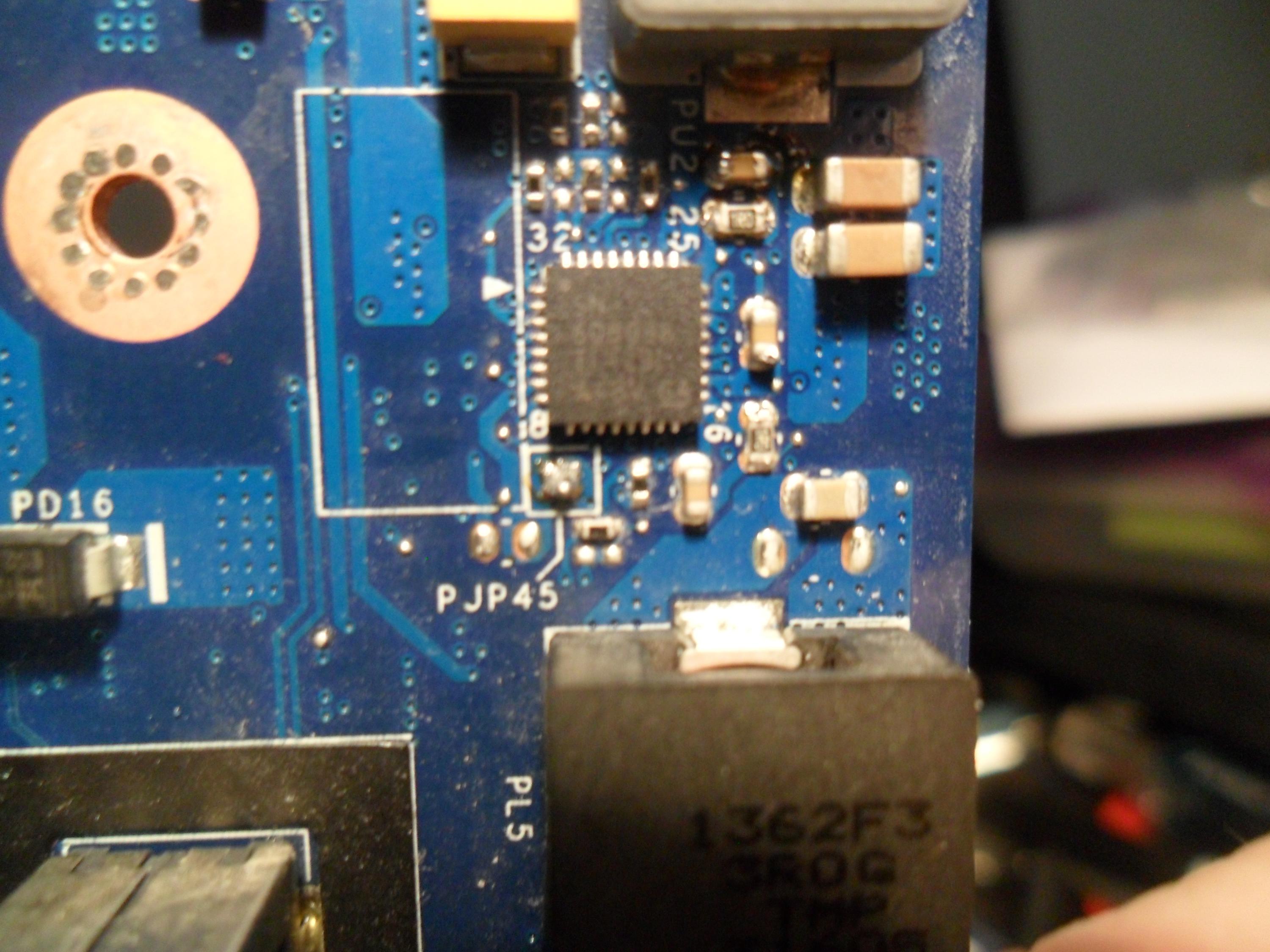

        Current path:
        1) Battery and AC adapter supply +PWR_SRC
        RESULTS: GOOD
        PJP44 (+PWR_SRC) - 11.1V with only battery, 19.6V with AC adapter plugged in
        2) IC "PU2" takes +PWR_SRC and turns it into +5V_ALW, +15V_ALW, and +3.3V_ALW
        RESULTS:BAD
        PJP49 (+15V_ALW) - 0.0V
        PJP45 (+5V_ALW2) - 1.5mV(essentially zero)
        PJP63 (+3.3_ALW) - 0.0V
        Closeup of PU2 attached.

                      Re: Dell Latitude E6320 - Completely dead, no {lights,fans,CPU heat}
                      Seems like a spill victim from 1st closeup of PU2.
                      PU2 should output voltage if enable signals are present and VIN is present.
