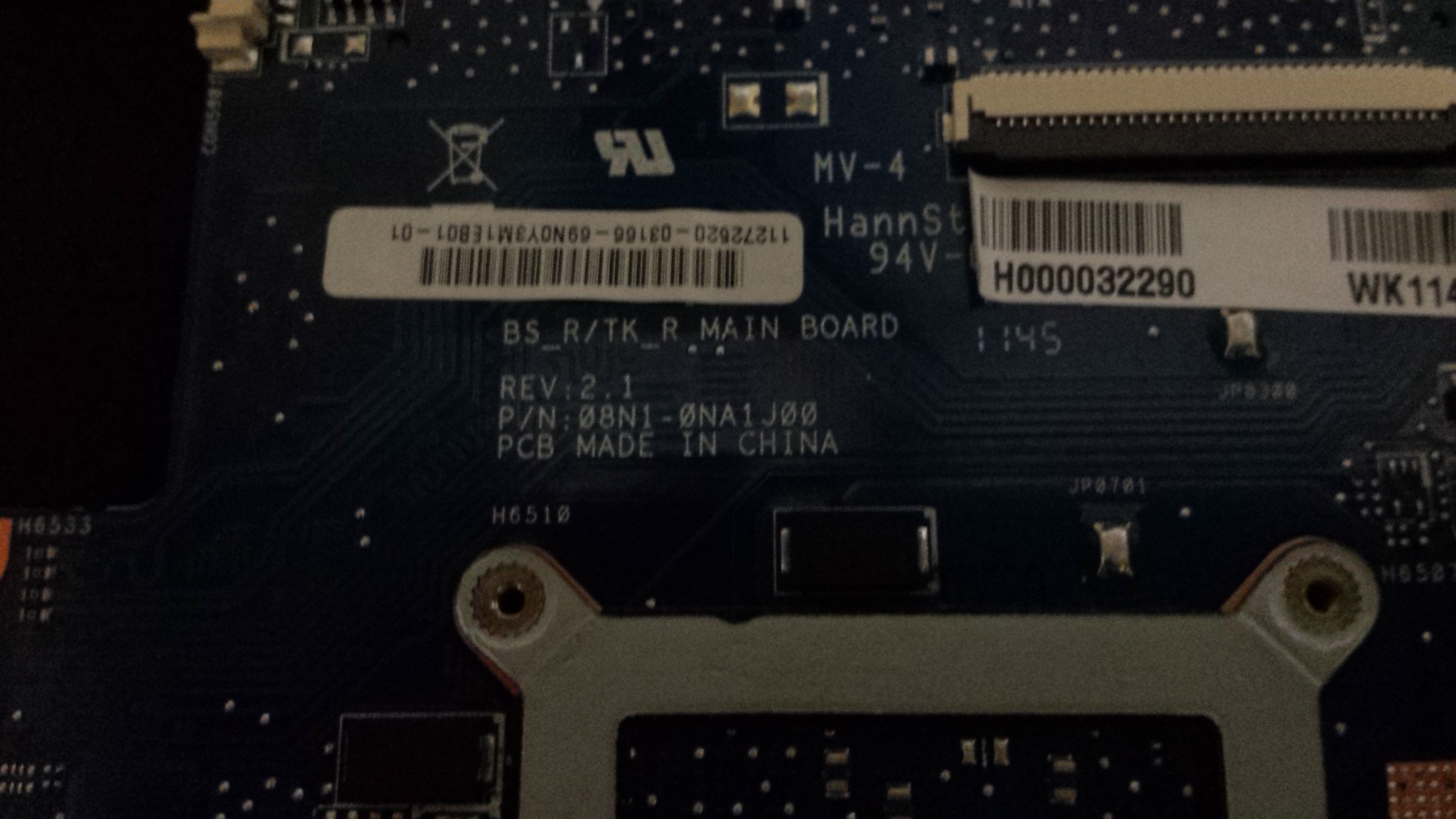

    Have a Satellite L775 Intel board with a white screen. When I first acquired the machine about a 3rd of the lcd was a different shade. Then about 2 days later the screen went completely white. External monitor has been fine all along. Voltages at LCD connector on board are as follows:
    1. 19
    2. 19
    3. 3.3
    4. Ground
    5. 0
    6. 0
    7. Ground
    8. 0
    9. 0
    10. Ground
    11. 1.1
    12. 1.2
    13. Ground
    14. 1.7
    15. 0
    16. Ground
    17-20. 3.3
    Have not been able to get a hold of a schematic for this board, heard it's a Pegatron that hasn't been released. Flying completely blind with this.
    Question is, is this anything but a bad video chip and therefore a reflow attempt?

            Re: Toshiba Satellite L775 white screen
            You can try just hot air, to see if he returns image, without flux paste, only air
              Beed a better picture of the board and is there a panel board on th epanel
