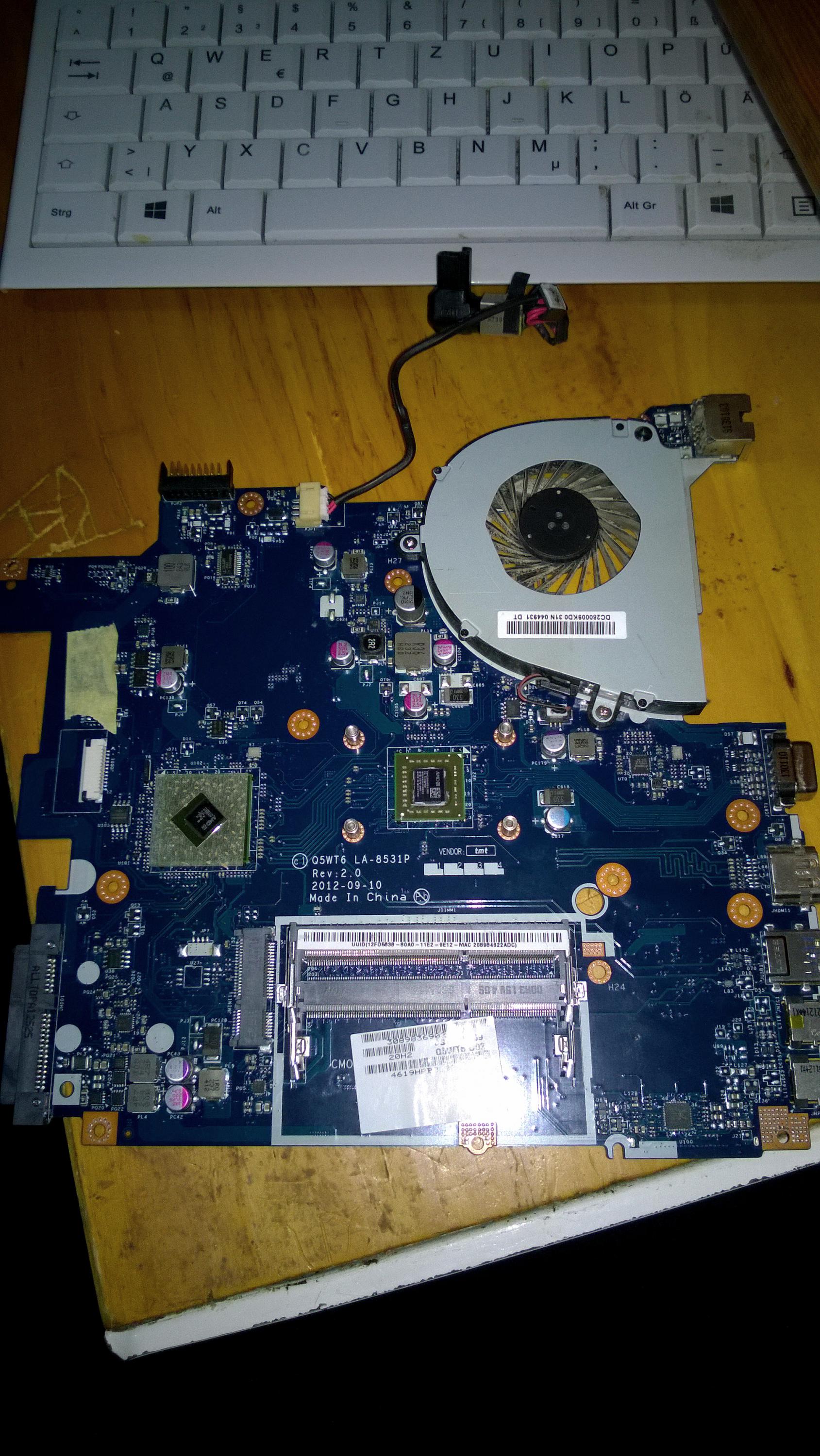

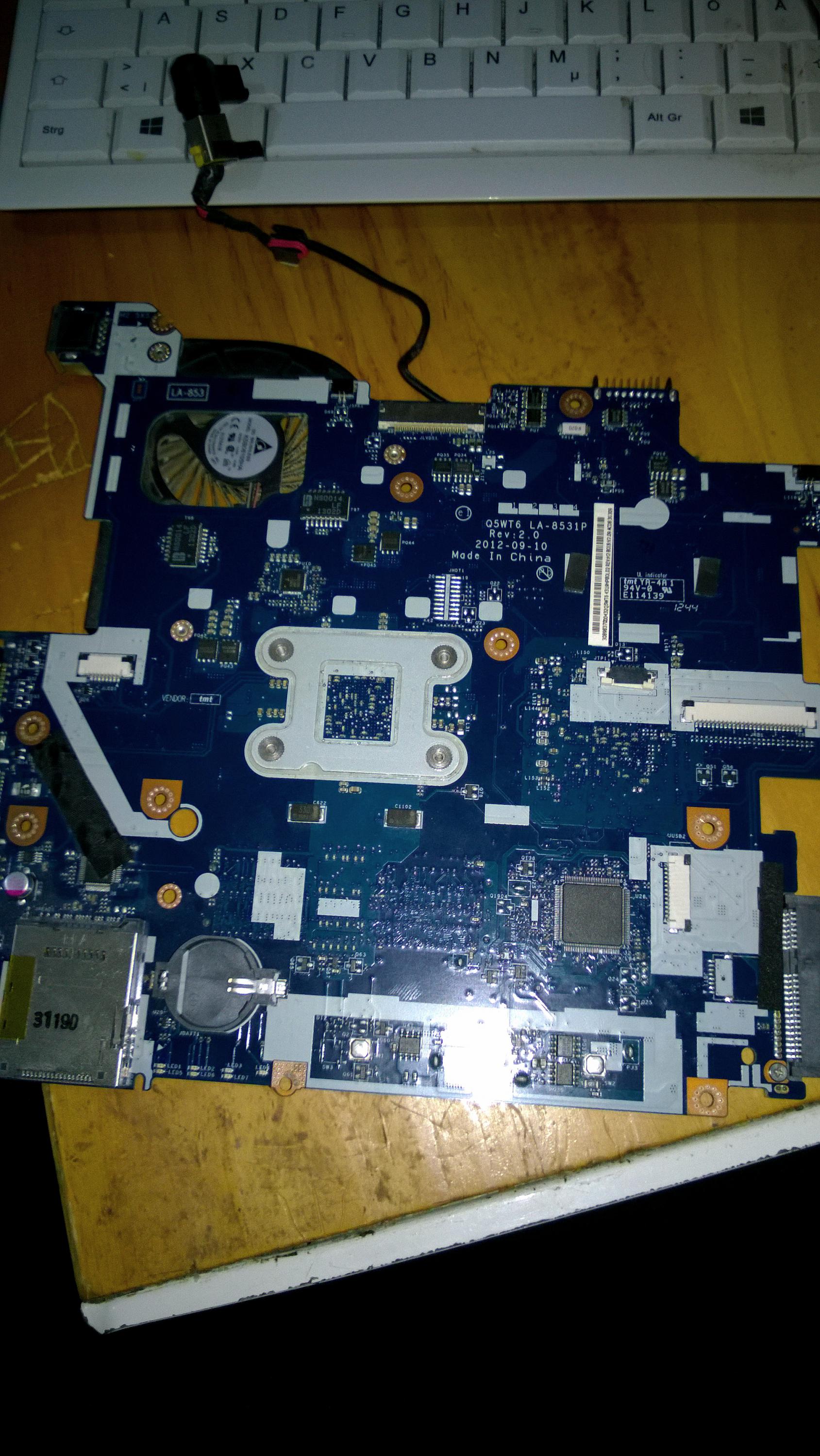

        can you post photo of the mobo both side top and bottom

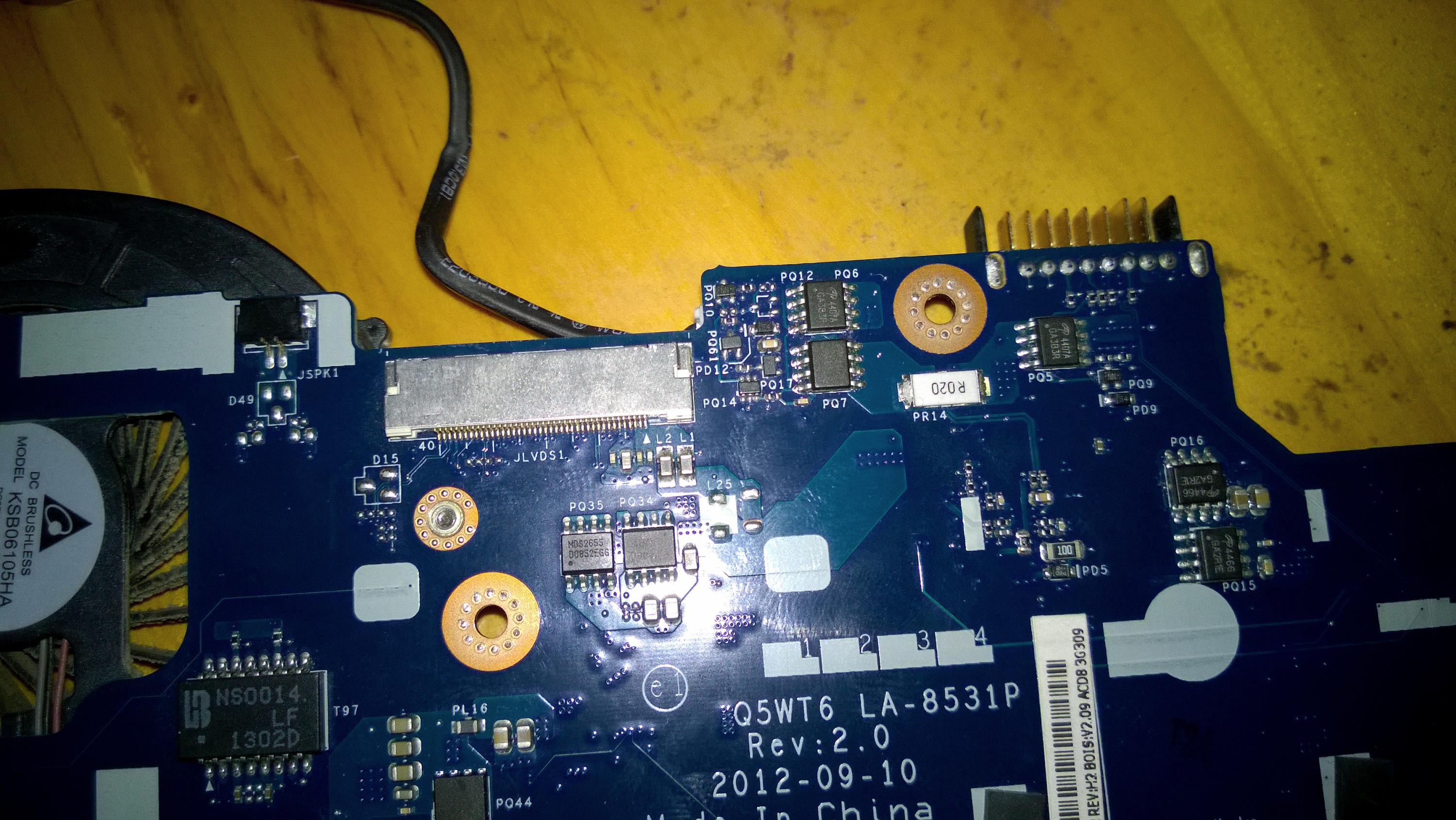

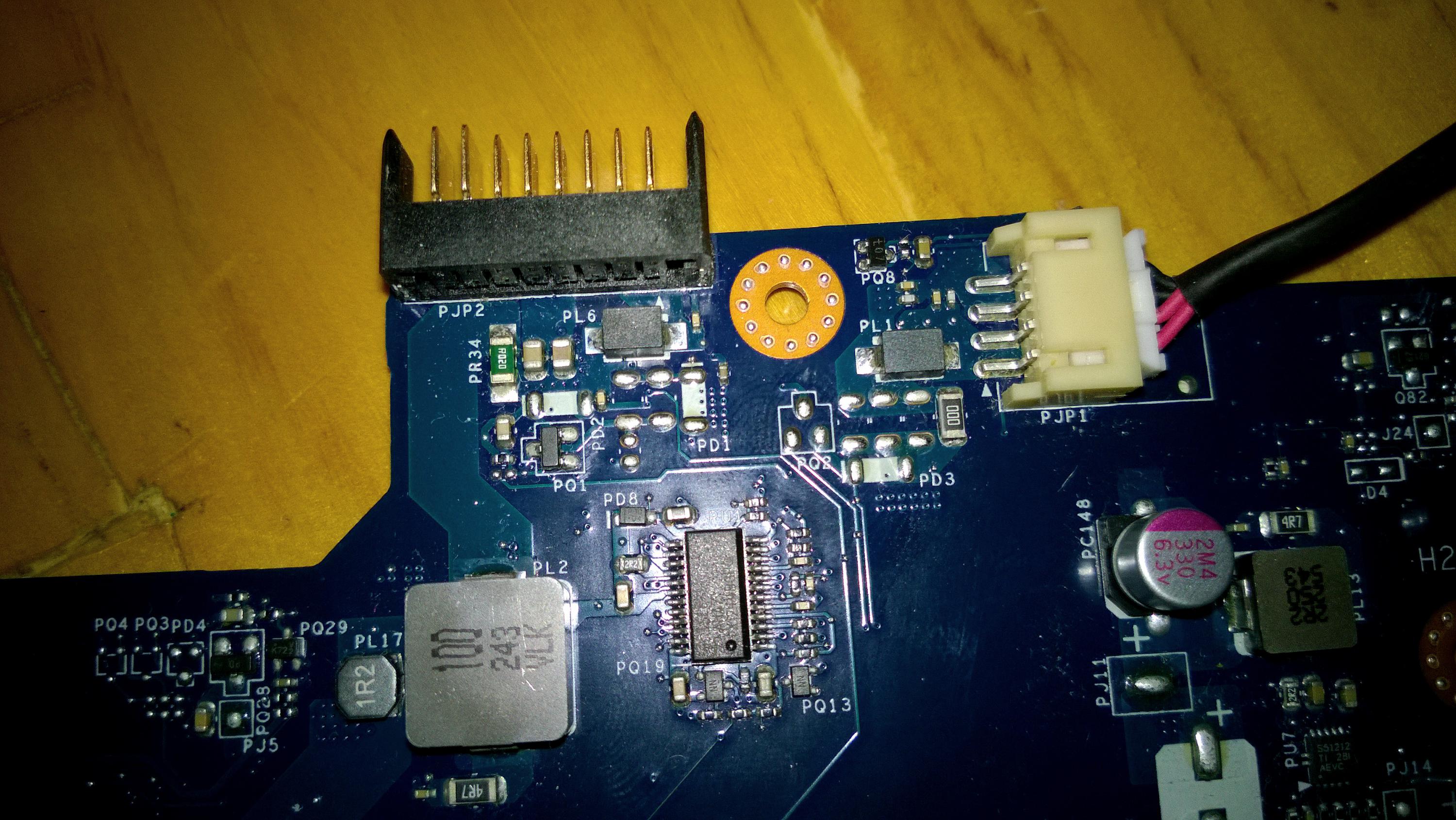

          Thanks for the schematic, now here are the pictures from the motherboard.
          I am currently thinking since (when I plug the adapter in) the CPU starts heating, it will be difficult to measure anything since I risk killing the CPU?
          The pics as following (2 from sides and 1 on the PQ7 and 12 which are heating).

            Re: Acer E1-531 won't start
            so?
            did you test those fets? are they bad or there is a short on the pads?
              Just took off the PQ7, pads aren't shorted.
              Wanted to ask, never tested P-channel fet's is it same as with n channel (puting + to drain and - source to test if the device is off in diode mode).
              Frankly my diode beeps all the time, which didn't happened with n channel shall that mean the fet is shorted? (When - is on Source and + on Gate I get 0034 on my multimeter while in other cases its 0 but with beeping means there is some short right?)
                Just tested PQ12 again pads not shorted, and this time it behaved like it should (not like PQ7) both are P channel. So I can safely assume that the PQ7 was shorted.
                Could I exchange the AO4409 with AO4407? Looking at the data sheets they are nearly the same.
