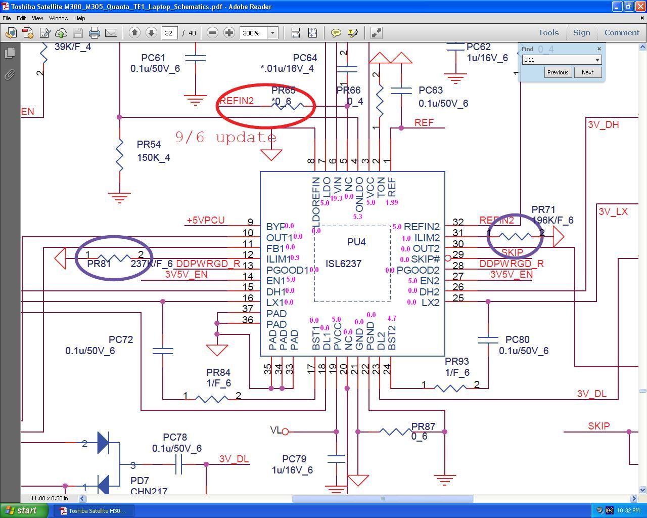

    Hello.
    Have this one with bad ICH. replace it but cannot get 3,3V and 5V from ISL6237. No short on rails, powers to chip looks good, EN1/EN2 ok, even REF signals is there. but cannot get it to start. I replace ic fron another board but still the same results
    Any help for this?

              Re: toshiba U400/M300/ cannot get 3,3 an 5V
              here u have all voltages in ISL6237
                You need to check the 3.3v and 5v SMPS rails with a DSO when power is first applied. The rails could be coming up then soon after going down because of some protection trip.
                I had something once where the 5v rail was getting up to 6v, then back to 0v because of a leaking high side MOSFET. This all happens in a few milliseconds.
                  Damn mate u have right
                  All voltages goes up but after 1-2 seconds goes down. I check pl9 that gives 1.05V and have 13ohm instead of 50ohm on the other board.
                      yes its that damn ICH. removed it and have stable voltages.
                      must find some working ic.
