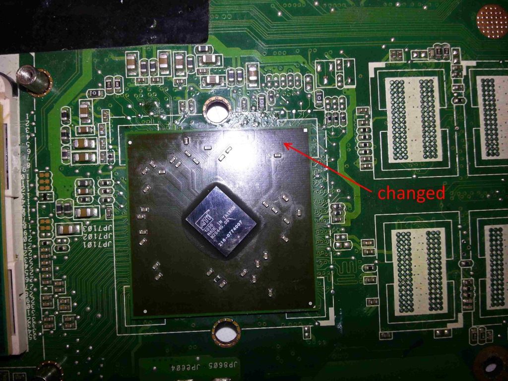

    I have substitute the old gpu chip with a new chip (same part number) because the video showed artefacts but the situation don't change. Is possible a vram issue ? or a corrupt bios ? thanks
    News:
    I have placed the heatsink (only cpu) and the video is ok, it is possible that a partial cpu socket desolder can cause this problem?

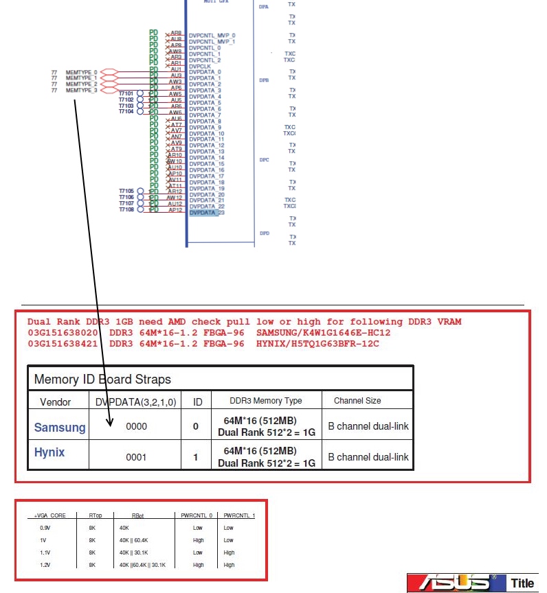

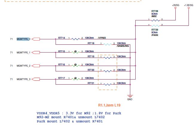

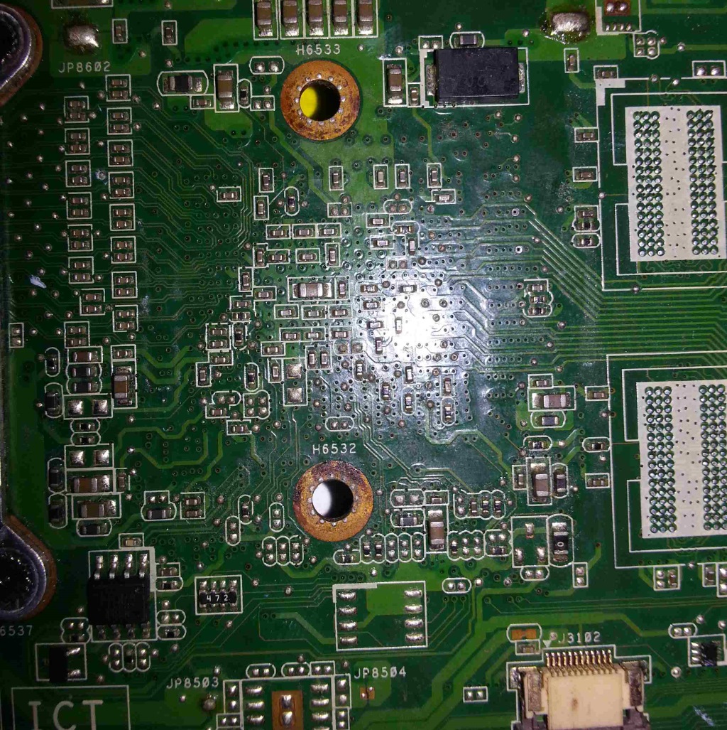

        I confirm that an vram issue, I remove all vram chip but i haven't the samsung part but only Hynix.
        I read on schematic: 0000 for samsung and 0001 for hynix but without serigraphy I have a problem to identify the pads. The vram I removed are samsung and I should see four pads not connected to ground ?
        I attach the mobo pics and a part of schematic named asus k72jr

          Re: ASUS K72JR artefact on video
          It is common practice to put "no connect" pads to ground. Don't worry. Just change the strap as per the schematic for your Hynix RAM and it will work fine.
            Ok, Now I see the right schematic vram strap.

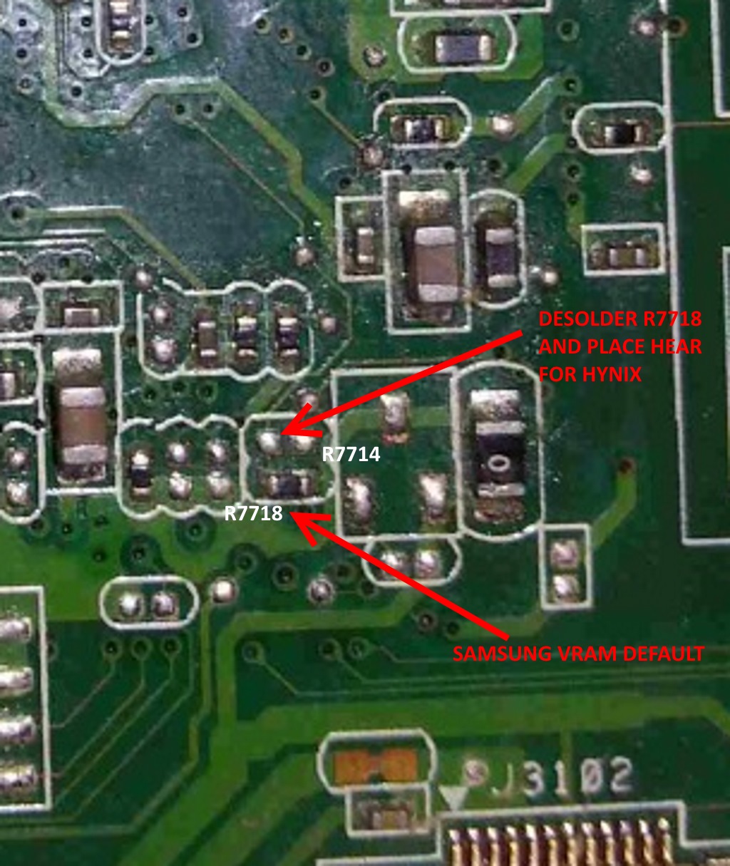

                  Finally I found it without powered the board, with a multimeter and after desolder the 0 hom res that is the switch from +3VSG (for m92) and +1.8SVG for PARK XT
                  I post the pic for future use
                    And the result? Does the laptop work well now?
                      Work fine
                        Good job. It's always a good feeling when such an involved and time-consuming repair is successful.
