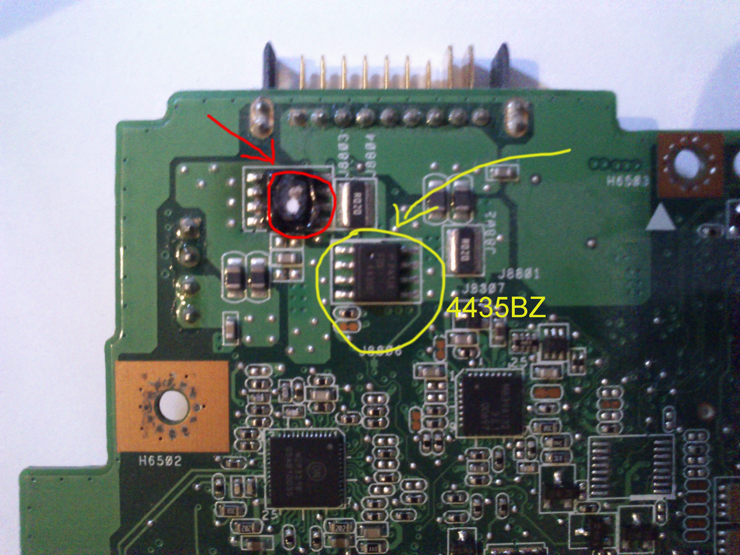

ASUS N61JQ won't start

    Re: ASUS N61JQ won't start
    dude u have board wiev and schematic. why dont u just tell us the component number instead of this picture?
      Originally posted by DeniS182
      I opened it with this program thanks. This pcb layout is same as in service manual who is attached in fourth post, but not same as my motherboard.. Can I find type of mosfet from this pcb layout in asus tsic? I opened some .dat file in excel, but for example PQ8903 is no type written here. Only values of resistors, capacitors, inductors...
      edit:
      I found this motherboard on ebay and I asked the seller what is written on these mosfets and he answered me - 4835gm a3779g and both are identical.
      i think i got right boardview, so u can continue to trouble shoot again
        ktm motocross: because board view is different from my model.
        meritosari: yes, it's right board view.
        I fixed it today, so thanks all for answers, especially thanks you meritosari. I soldered back all 4 inductors and when I pieced all together it's works fine.

          • ricomac
            • May 2014
            I have same trouble - dead mainboard but I don't have any componant burnt on the board. I will check all mosfet you changed. Is there fuses on this board? Where they are located?
                I see that you got it going. Have You used 4435bz mosfet to replace the melted one?
                  Thank You
                  I have an asus N61-jq that broke down. It has a burnt mosfet but I don´t know the reference to substitute. I think it's 4435zz. Can you help me?
