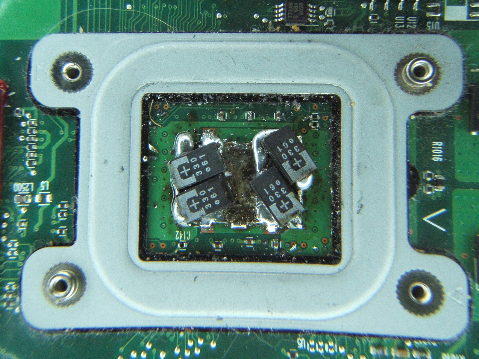

    i have a acer 6530g laptop (amd turion x2, ati 3650 vga) that when i press the power button will power on with black screen and 3 sec will shutdown and power up again.
    I have replace power adapter, mxm gpu card, memory but the problem not solved
    Any idea?

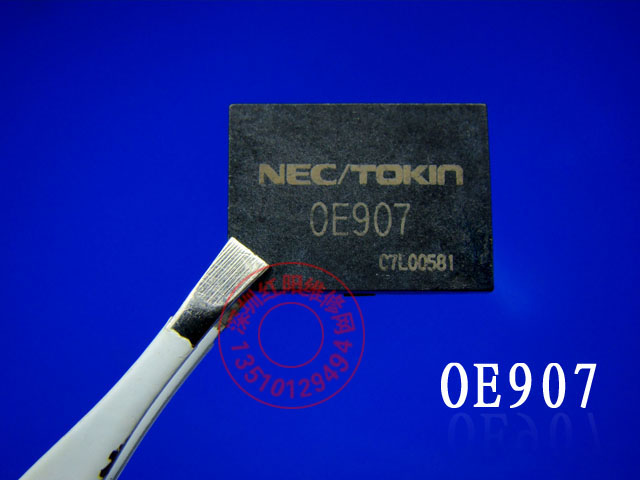

      Replace NEC TOKIN

        Oh. So those have NEC/TOKIN cap too? That's new to me. I've only seen it on Toshiba and some Samsung.

          Look at that fat ass tokin.
          the wierd part is that in acer they never die?!?!? whats the catch?

                really horrible soldering on that capacitors.
