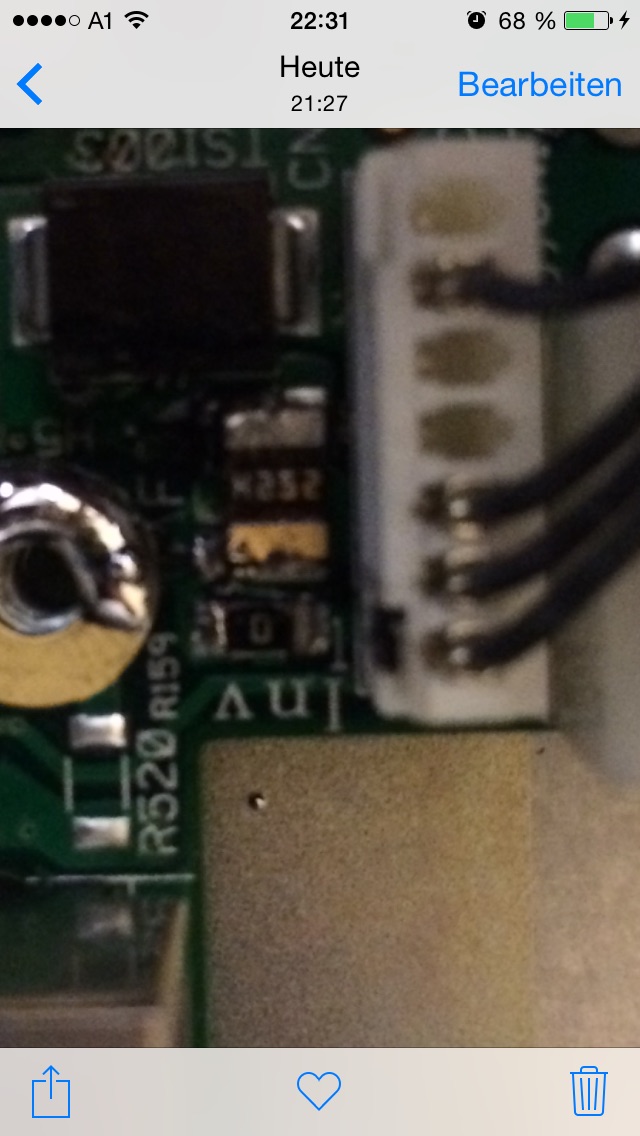

Can somebody tell me what this part is ?
  • Richi_el
    • Nov 2013
    • 95
    • Koln
    Can somebody tell me hat this part is ? And what are the Spec's
    of it?
    Its in the near of the inverter connector and its written 252 H on it ...
    It looks like some metall plates wich are stappled over.

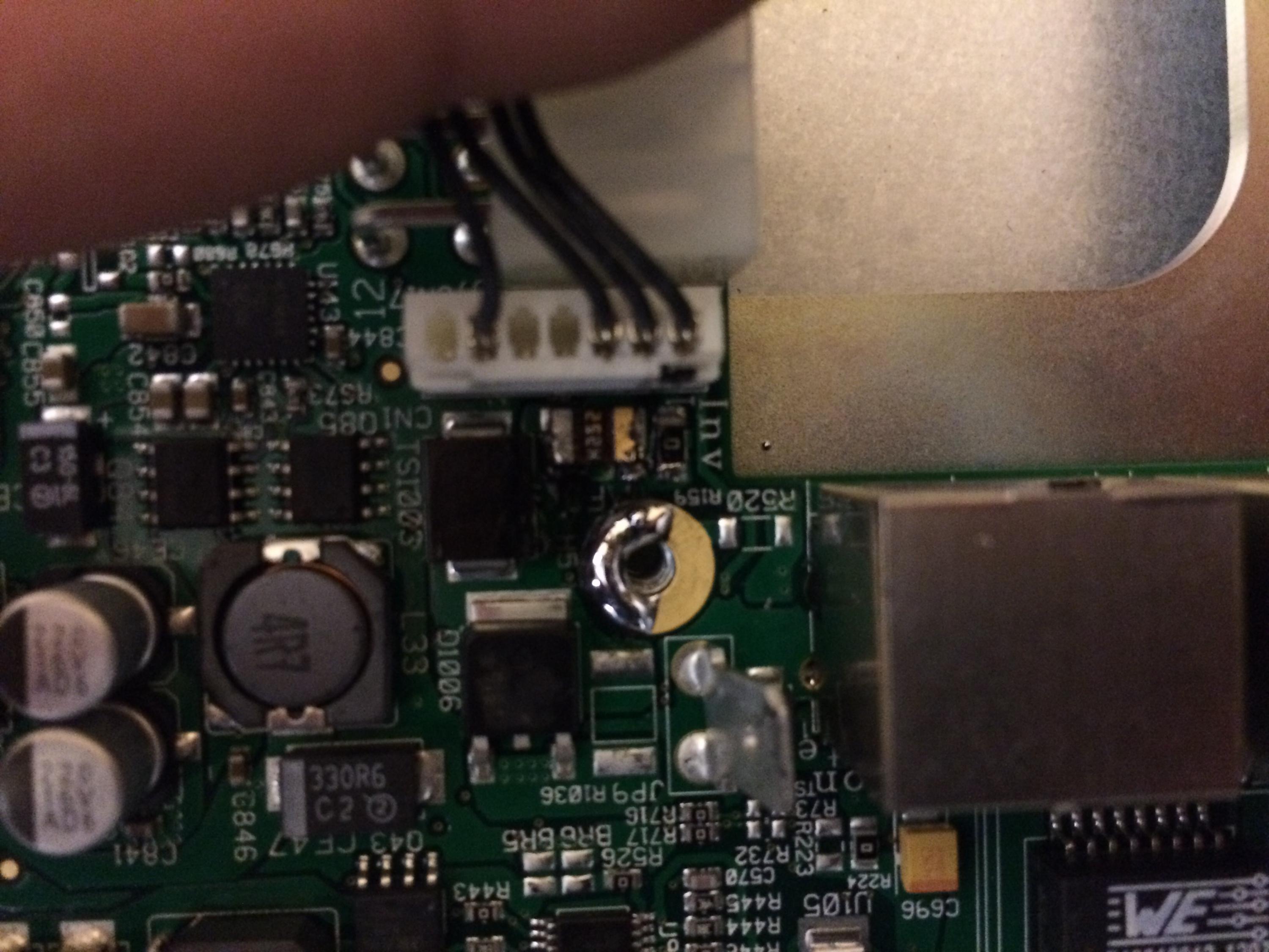

    Re: Can somebody tell me what this part is ?
    This part
      Bigger
        resettable fuse, how many amps, do not know. Depends on circuit...
          thanks for reply
          but am i right when i make a bridge over it it should work ?
          , but i does not ..
          the device make a short when i make the bridge..
          without the fuse the device work also fine , but we the backlight of LCD isnt starting..
            and pls can somebody explain me how can i find it out how many amp it has ?
              Resolve the short after the fuse and then start to think how many amps it should be. If it is 19V inverter power then 1 amp should be ok.
                make maths , calculate power needed by screen , more or less then use this math calculation a=p/v
                P =watts
                V=19 volts if its for the panel (attention if its led , the backlight is not 19volts)
                a= will be the amp in the circuit , like this you can calculate more or less the amp that will pass on the circuit , then you will know wich is the best fuse for that circuit part.
                  2.5 amps have a look at this page 2
                  https://cdn.badcaps-static.com/pdfs/...7263e74802.pdf
                    many thanks for support i will reply the result tommorow evning ...
                    on this fuse i have a incoming voltage of 13V .....
