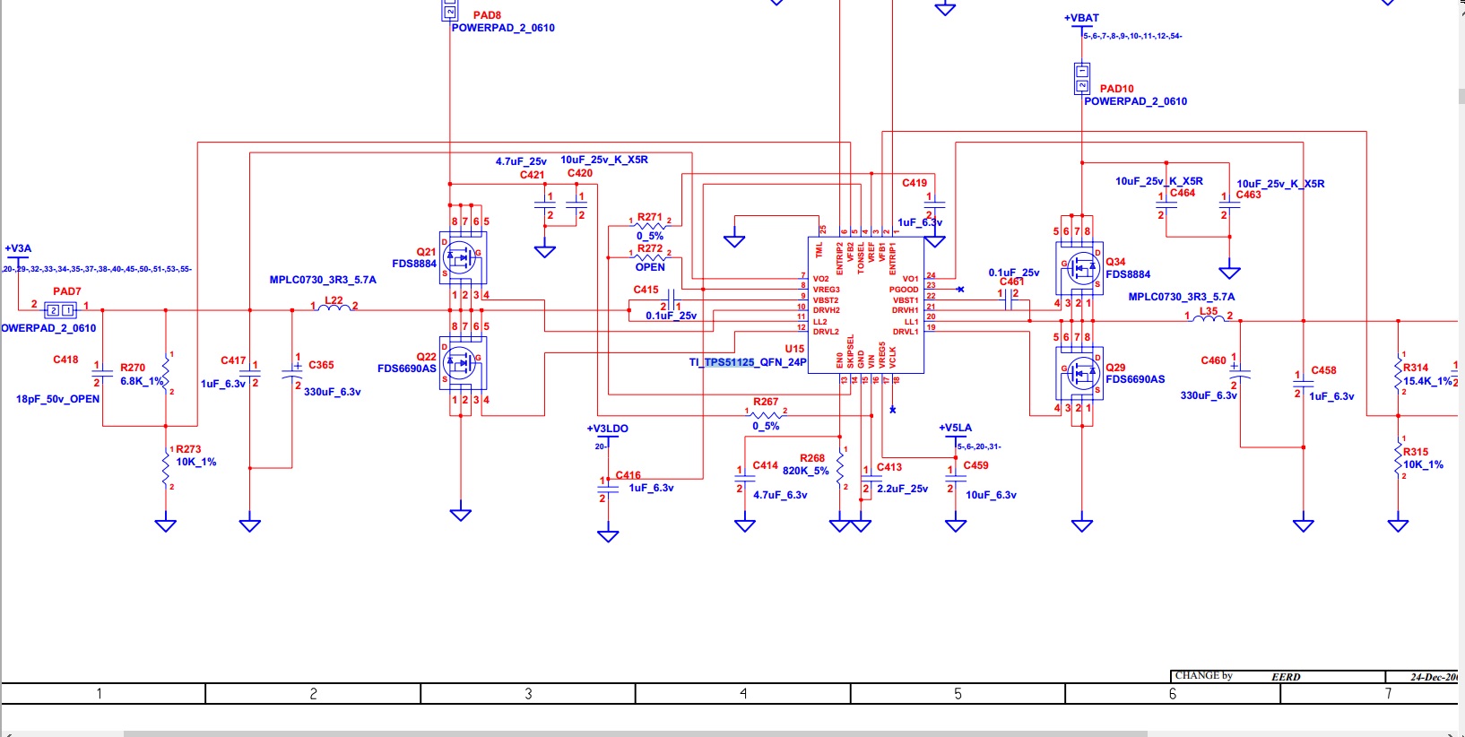

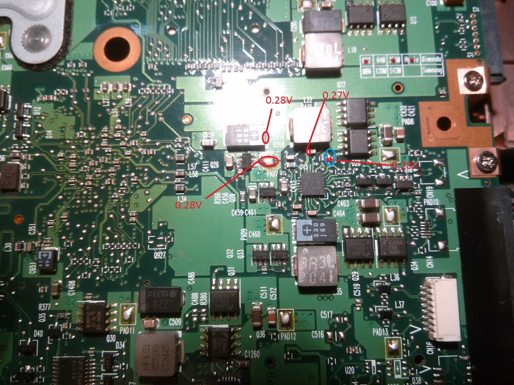

    Hello!
    I have a Toshiba A300D-18A with no led and no power.
    First check, I noticed that 3.3V were missing @ bios chip.
    Got the schematic for this board, and ended up near U15 where 3.3V go out of Vo2 of this IC. Mesured pin7 and 3.3V where there.
    @ PAD7, I only get 0.28V where 3.3V should present.
    V02 goes to L22, C365 ,C417,R270 and C418.
    Some components arent labeled, so I mesured continuity and found some points that should be these components (marked on photo with voltages).
    Mesured resistance between Pad7 to GND , 25,5 ohm.
    Mesured some of these components in Diode mode and one read open, the other 0.918 , and the one marked in blue 0.03
    How can I go from here without the labels and find out the culprit?
    Or is it that C in blue?
    Thanks for any help!

    Well, forget the readings I made on the first post, I was mesuring pin7 of U15 @ pin8
    Well, mesured the right pins of U15 and I dont get 3.3V neither 5V. (see 2nd picture of 1rst post)
    PIN7 (V02) - 0.27V
    PIN24 (VO1) - 0.22V
    PIN16 (VIN) - 19V
    The 19V are there, but the outputs aren't good.
    Should I swap U15 and see from there?
    Or should I check somethig more?
    Thanks in advance!

          I'm in a dilemma ... anyone with experience in these 5V and 3.3V getting out of IC U15 ?
          Should I get a new IC or troubleshoot somewhere else?
          Thanks for any inputs!
          • khaahk
            • Dec 2013
            • 812
            • Estonia
            Re: Toshiba A300D-18A Potomac 10A+/AG+ no Power
            https://cdn.badcaps-static.com/pdfs/...8da1a902a3.pdf
            Chip temp ok?
            Pin 8 - 3.3V ?
            Pin 17 - 5V ?
            Pin 13 - what V ?

              Well here are the readings :
              PIN8 - 3.36V
              PIN17 - 0,01 V (NOK)
              PIN 13 - 1.3V when I put the proble then goes down to 1V in a few secs
              I put my finger on it and 5 secs after I cant support the heat :/
              It's not good I suppose :/
