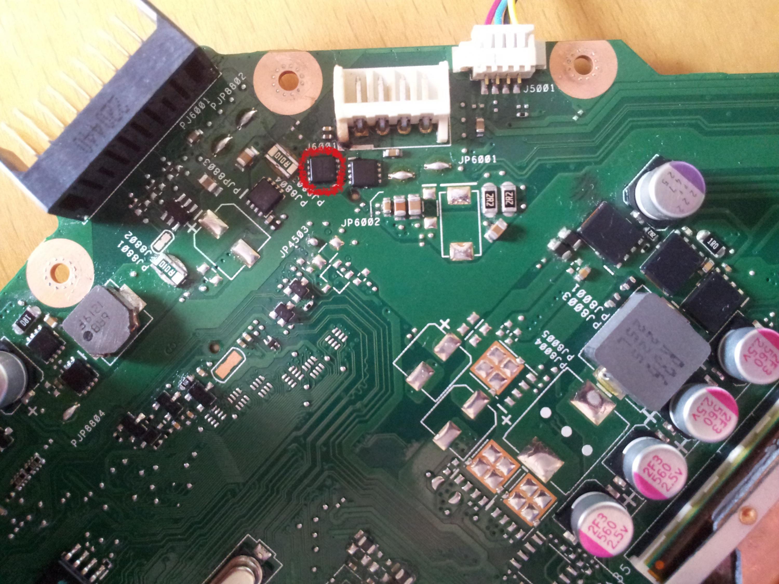

    Hello.
    Have this asus X55A and i have 19V before the first power mosfet and 0.89V after the mosfet.
    i cannot find schematic so any help would be needed
    Can this help? I hope the A and the S don't make that much difference.

        Originally posted by ktmmotocross View Post
        Hello.
        If you have 0,89 volt usually it is not a problem of BQ25. It's a problematic fet.

          I thought I had found a good one but that was posted earlier already.
            Re: asus x55A no power
            found something, you never know until you try.

                Problem is solved. You have bad "mosfet" on matherboar behind the DC input. Replace the bad mosfet and that's it. On the video is a burning mosfet, bad you have a bad mosfet.
                https://www.youtube.com/watch?v=rwIq6ZnHIR4

                  Asus X55A No power, No leds, Wont charge. Checked 5V and 3V (3V can be measured at Bios chip if you have no schematics) all voltage present. Checked CMOS battery: BOOM 0.3v. Replaced battery and laptop now works. Always check simple things first folks!

                      i replace mosfet A5 GNC 100M01 with M0930M
                      and laptop again working but automatic go to bios no booting windows restart i will try to format and install new windows or motherboard again have some problem on board one mosfet CDJ0961 near to processor give me short to ground i don't know it is this correct inductor and smd capcitors on multimeter give me shorted beep
